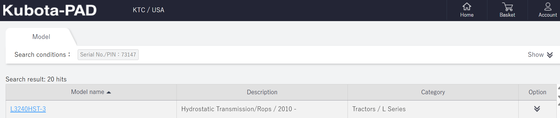

Need to know if it's a L3240 or a L3240-3 or a cabbed model of either.
