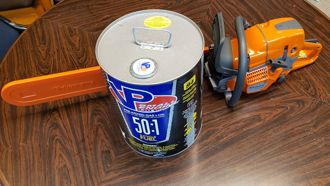

My poker buddies bought me a new stump saw and a bunch of goodies today. I have 2 other huskys but nothing that will handle a big bar so I needed a bigger saw. I got 3 bars with it and 2 chains for each. So I now have a small, med and large saw. If this can't handle the stump, I wouldn't want to grind it with the WG24 anyway.
That "thing" is a grinder in and of itself! hahahaha... Poor stumps don't stand a chance with you.

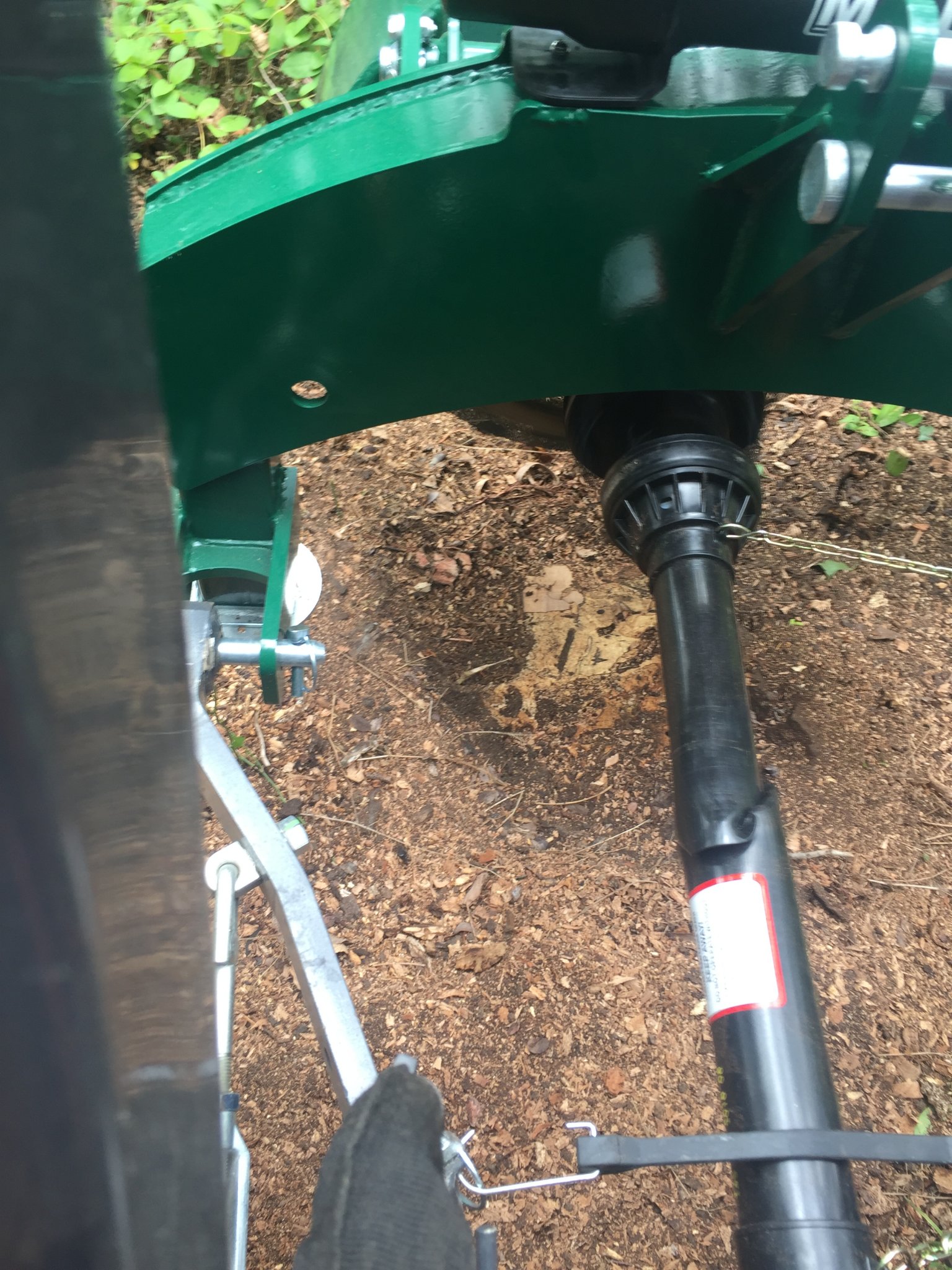

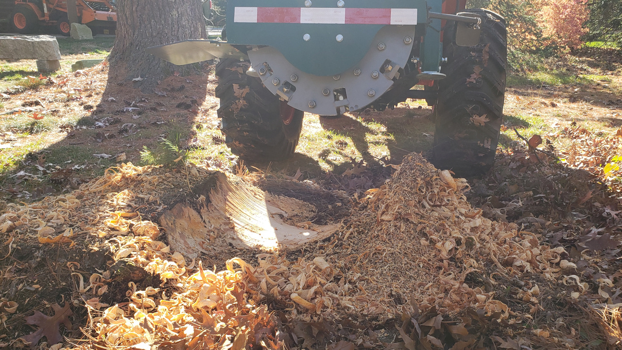

OK, I have 6 stumps under my belt now. 2 dead, 2 pine, 2 oak. 12-30" in size.
First impression is really impressive with one major flaw (I made a mod to address the flaw). With my B2650, I am not taking inches at a time and making it disappear, however I am able to take consistent passes removing nice big chips. There is a certain speed/feed that seems to make it happy.

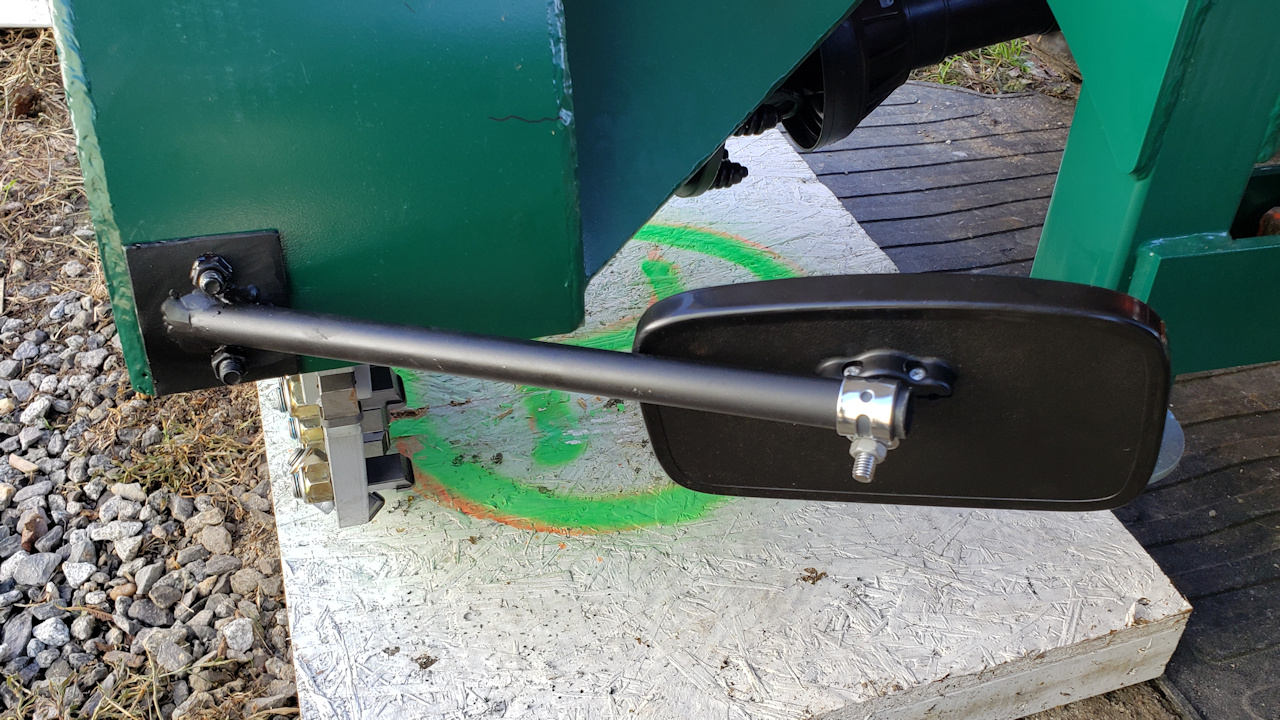

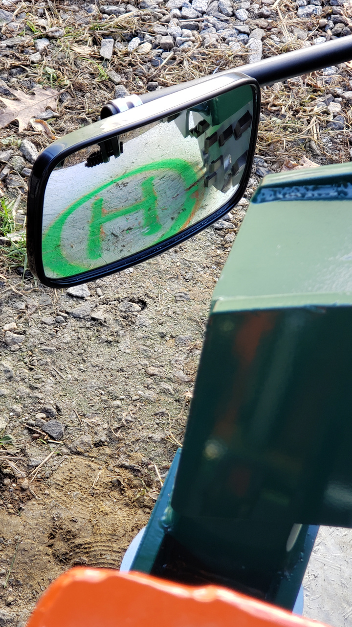

I was not able to see the wheel from any angle while sitting on the tractor so I added a spot mirror so I can see where the wheel engages the stump. By mounting it where I did, the angle to the front of the wheel is always right on. It is a huge improvement. Nothing seemed to hit it, and I was able to easily see it while grinding. I thought the vibration maight render it useless but I was wrong, it works great even under load.

I sure like your mirror mod, NHS! It looks both simple and effective!

Thanks. It works much better than I expected it to.
My mind went to video camera/monitor first being the time and age and all, but some old tech just can't be beat.
My wife helped me position it, that took most of the time. I would get it close, then start the next piece, try it, guess, build etc. Using the 4"h target as a "visual" stump helped a lot as well. Those two views are with it sitting in the same spot.
They really should ship it with one. Not being able to see where the death blade drops seems like a liability.
Judge - Why did you chop your buddies foot off.
Operator - I couldn't see it based on the manufacturers design.

I think if I took the QH off on the B2650, it would bring the unit even closer to the tractor making it even harder to see the wheel. The QH actually reduces the sight angle.

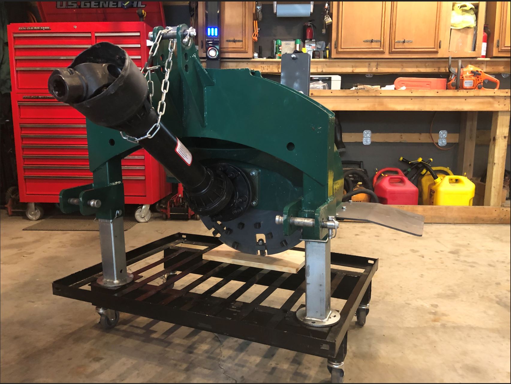

I ditched the "frame" but I use the metal pallet to store the grinder - I bolted casters on the 4 corners to (somewhat) easily move the grinder around in the shop. I set a piece of plywood across the pallet so the grinder doesn't rock.

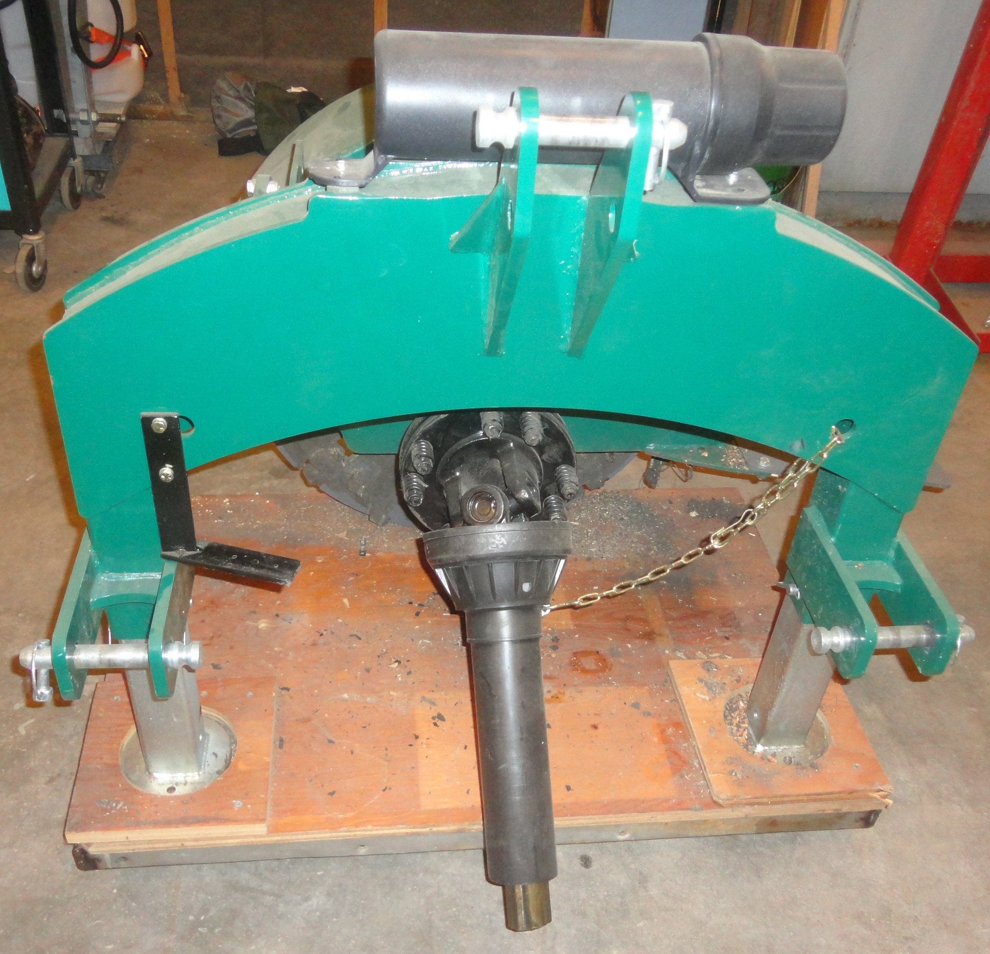

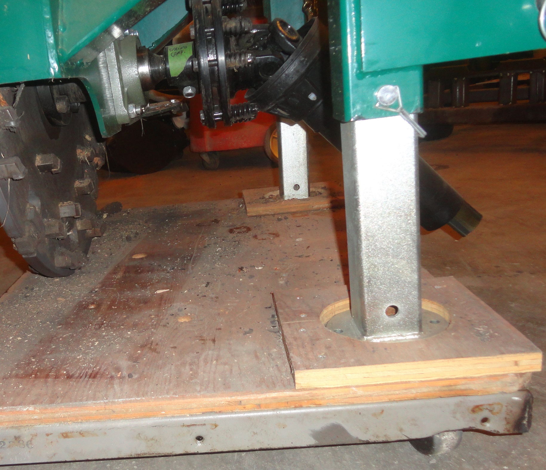

My mobile cart is similar to what TX Chris has. I added some leg restraining blocks on the top of the wood platform. they hold the grinder in place while you tug on it to roll the cart over to your tractor for hooking up.
