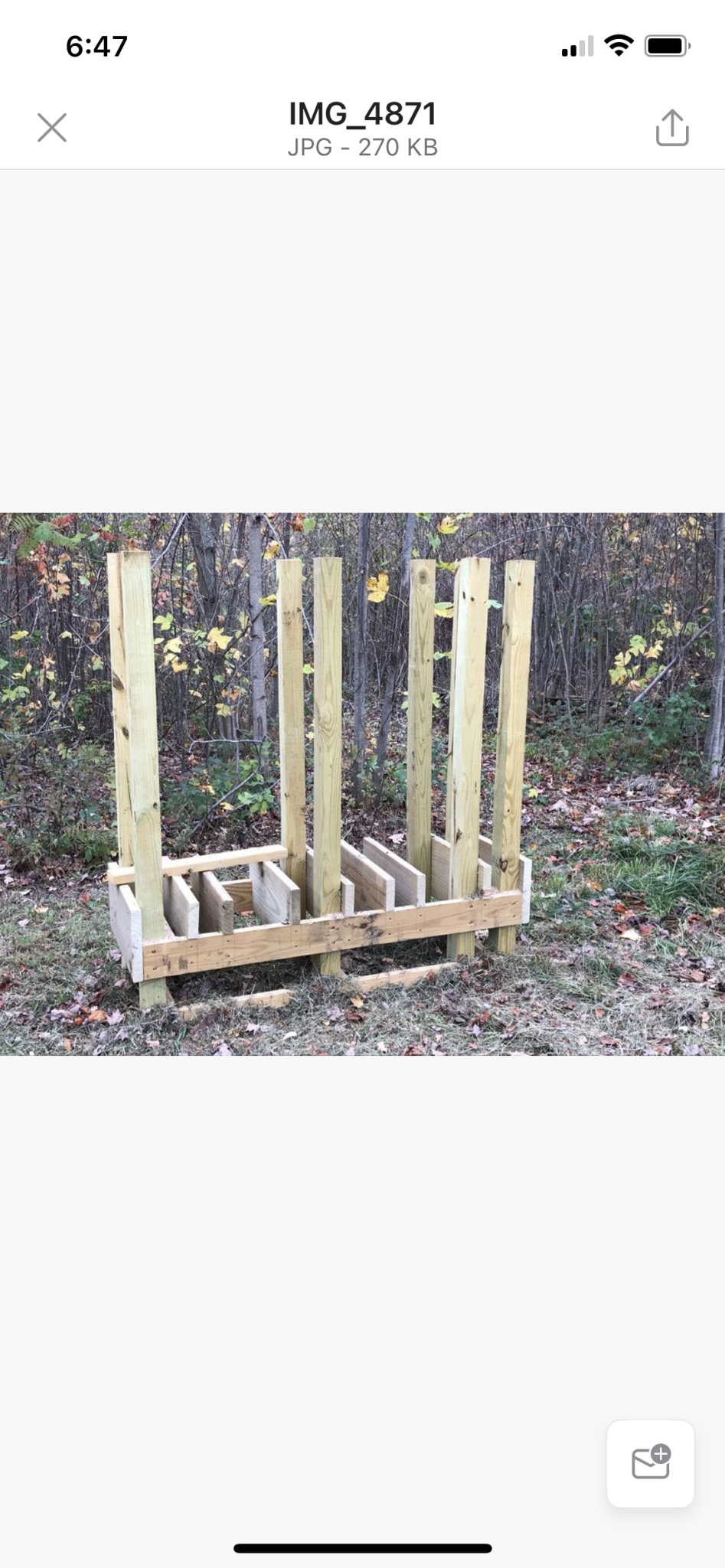

Good day. Having used one previously, this is just my opinion based on what works for me. If wanting for a novelty or historic purpose, I get it. If using to process firewood, there are much better options. Let’s assume not concerned with safety…Unless you have help, there is a limit to what an individual can lift up onto the bed…so already the log has most likely been cut down, or you need a way to lift a large log and index it to be really efficient…extra hands would help. If only doing small stuff, a decent chop (mitre) saw and stack of cheap blades from harbor freight. A Cordless saw is even more portable. Anyway the buzz saws are impressive but to make them process a lot need extra help to handle the stock IMO. And if cutting smaller stuff there are better options such as throw away mitre saw blades.
Assuming already have a chainsaw…if don’t want the mess in your shop with a chop saw, then A cutting rack…you can cut so much more so much quicker with a rack. (I am biased towards one of them and you can build to scale). I load this sucker up with smaller logs and then cut to the pre measured slots. Takes longer to pick up the pieces then to make the cuts and the cuts are made at a safe working height and not bending over while cutting.

I've seen those stands before and know someone that made one. One of the advantages of the buzz saw system (supposedly) is that it's a lot faster than a chain saw in terms of how quickly it gets through the wood.

I find the fact I can stand up to do it easier on the back. I made a spring loaded guide for my 16" cut off and drilled a hole in the table at 16" for trimming a slightly long piece to length.
