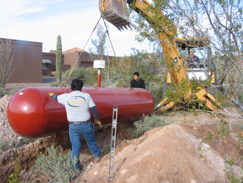

I had no gas at my new house so I put one of these in. Best decision ever and in a year, I have barely gotten the needle off FULL. Only run the cook top and dryer. Thought about bottle refills too...
Neighbors asked, "What was that thing on the trailer?" I told them, "It's my mini-sub for when the big flood comes!"
