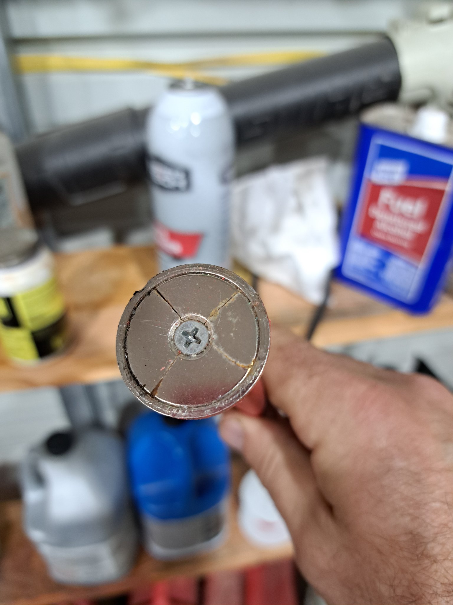

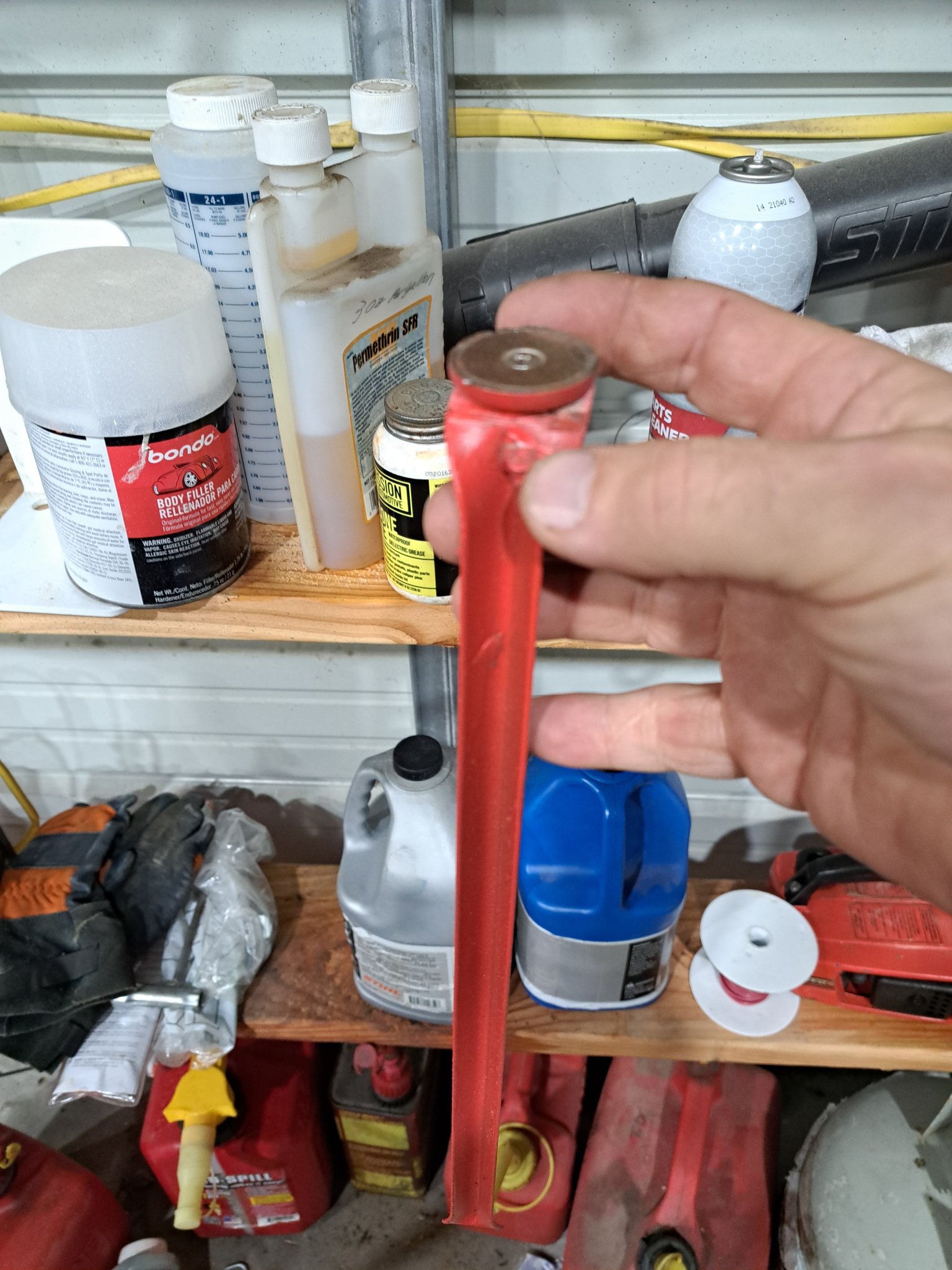

One nice thing about the magnets is they are cheap and easy to make for when you lose one.
I "lost" the original one I made on the lathe, So I just used a piece of old scrape angle and bent it up using a vice and hammer.
Then I found the original....LOL
Now they both sport a "visible red" paint job.
I was also suprised at how well they stick to the bar.

@Runs With Scissors I Bet you, like me, had to glue that screw into the dowel. Having the screw head on the brittle magnet is a flaw of those cheap magnets (I have the same), and the screw kept backing out on me.
The "dowel" is actually an aluminum rod from the scrap pile that I drilled and threaded on the lathe, so its secured with a screw and lock-tite.
Now that angle one is a real "back yard" forged "hillbilly tool" that took 5 minutes to make "on the fly" from parts found in my "extra screw bin", with a hammer, vice, and drill. ;)
I had a piece of a snow plow guide attached to a 3/8 bolt that screws into half of a coupling nut welded to the forward bar nut. I misplaced/lost it in the woods and made a new one with 3/8 fuel hose and that works good. I like my gauge on the right side. I had drilled and tapped a couple bars at first but found I wanted it more out of the way. The hose is flexable enough if i want to trim a branch etc without getting in the way. I might have to try the magnet idea, and painting for sure. I misplaced that first one and it hasn't shown up in several years of walking dogs in the woods.

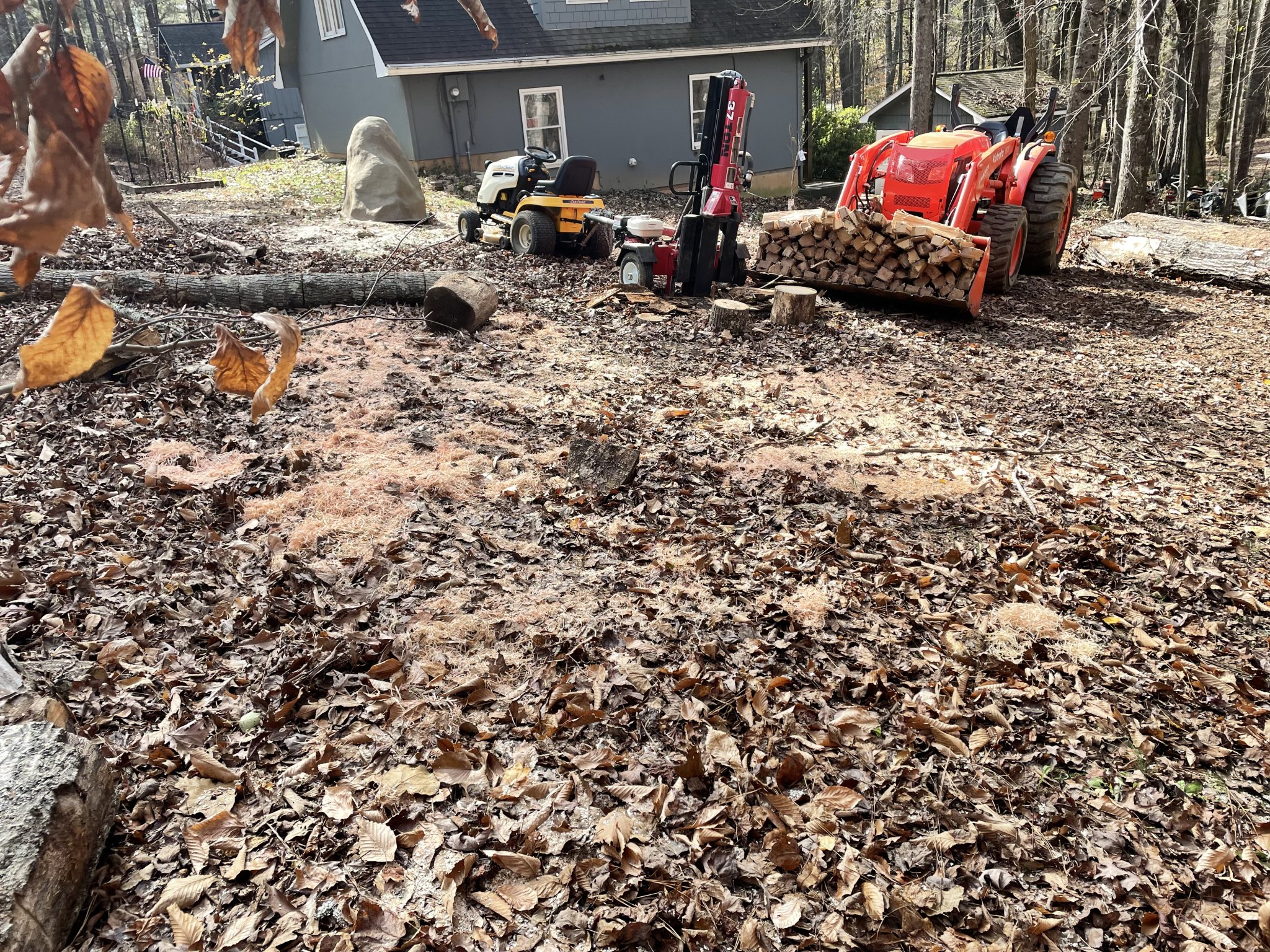

My super inefficient setup. Once splits are in the bucket I go straight across the driveway to my stack area and dump, restack after 4-5 buckets.
Previous owner added the plate and wedge extension. I added the wings.

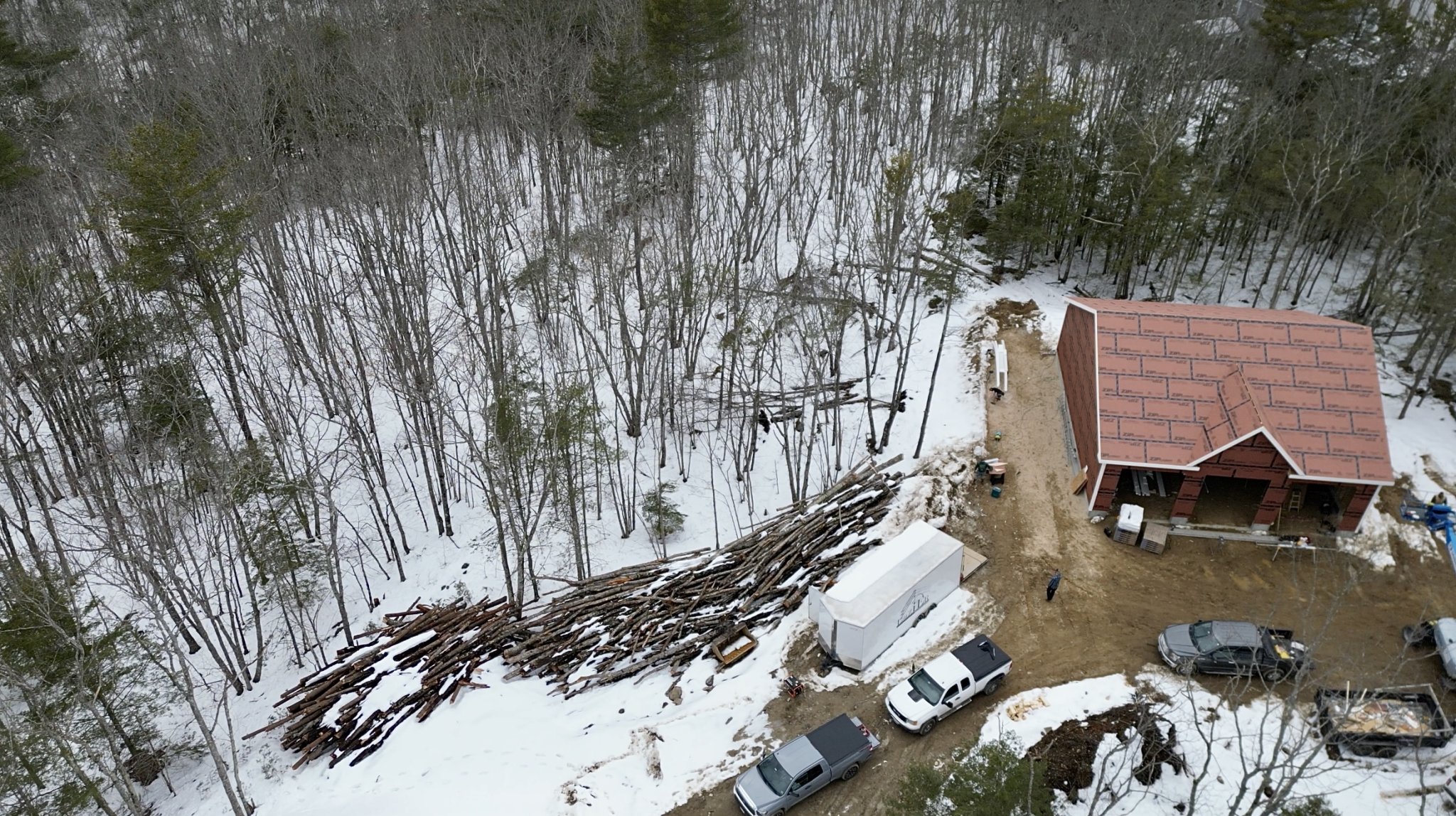

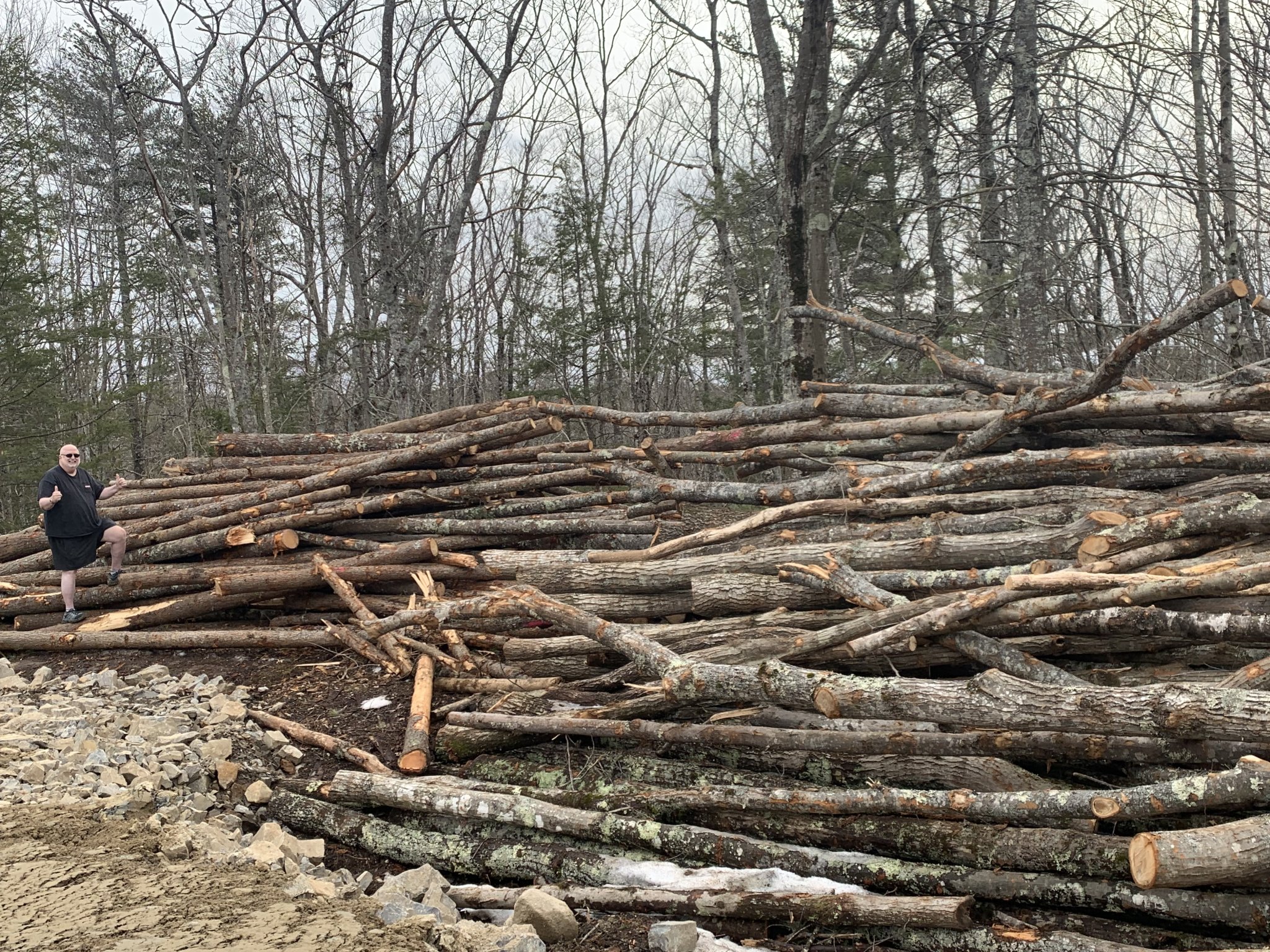

We bought 24 acres in Maine. An area was cleared for a new home and an out building garage. In the process i asked to keep the oak and hickory logs. The tree cutter estimated there was 20-25 cords of wood there.
Here I am standing on some of it. We bought a L3560 and I bought in addition to other attachments a grapple for the sole purpose, at least initially, to grab the logs, position at a good height for me to be able to cut it into lengths.
