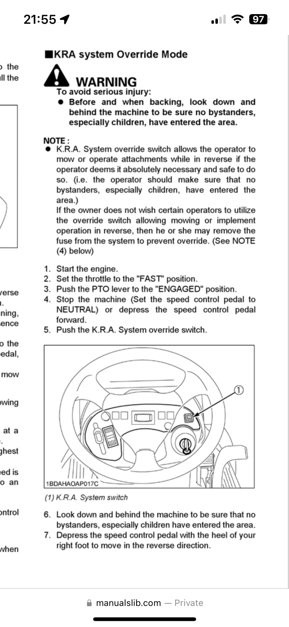

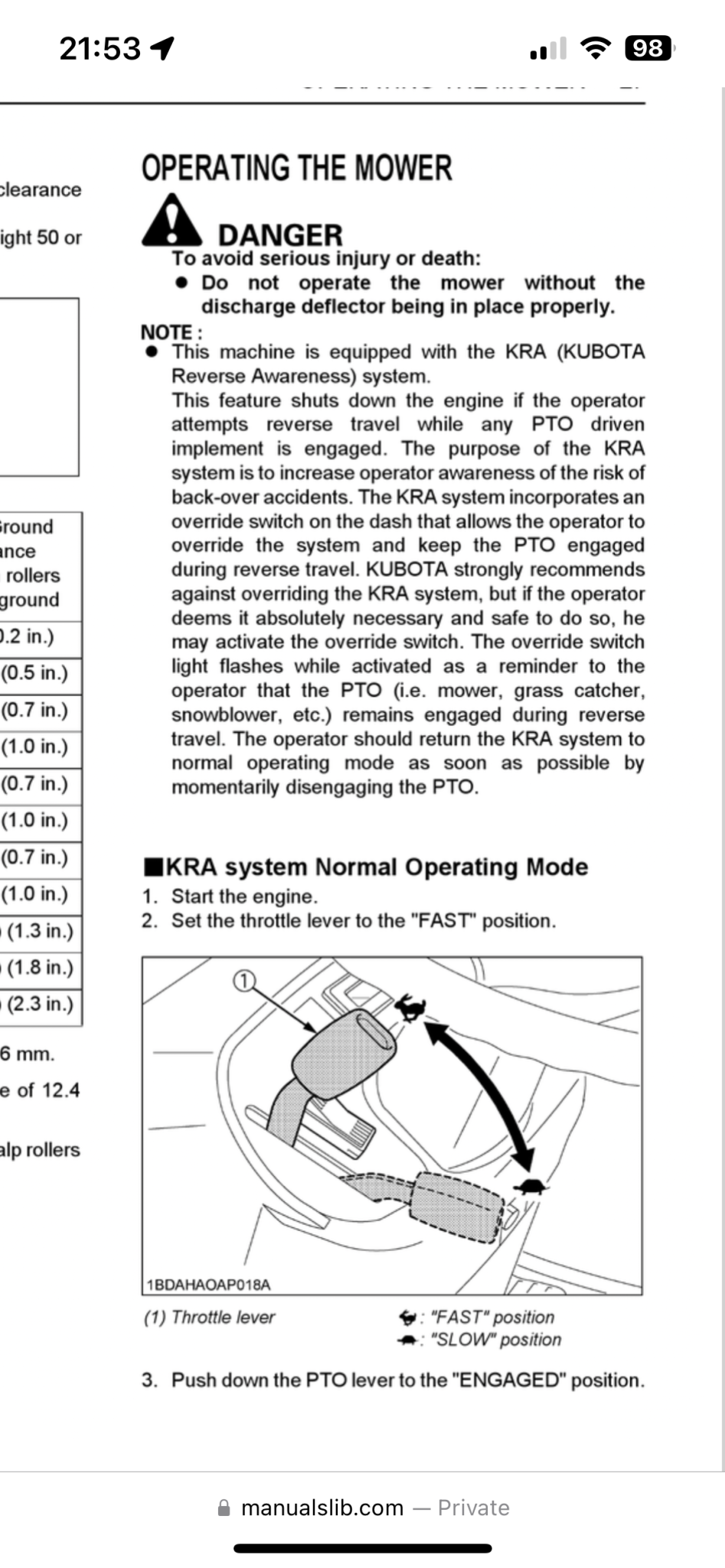

Just curious, are you supposed to hold the KRA button on the GR2120 to back up with the blades engaged?
The KRA for my T2290: after engaging the blades/PTO, you push the button and release. Then you can back up with the blades/PTO engaged for the rest of your mowing session until: 1) you push the KRA button again (momentarily pushing the KRA button toggles KRA off/on) or; 2) you disengage the blades/PTO.
If I had to push and hold the KRA button every time I backed up with blades engaged, I wouldn’t have bought the T2290. I’m well aware the GR2120 may be entirely different, but if you have to push and hold every time you back up with blades/PTO engaged that would be monstrously annoying unless you have virtually no obstacles to mow around.

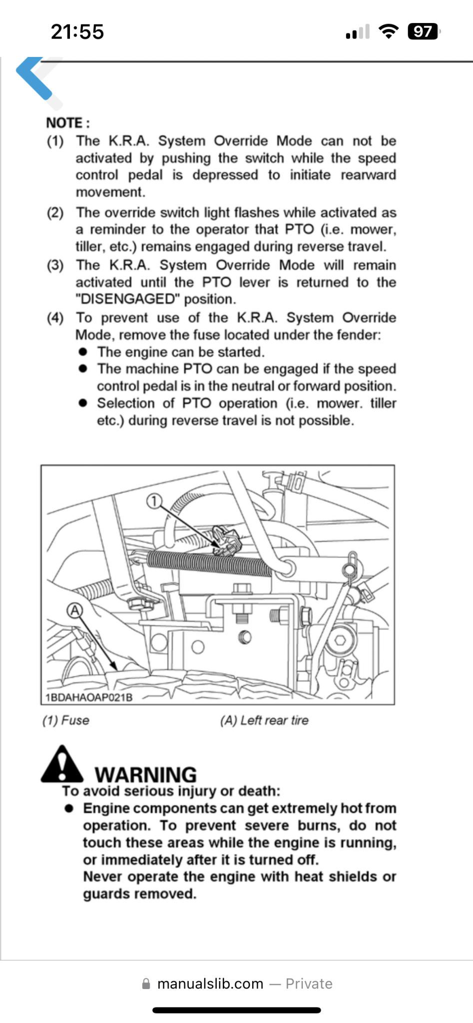

Edit: Got curious and looked up a GR2120 owner manual. Explanation of how to use KRA is below. Works same as my T2290. If you’re pressing and holding the KRA switch to back up, quite likely it isn’t working because you’re using it wrong. YMMV…
Edit (again): If it used to work and now it doesn’t, maybe check out the fuse referenced in bullet point 4 on the third page below. Something about you can disable the KRA over ride so it’s ALWAYS on (impossible to back up with PTO engaged) if you pull some fuse under the fender. Maybe that fuse blew?
