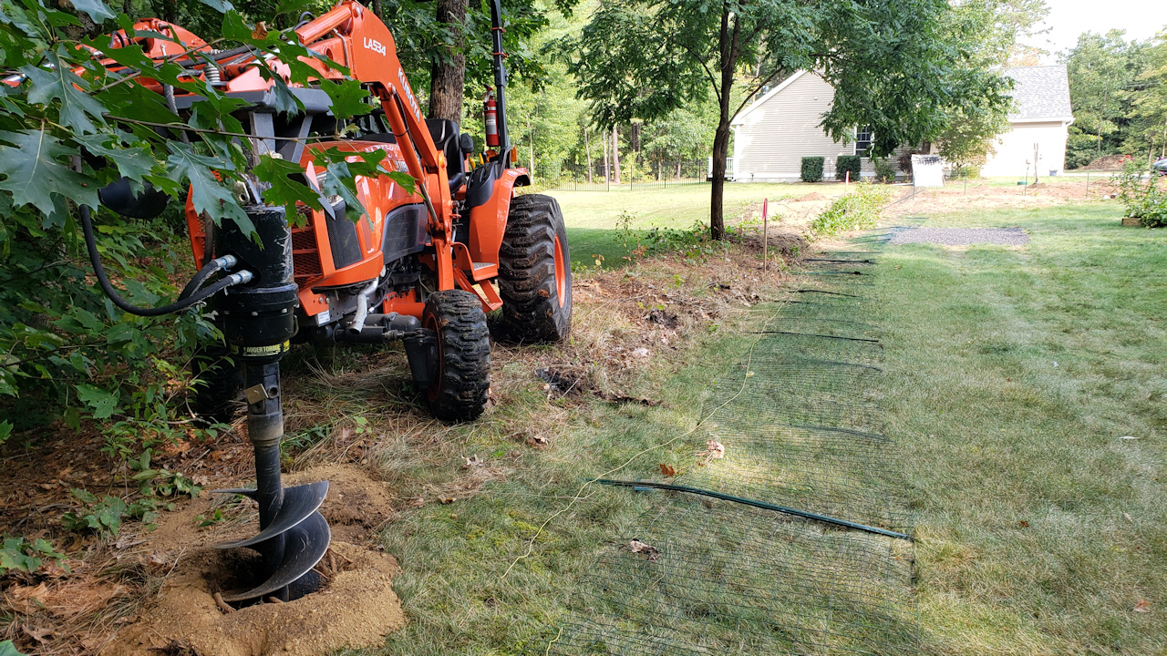

I have drilled at least a thousand holes (no exaggeration) with my hydraulic auger.
I never used to use my pto auger after using it a couple times. It was just always getting stuck, or not drilling the hole. More trouble than it was worth up here in this ground.
I was convinced that I needed an auger though. With down force, a ton of height (compared to the 3pt.) and REVERSE, I would never go back from the QA hydraulic.

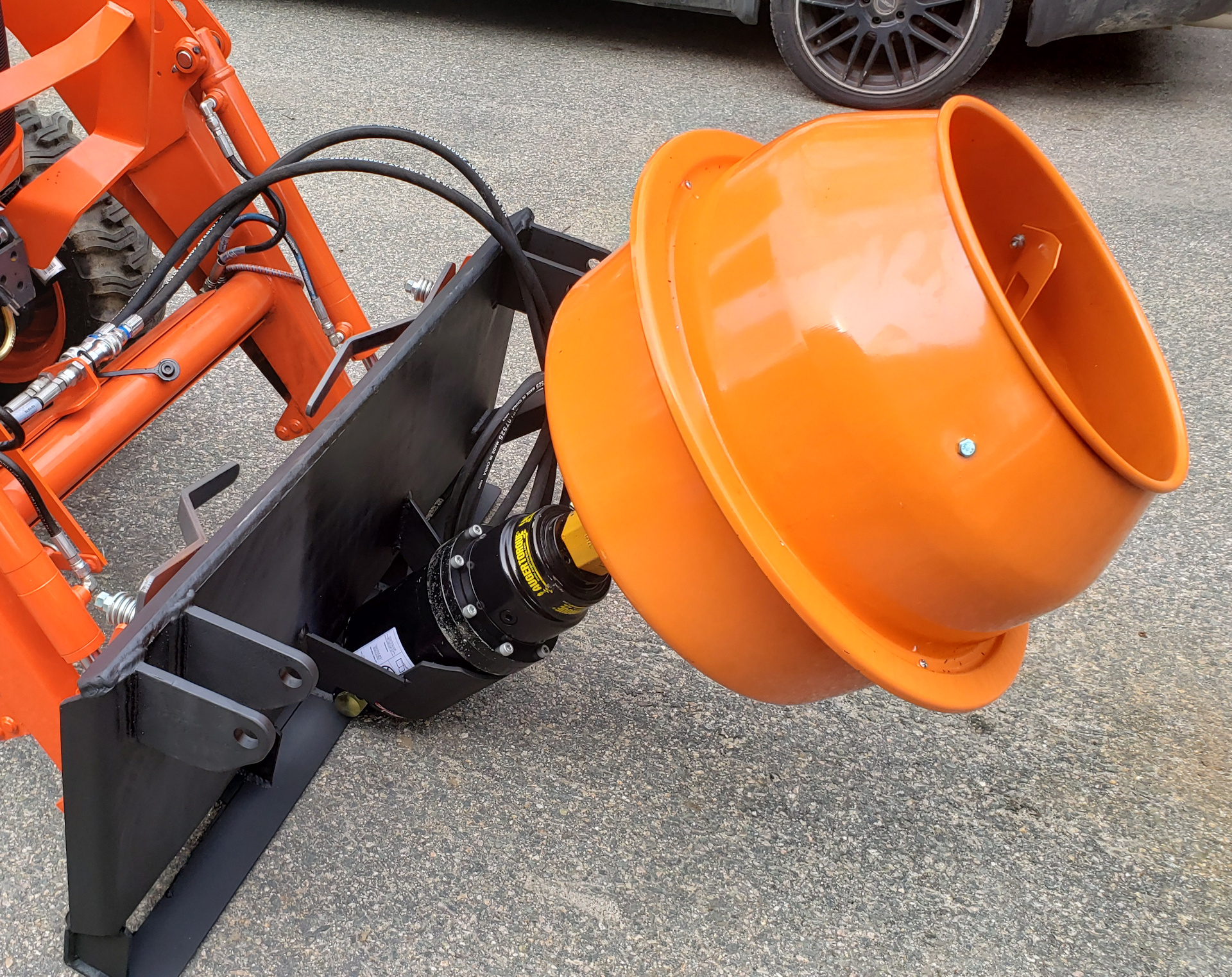

I ended up fabing my own. I wanted to be able to use it mixing/dumping cement as well.
