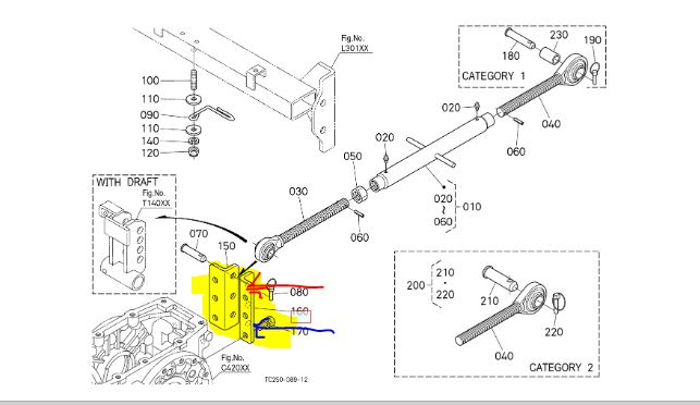

where the center beam Or top link of the post hole digger attaches to the tractor there multiple holes.
The lower the attachment the higher it will lift (red arrow low lift Blue arrow higher lift.

My top link is in the bottom hole, but I will check out all options before I chop saw the shaft of the auger. I like how long it is but I don't like how it catches on every high spot when I'm moving. I do keep a chain around the auger and main frame to keep it tilted but that's not enough,it still catches on high spots.
