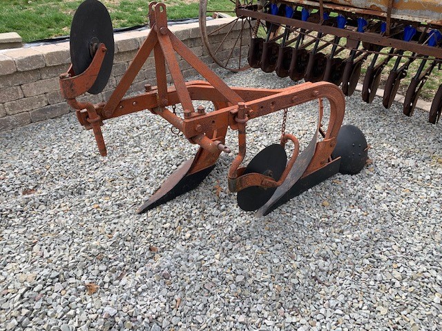

Been looking for the past few months, and made a few posts along the way. Well used (3500 hours) and needs a little tlc, but I think made a good deal with a 2 bottom plow. Anyway, its a hard starter and I just got done checking the resistance on the GP's. The results from back to front (grill) were as follows: 1.6, 1.5, 1.6, 4.7, 1.5, 1.6. From what I've read, they should read <1? so I'm planning on replacing and also changing all the fluids & filters. The front GP looks to be an enjoyable task to get to and remove. I've read that the intake needs to be removed, which seems also that the feed lines to the injectors & injection pump will need removed also? Any input on this would be great.
The tractor itself runs strong, holds all gears and has a weathered finish. Once I get the maintenance done and it running/starting reliably, I'll be using it for food plots on my hunting property (probably less than 100 hours a year).

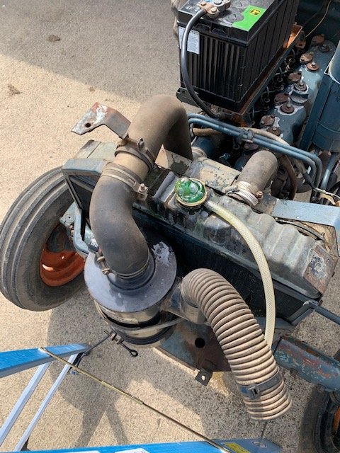

Here are a few pics in its current state. I fabbed a new parking brake connector and it's working well. Waiting on maintenance parts for fluid & filter changes. I've also been reading about the compression release on the 2600 engine. I mounted a choke cable to it that I can work from the seat. Hopefully that, a fully charged battery, new air & fuel filter, and glow plugs will help in consistent starting. Have to find a hydraulic shop to look into rebuilding the power steering cylinder. Was hoping to get my Messick's order this week, but looks like some of the parts are 5-10 days out for shipping. I believe I have a Ferguson 14-2 plow. It's in pretty good shape and almost all there, missing one jointer arm and both jointers, but everything is free.

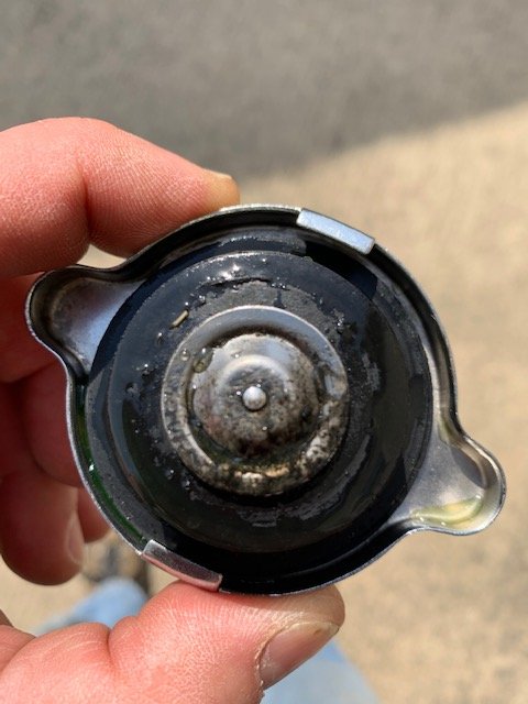

Need a little help. Initially thought that the radiator puking thru the overflow was the cap. Got a new cap and same situation. Pulled the cap and started and it seems that there is exhaust coming thru the radiator neck. I pulled some fluid and it is green and tests well for anti-freeze. Can't really tell if there is oil in it. I would expect it would be pretty dark? Additional info, the lower heater hose doesn't seem to be getting hot and when it was puking with the old cap, the engine wasn't warm (or the coolant) and it was as if it was almost pumping out of the overflow, ie: not a steady stream like I would expect if it was steam. I do have some steam/smoke coming from the overflow tube also after the engine is warm. No visible leaks on the block or head.
Also, no white smoke from exhaust and oil looks good on the dipstick.

Sounds like it could be a blown head gasket or a cracked head. Here is a recent thread that may be helpful.

With the rad full does it immediately start bubbling? Sure sounds like a head gasket. Hopefully not a crack.

I'll have to refill and check. Can't do it til Monday though. Looks like I'll be pulling the head. Doesn't seem that there's a simple fix. On the plus side, changing all the glow plugs just got a bit easier.

I just got in from the garage and did some testing. I filled the radiator to the bottom of the neck. I started the tractor and let it warm up. As it was warming, there was not a lot of movement. As it got warmer you can see wisps of smoke (exhaust?) coming from the neck. Once it got up to temp, it bubbled and puked (pics) and then settled down and was calm. I put the cap back on and within a few minutes it was puking thru the overflow. Puking when the thermostat opens and calm when it closes back down? Because as I backed it in the garage and lowered the throttle, it stopped puking again. I have a pic of a little coolant that I drained. I would have thought the oil & coolant would have separated, but it doesn't seem the case. Also a pic of the cap, exhaust? Have I just shown that I need to replace my head gasket? I have other pics and few videos just have to get them uploaded. Thanks for all the help! IMG_4107.jpg IMG_4108[1474].jpg IMG_4113[1479].jpg IMG_4115[1481].jpg

Quick update. Pulled the head. Gasket didn’t have any noticeable failures. Some of the head bolts didn’t seem as tight during removal. The block and head both look on good condition. Called machine shop and head is being dropped off today for clean, magnaflux, testing and decking if necessary.
