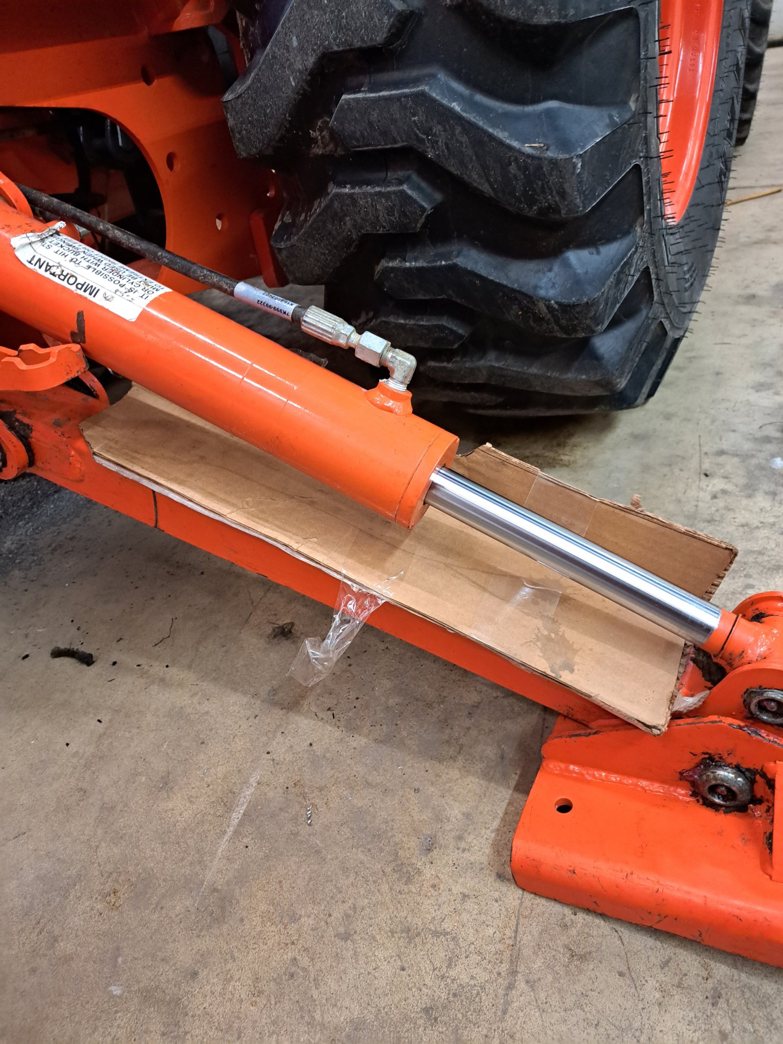

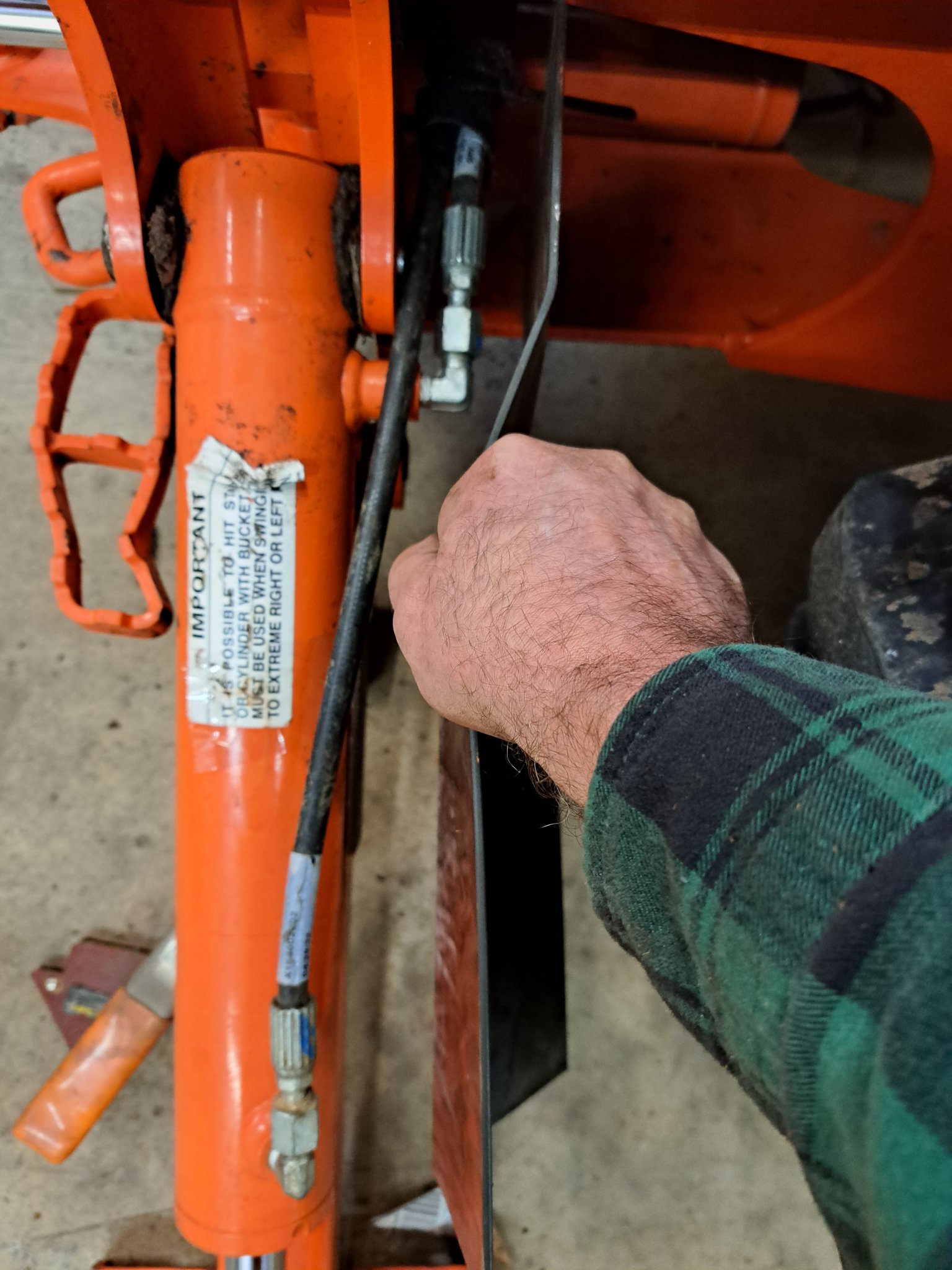

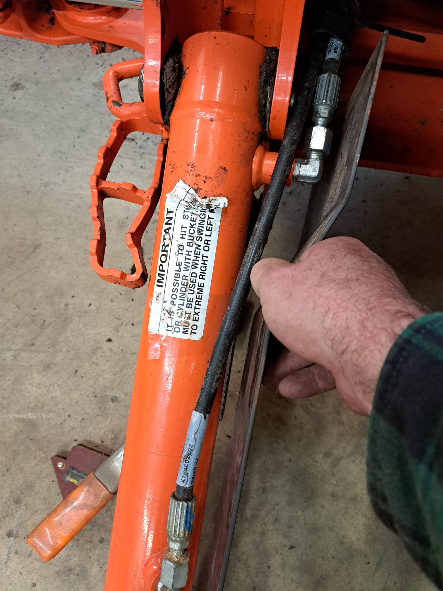

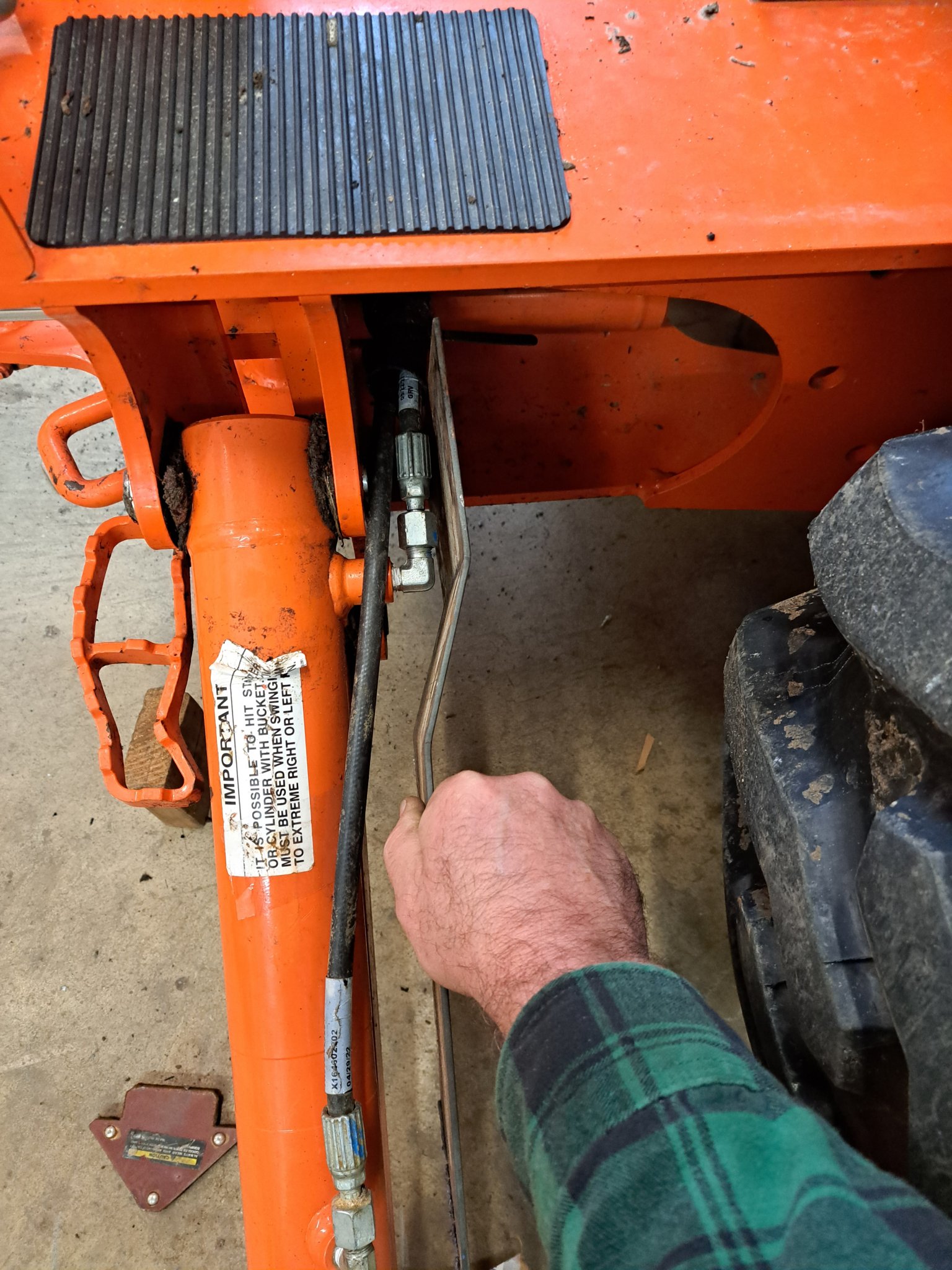

So there I am, it's zero dark thirty and I am in the garage just staring at my BH77 outriggers.
I can't sleep, and I have been going over the plans in my head for what feels like an eternity.
I want, in the worst way, to make guards to protect the hoses, but I also want to incorporate a bigger/more convenient step.
I have probably 3 or 4 "basic ideas" running through my head, but I can't seem to get a "clear picture" of the result.
I probably stared at it for 2-3 hours, running different scenario's on how to bolt it on, what it will look like, what parts need to move......what parts don't need to move..........etc.
Since I can't get a good picture of the best way to attach it, I decided to start by making the actual guard, then retrofitting it to the mounting system....Kind of a "reverse engineering" concept.
Smoke was probably pouring out of my ears........... screw it.........I gotta try something.
I hate indecision, so F'it, I gotta stop analyzing this thing to death and do something......
There is only really 2 "must haves" in this project.
1. Must bolt on. No welding
2. Must be "simple" ( i.e. one piece design ideally)
I feel like a boat adrift at sea......
This should be easy man! Why am I so stumped??????

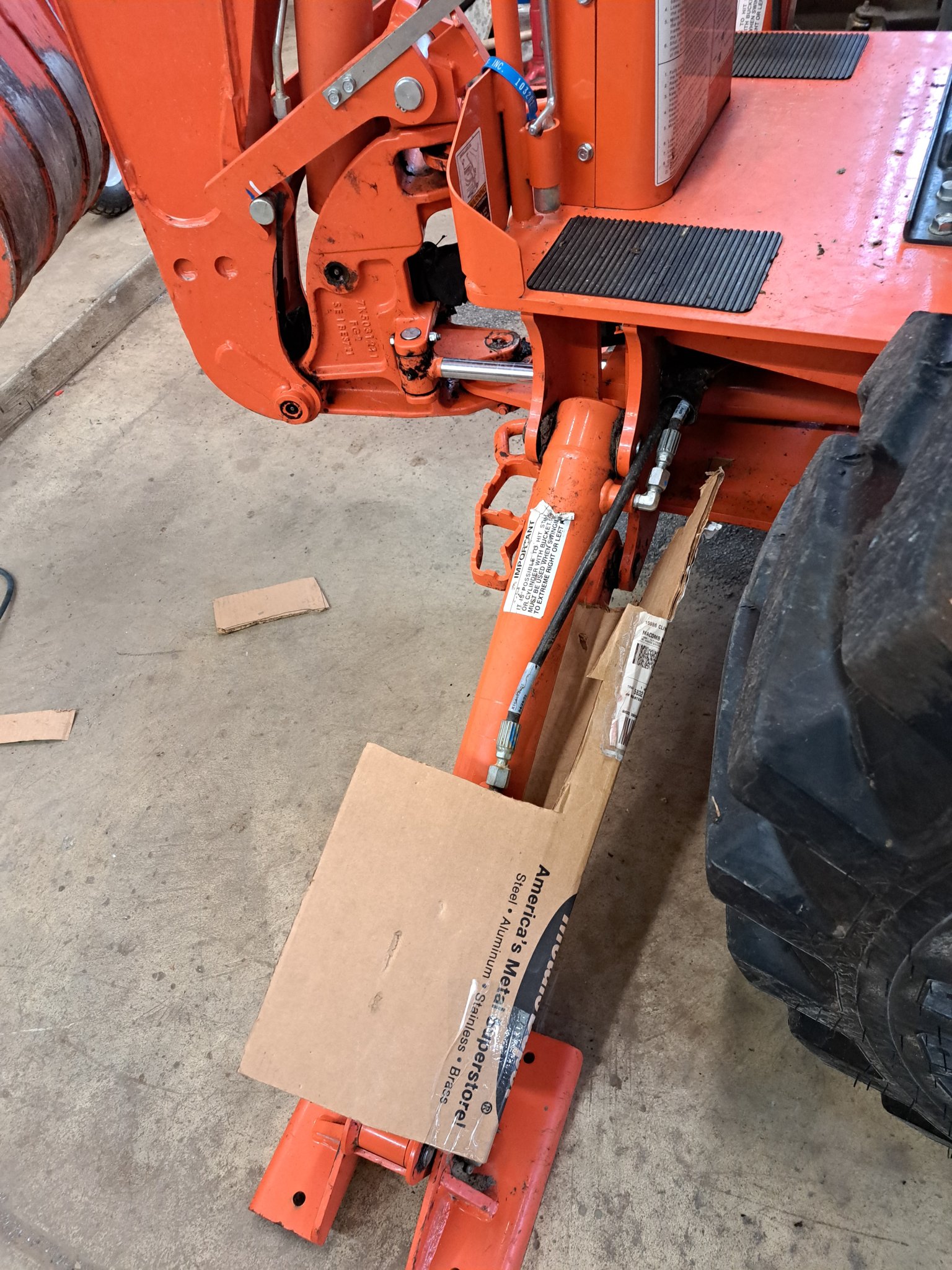

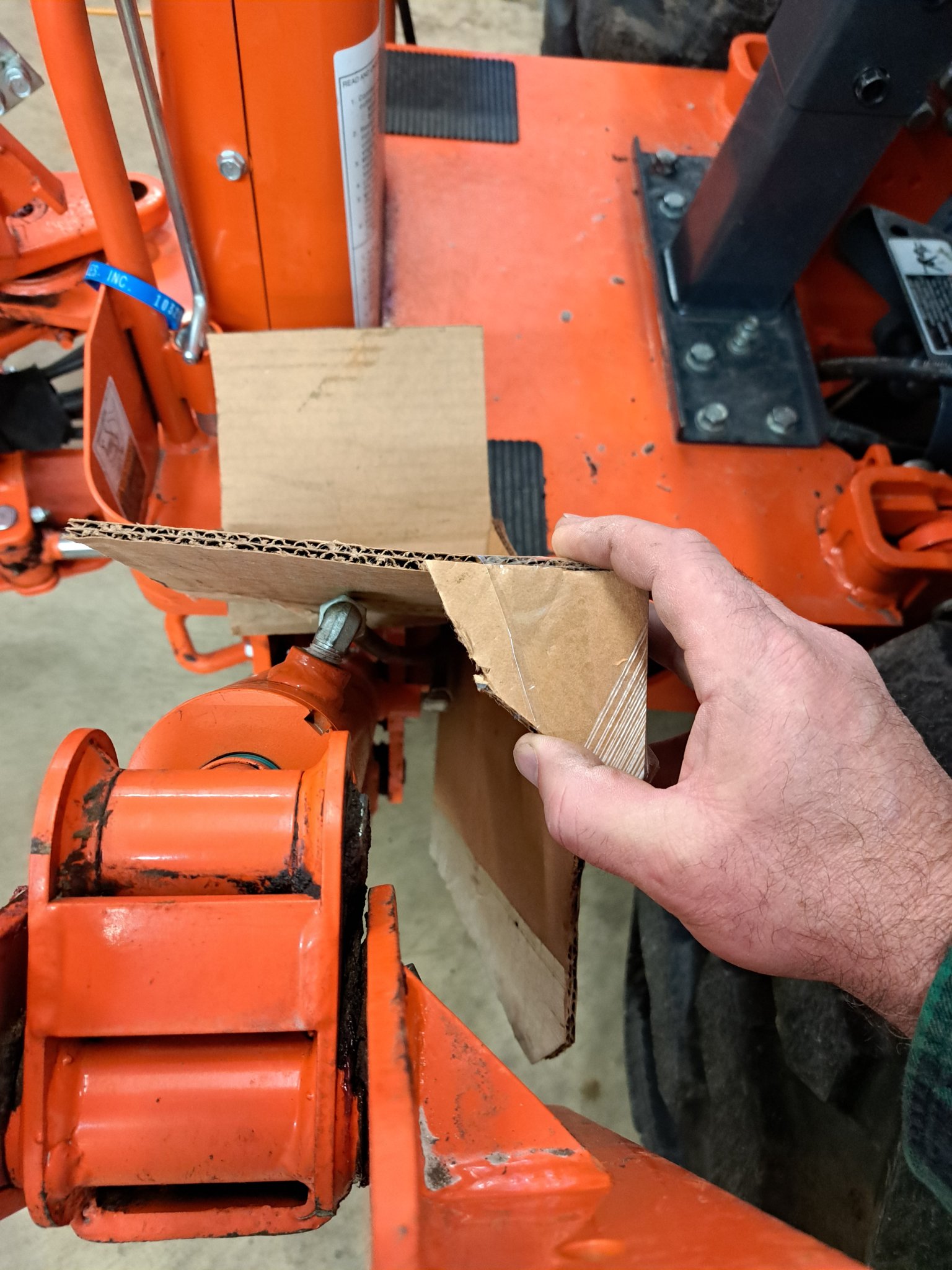

I decide to make a "cardboard mock up" to clear the cob webs,
Break out the Amazon boxes and packaging tape..
I get the "basic idea" and kind of "muttle along".
You can see that it will protect both hoses in the "up" position, so that's good
1,886
2,003

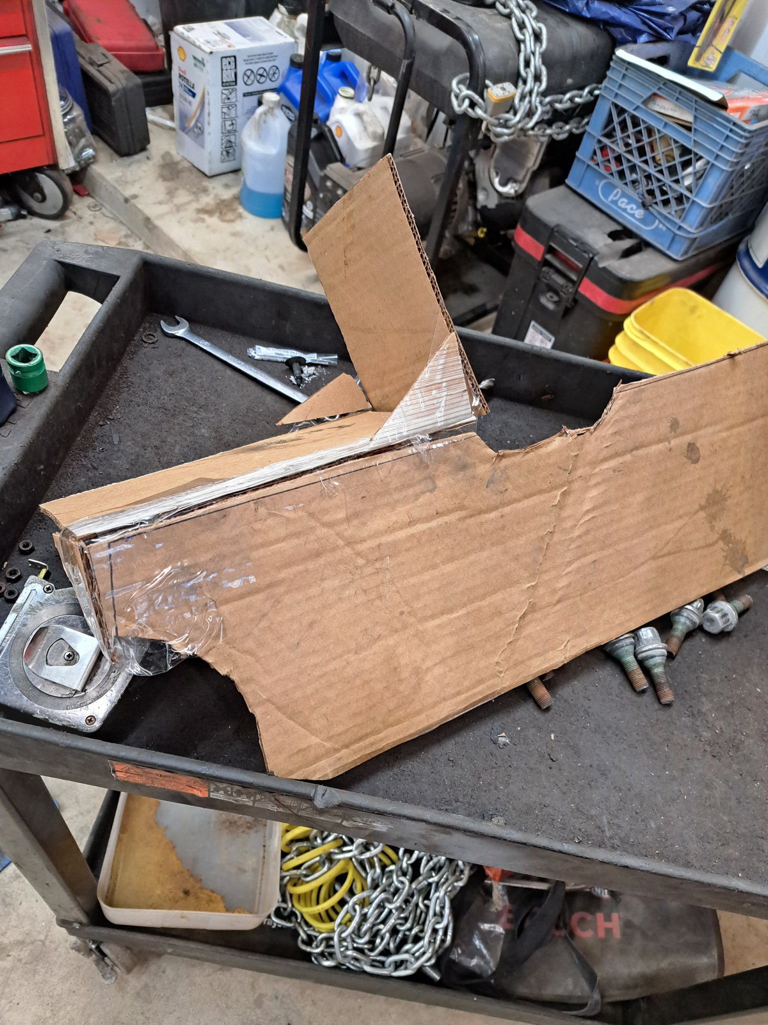

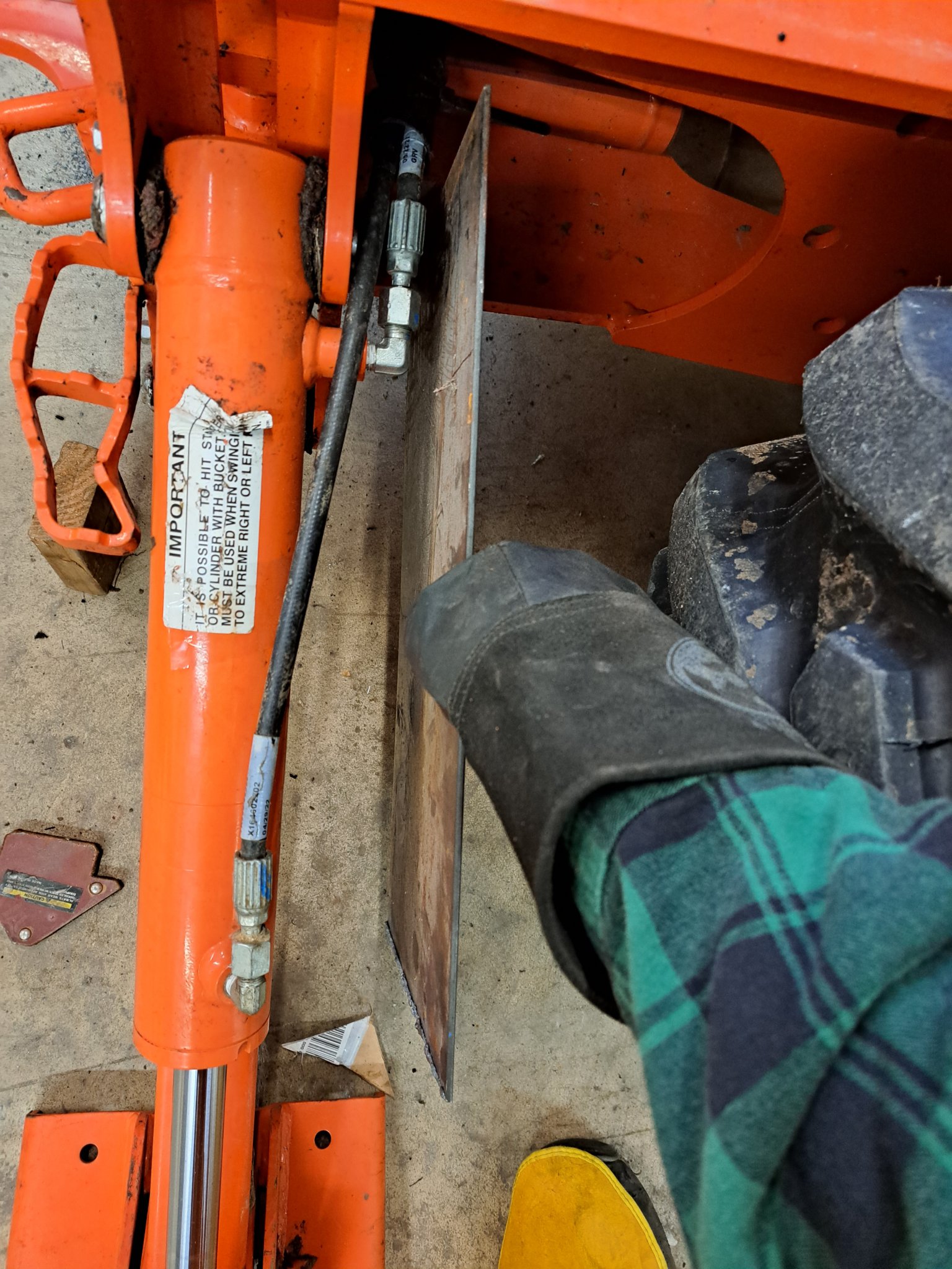

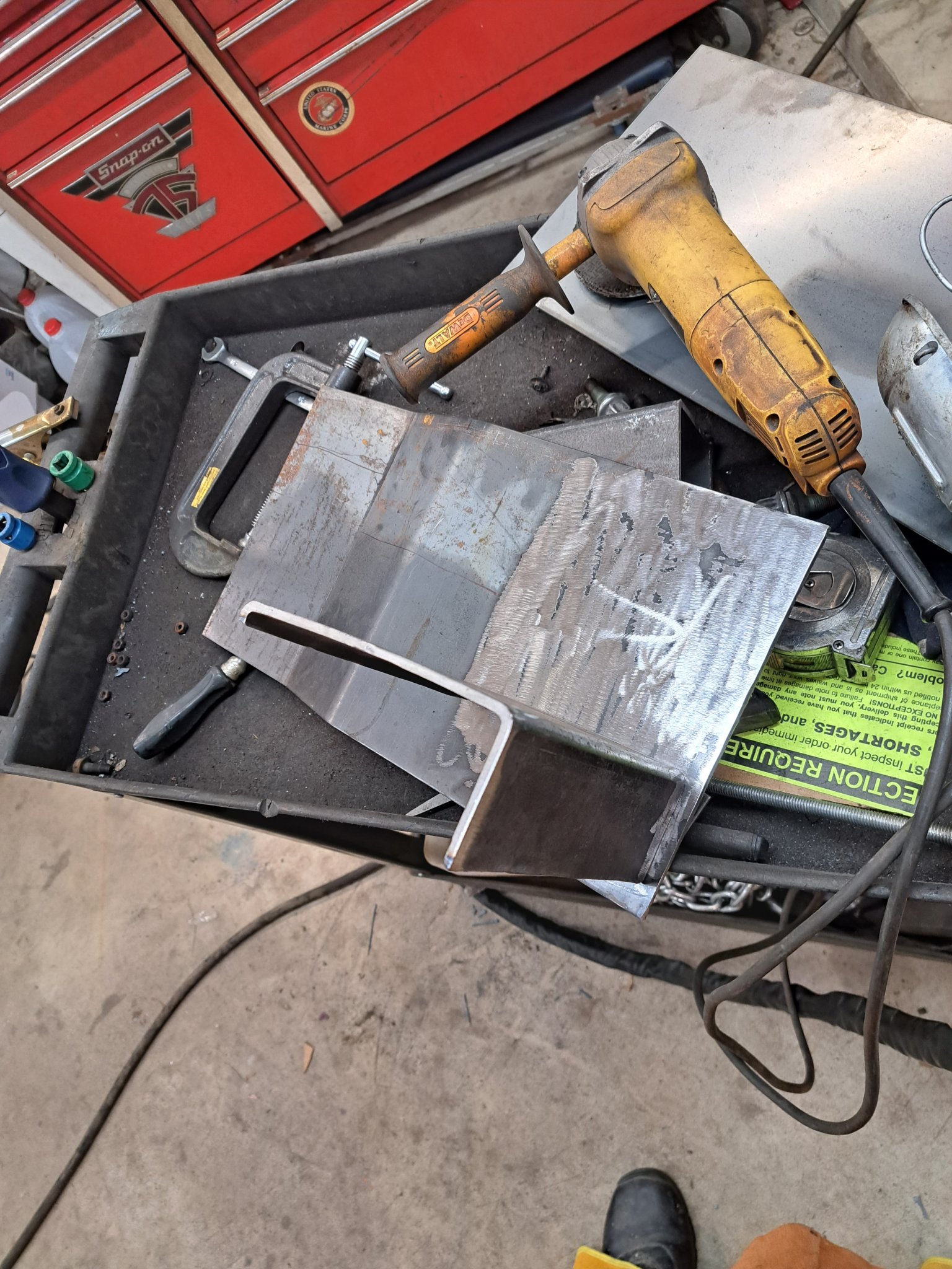

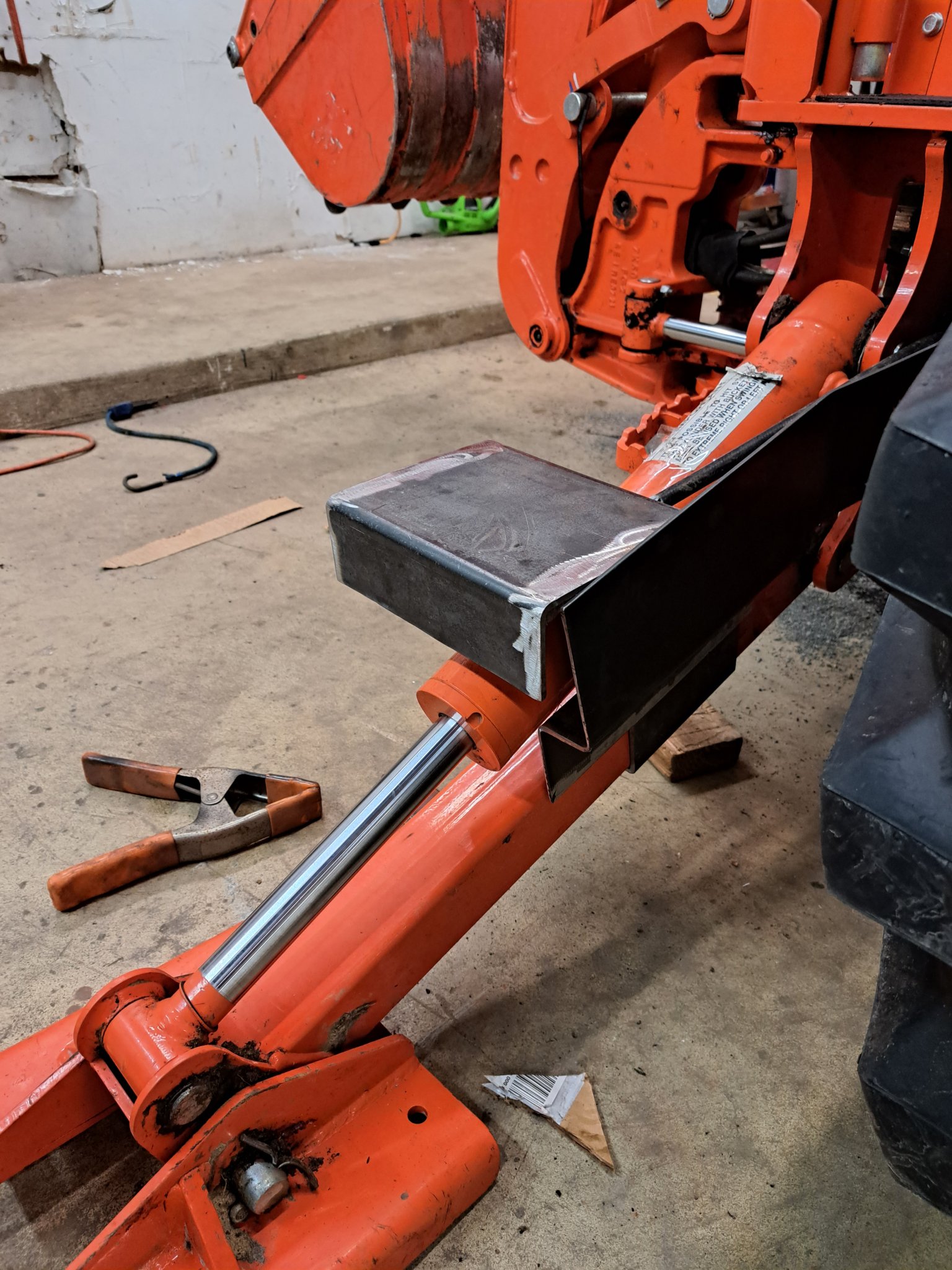

This is my first iteration
It incorporates a step and covers both hoses
The only problem is that I would ideally like to use this 11 gauge(?) piece of steel that has been mocking me quietly, from the corner of the garage.....hahahah
a few quick measurements and I find out that will not have enough metal.
No biggie, I will order more.
But then I decide to make it go in between the hydraulic cylinder to save steel and use a scrap piece of rectangular channel that should fit around the square arm perfectly to bolt "around" the square leg....
I also realize that there needs to be a "cut out" to allow for raising it up, or it will hit the deck of the 77.
The ideas are starting to flow........finally.....
I cant remember which was which, but the idea is beginning to ferment.

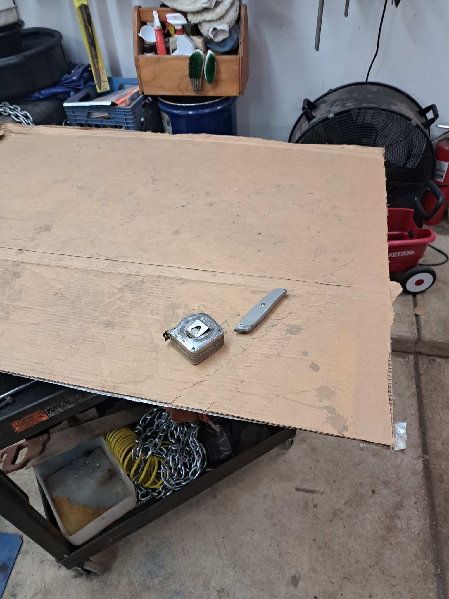

Well after about 257 iterations, 25 rolls of packing tape, and 3 acres worth of trees for the boxes I used, I have a "slightly clearer" picture of my idea.
Basically using the "box and tape" method was getting frustrating, and since I have an "idea" of what I am going to do......
Break out that Bitch'in Plasma cutter

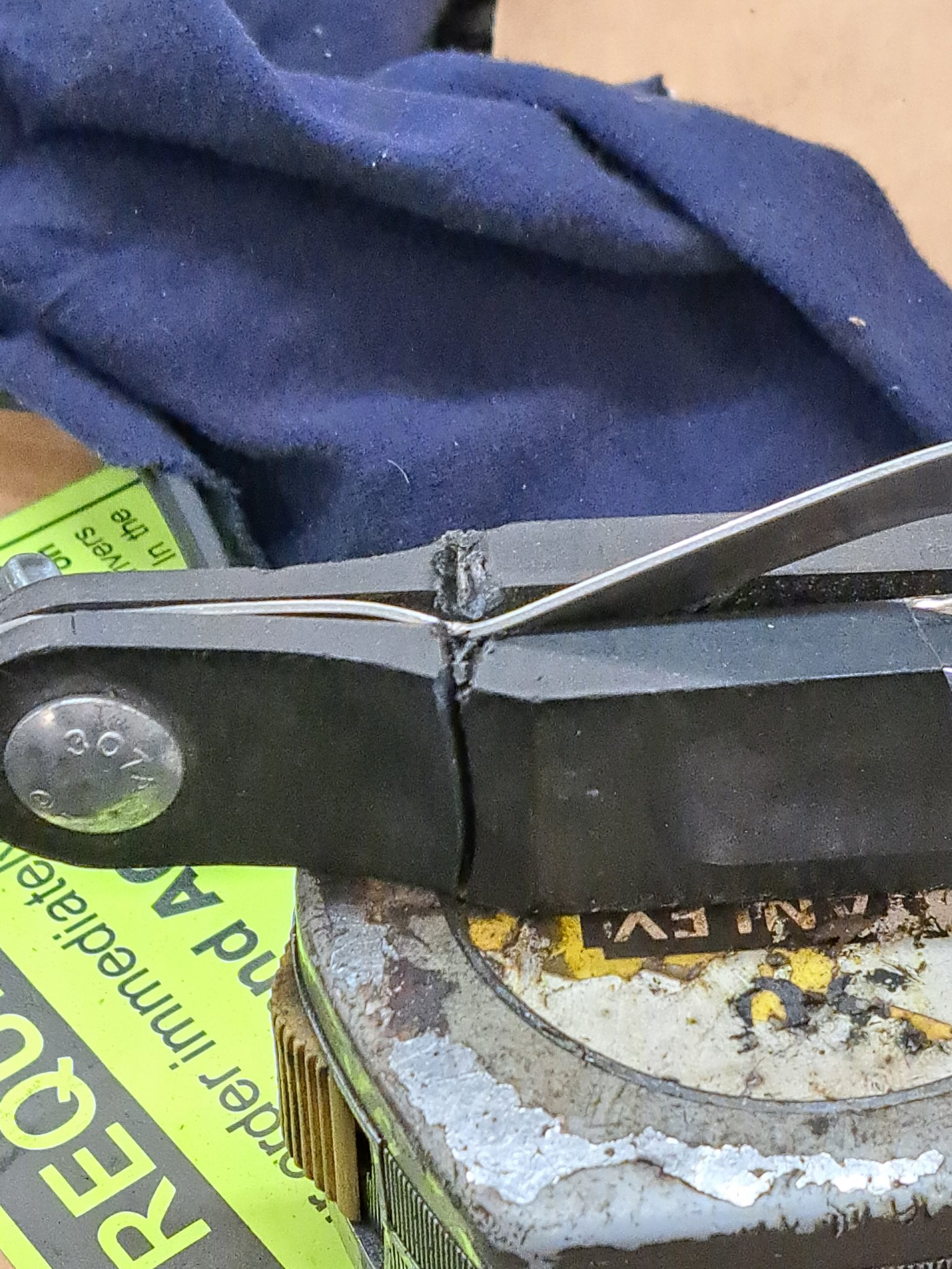

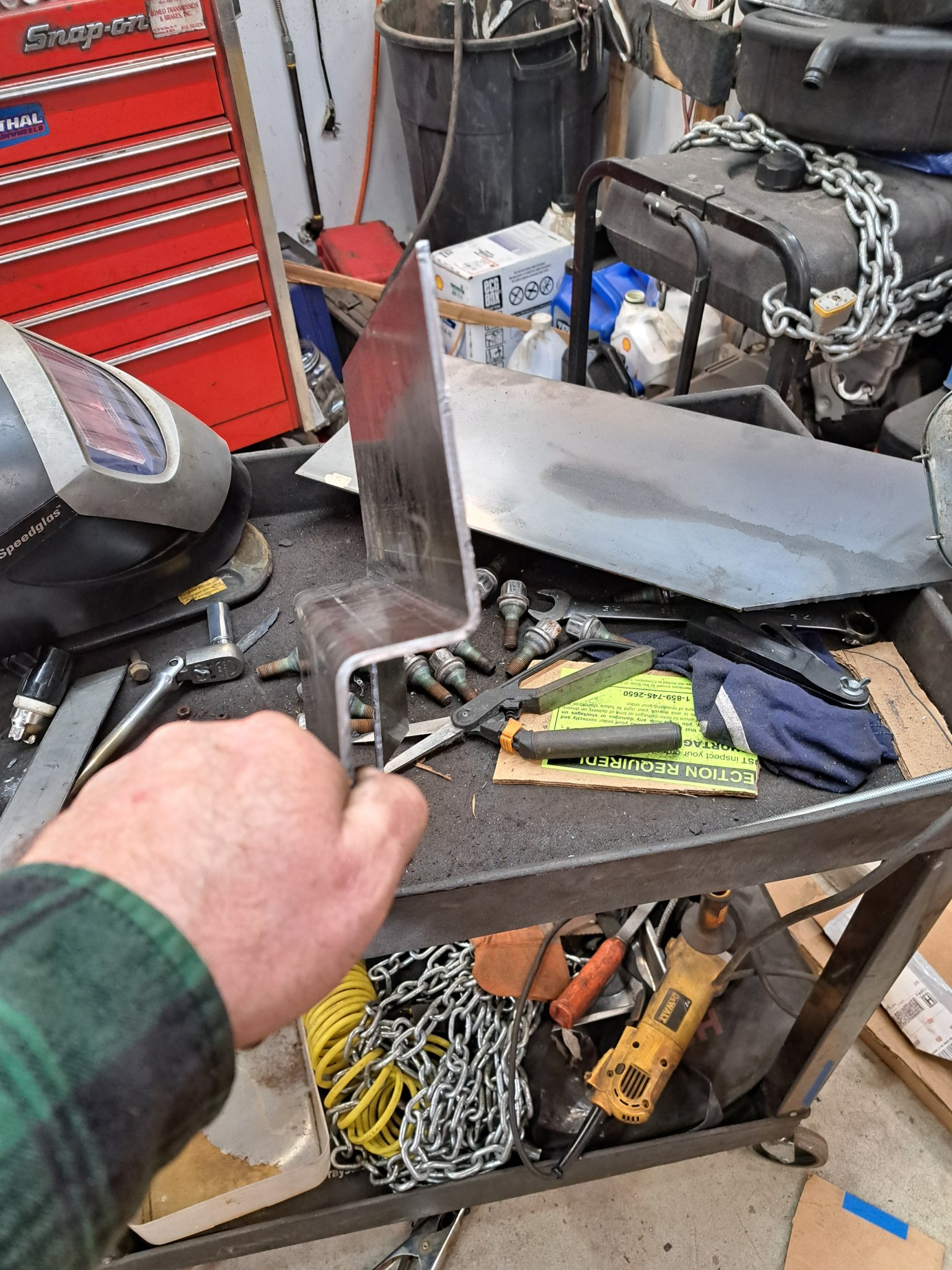

So I need to get an idea of the angle the step will have to be at so it is more or less"flat" when the arm is on level ground. I know that will change depending on the height of the outrigger, but I'm ok with that if the step is large enough.
Well in a "momentary lapse of reason" or inattention, I crush my damn "angle gauge". Well its only about 6 bucks, so I just shrug it off.
While I was "straightening" out that gauge, trying the use it one last time, I spot a couple of scrape tubing that I think will work for the step and the mounting base

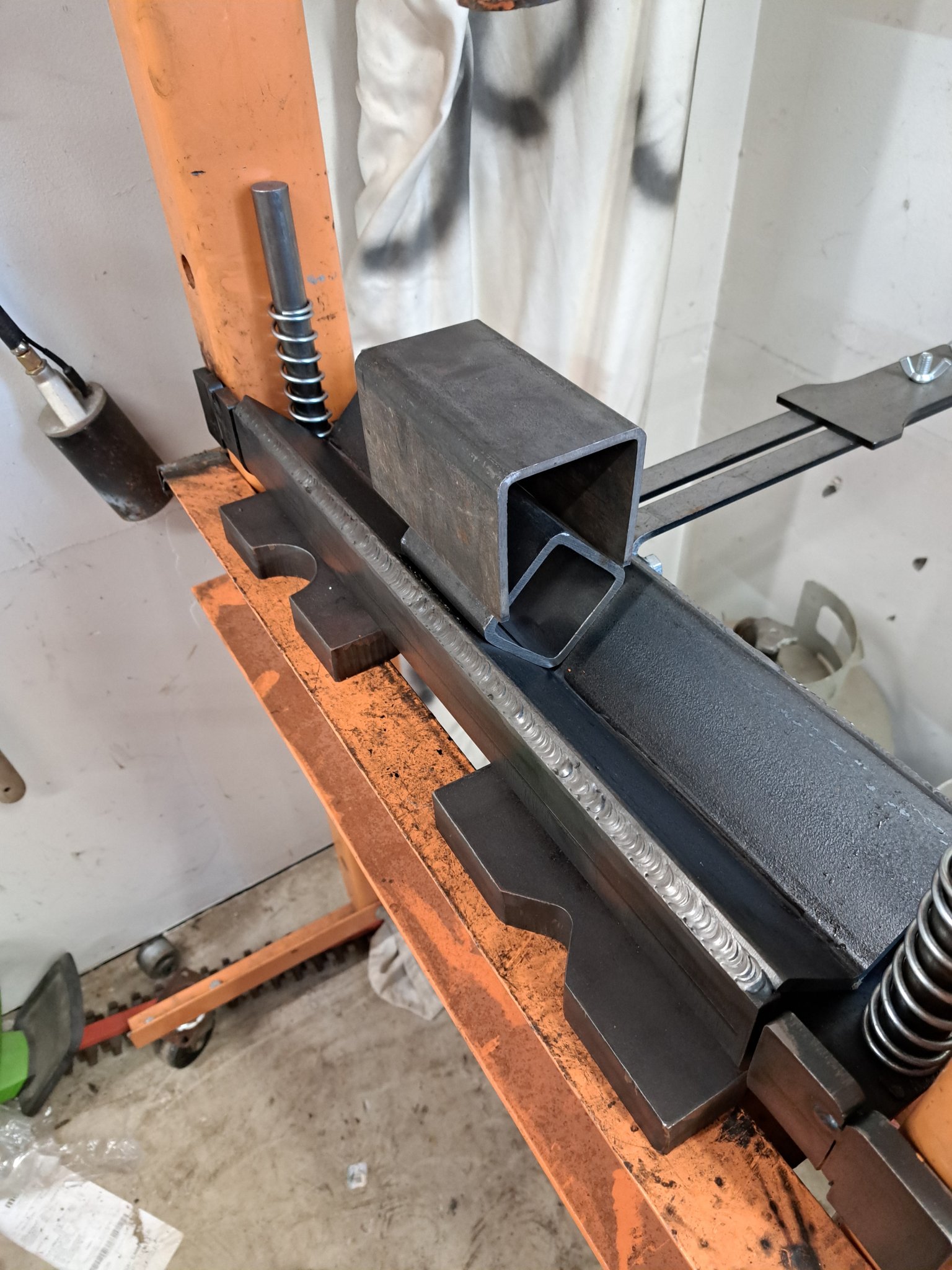

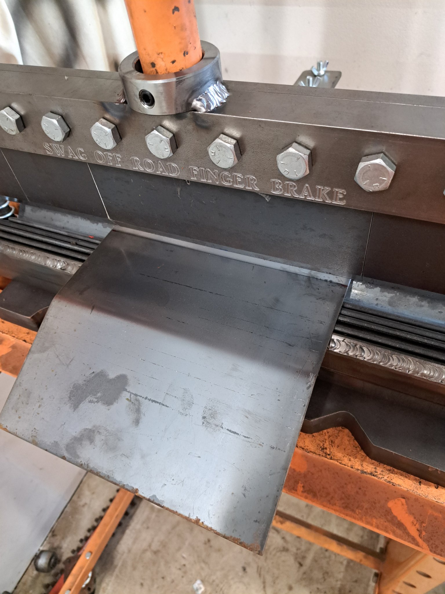

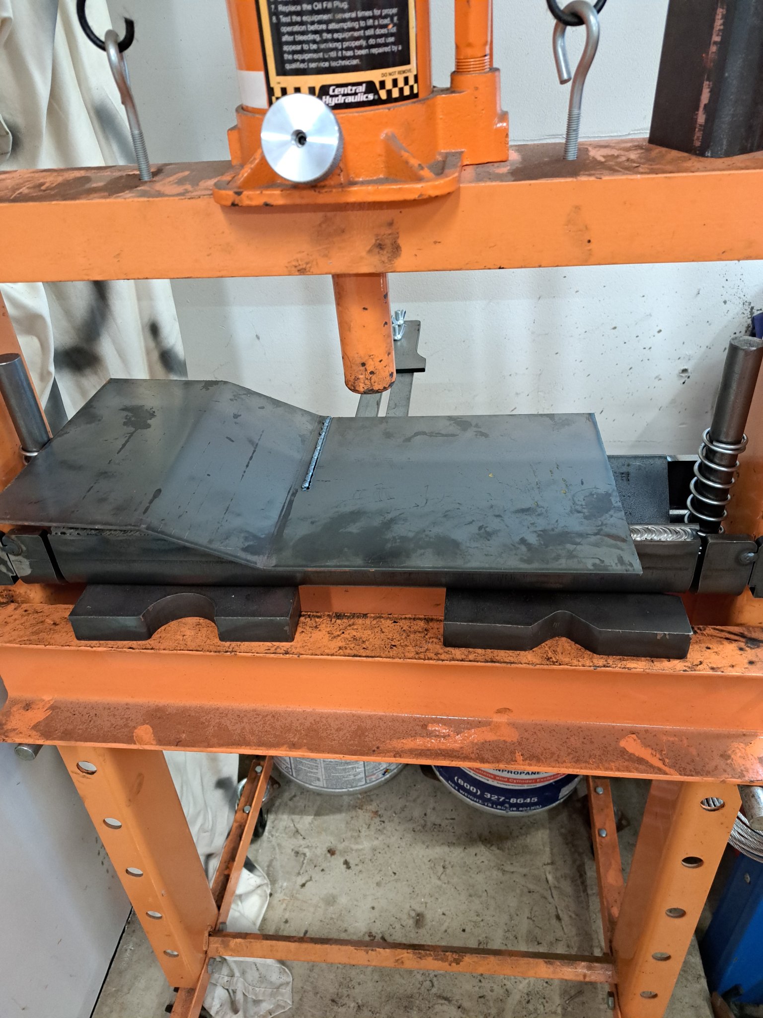

So one of the things that bothers me about this, is the "3D" aspect of it. It's hard to measure things when they "zig zag" around things and the "tightness" of the area doesn't help.
So I cut the piece a little bigger than I think I need to allow for some "bend radius".
Then I "place it" in place and use marker to place "tic marks" where I think the bends should go.

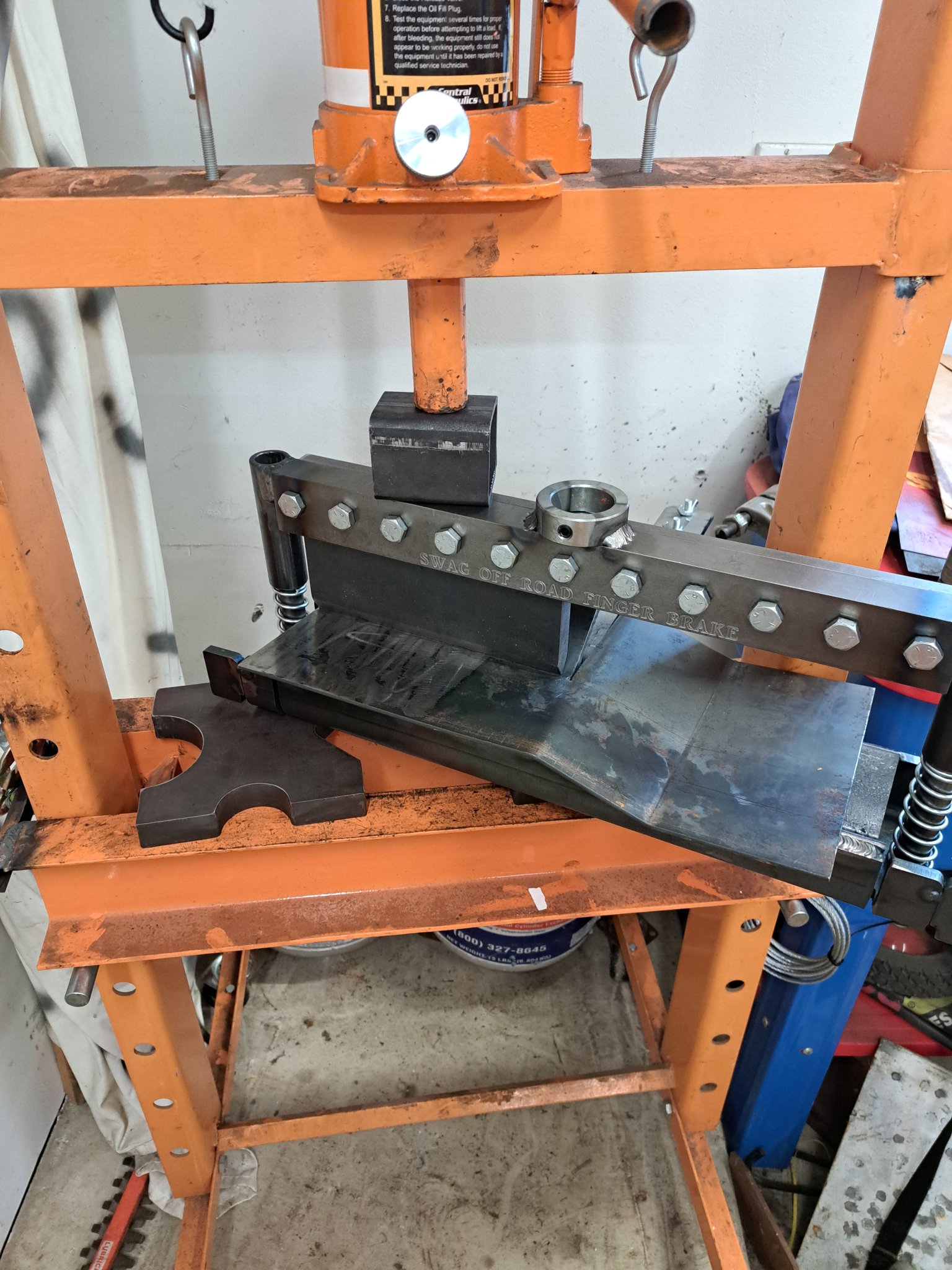

Now it's time to use my "new press'......I'm like a little kid wanting to play with his new "race track' on Christmas morning....LOL
Surprisingly, things are looking good. Now mind you I am using the "Ansatz" method to solve this puzzle so its "bend and check......bend and check........bend and check......etc
It's slow, and having to "jack up" that bottle jack is already grating on the "Laziest man south of the Mackinac Bridge's" last nerve.
(Spoiler alert...............The"air over" bottle jack is already on its way.....LOL)
I pretty much nail it, and now I need to play with the step placement
The angle of everything is concerning me, especially when it comes to raising and lowering, but I figure I will "cross that bridge, when I get to it"
And the idea for bolting it to the lower arm is developing..........
Here are a few different placement options, each with a pro and con, but one of them will/should work.

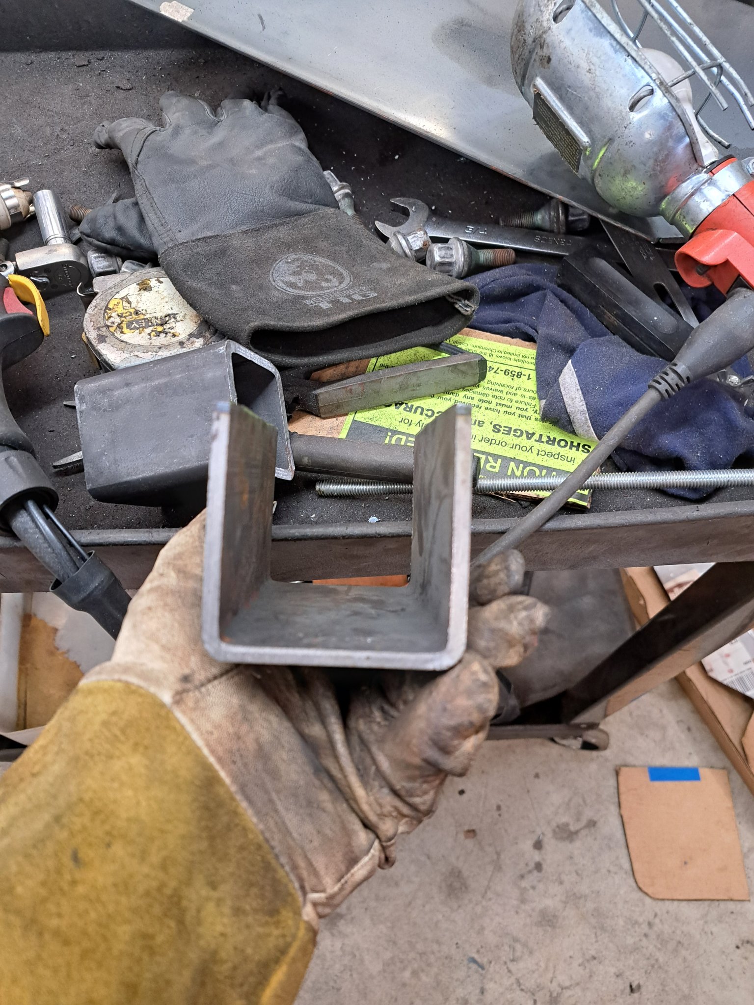

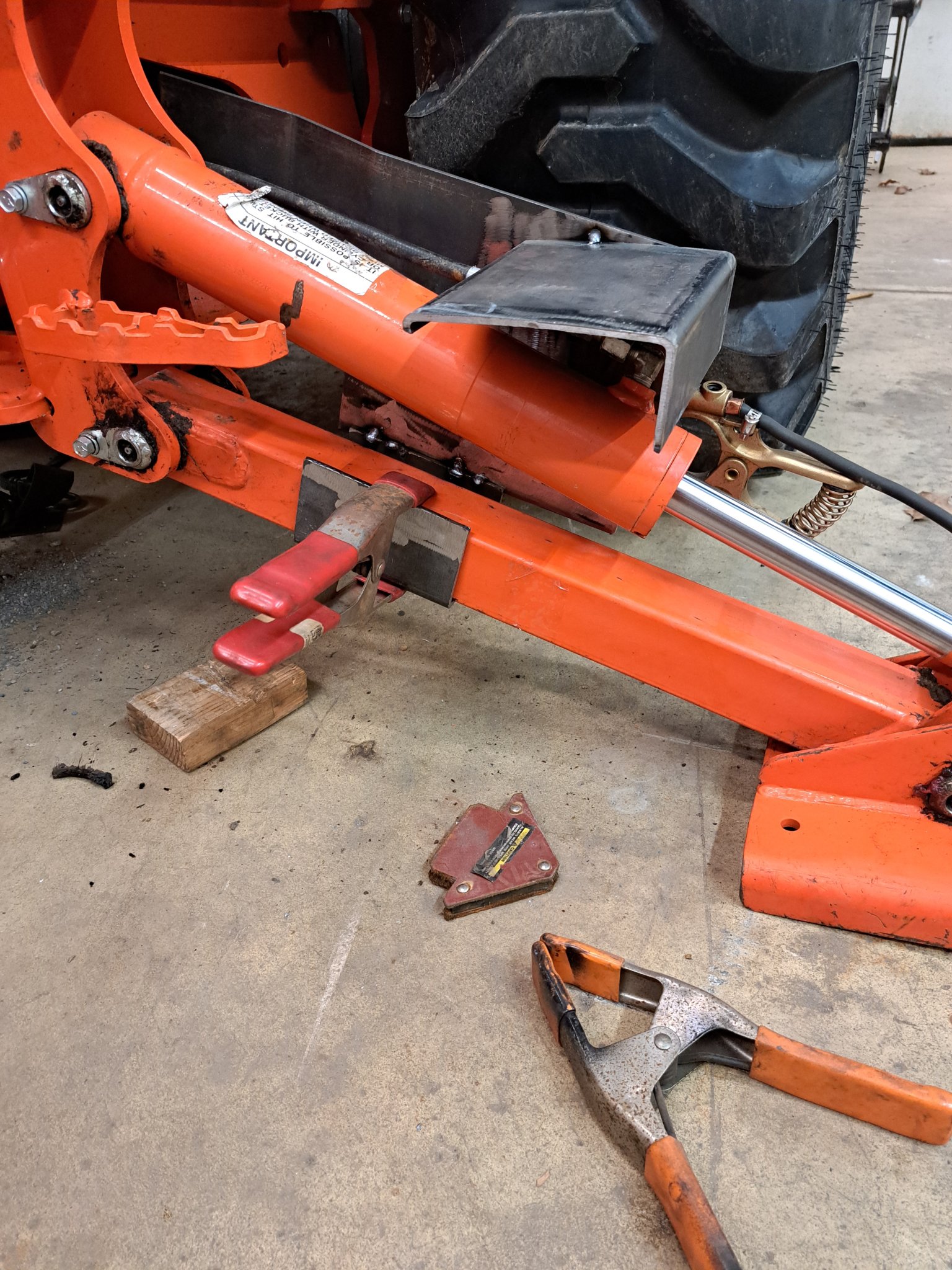

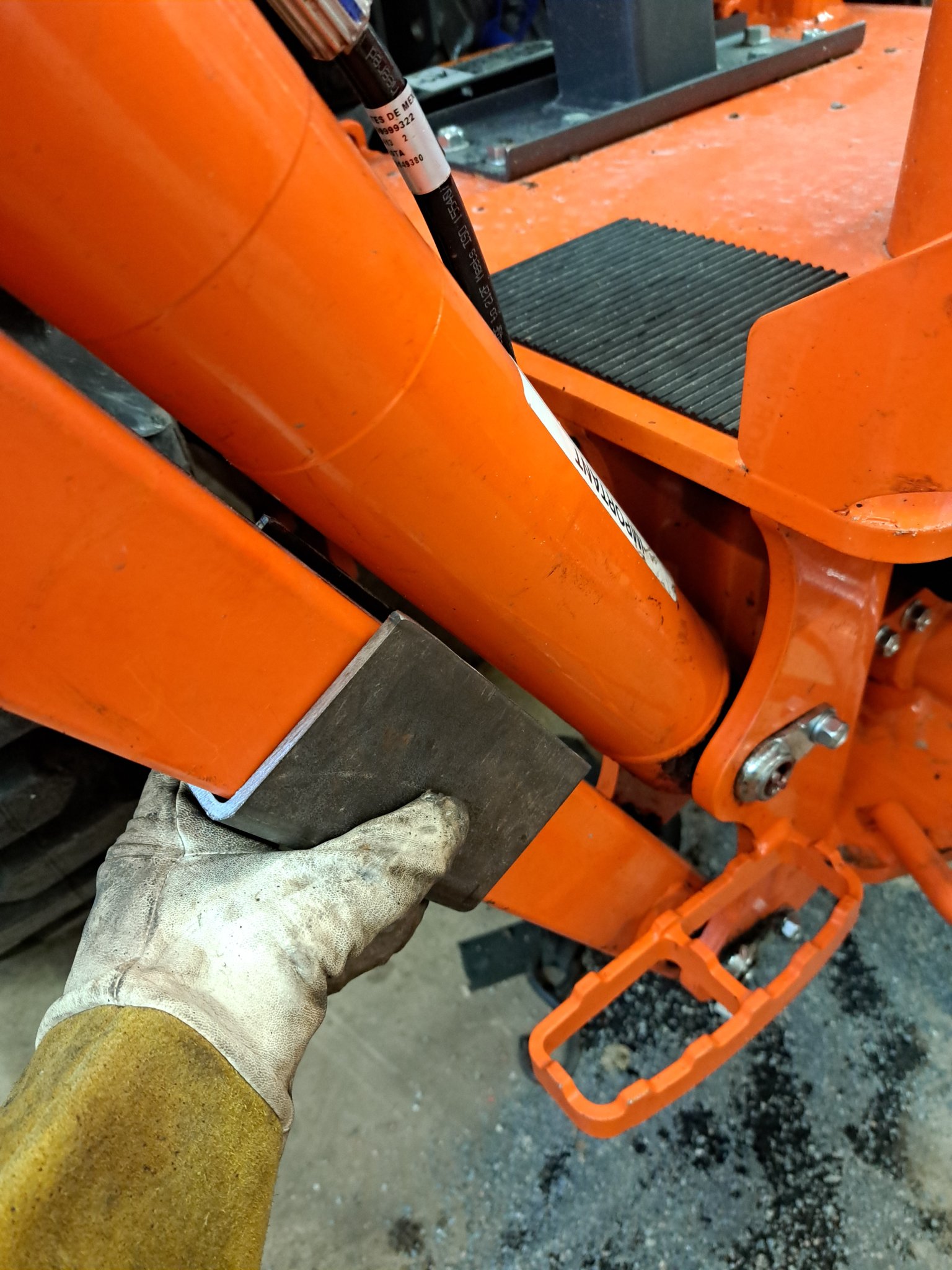

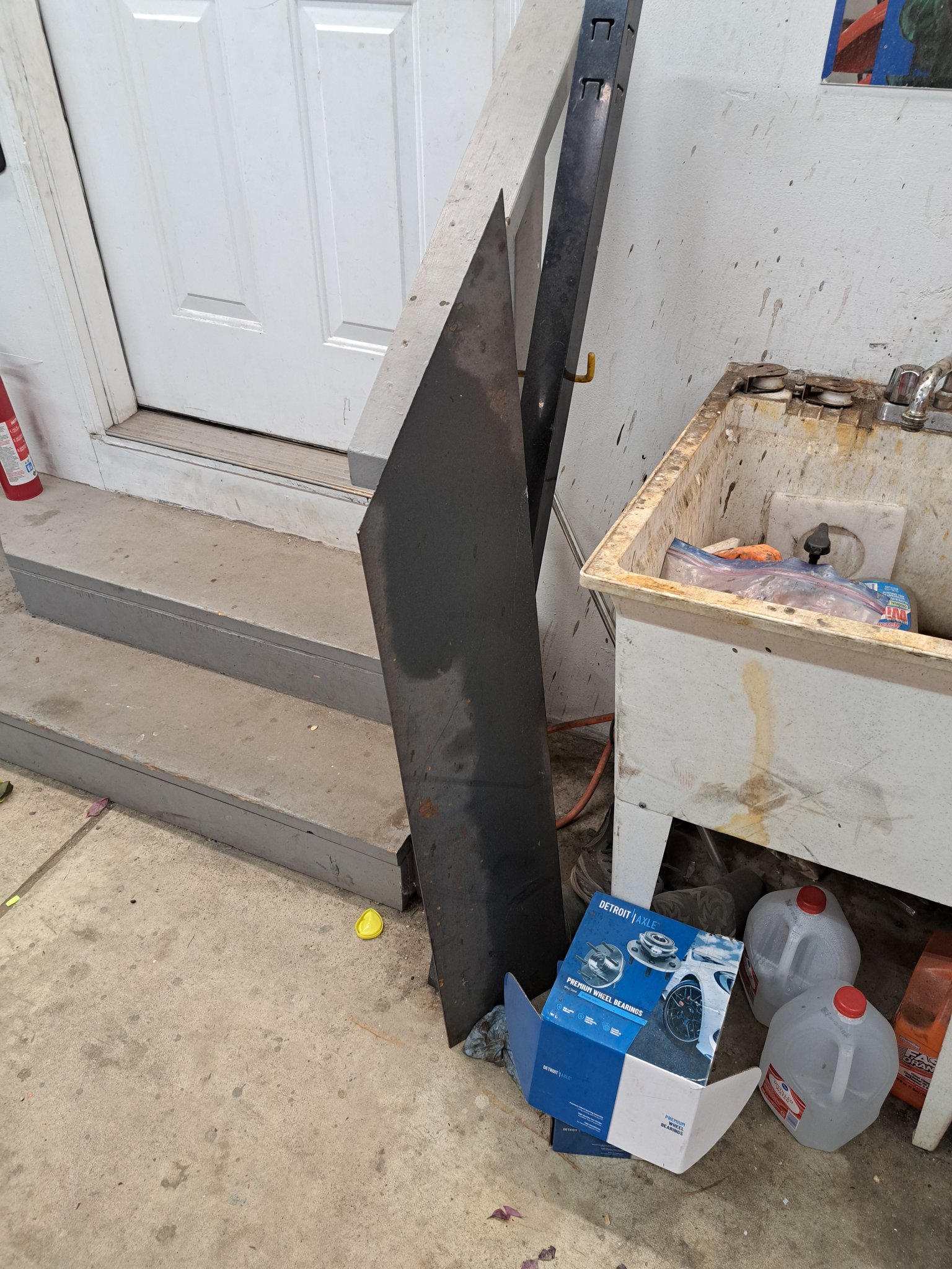

Now I pretty much need to commit to some sort of "base" for it.
Mostly because my hand is having a hard time holding the damn steel plate in place so I can take something that resembles "accurate measurements.

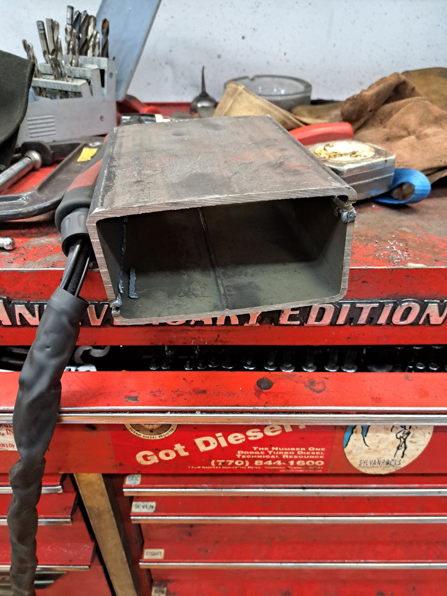

The idea I have that is foremost in my head is to cut that tube in half and it should wrap nicely around the square leg.
Back to the Plasma Cutter.
Well cutting it was easy, but I am not sure why, but it closes up a little when I cut it. its tough to see in the pic, but it will definitely not fit now.
I am presuming it was the heat from the plasma cutter, but now it will not fit around the square leg.
Hmmmm........then it hits me, use the press to "smush it" apart, so I find a scrap piece of square tubing that "by chance" fits nicely in to the press.
Fits perfect now!

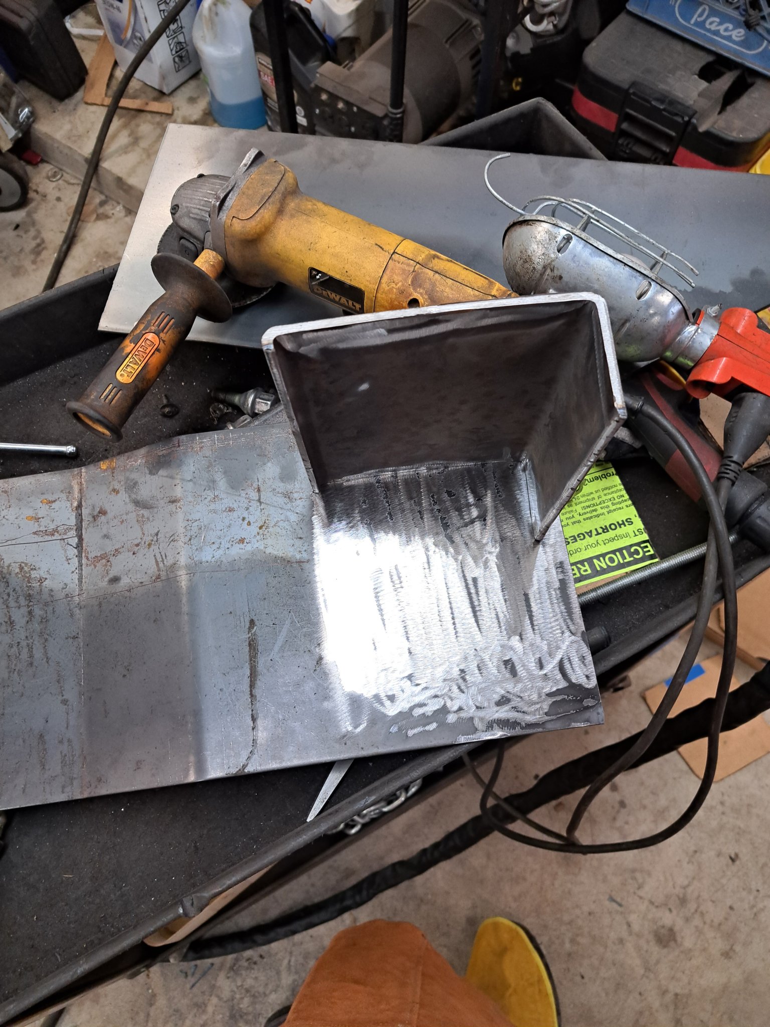

1,886
2,003

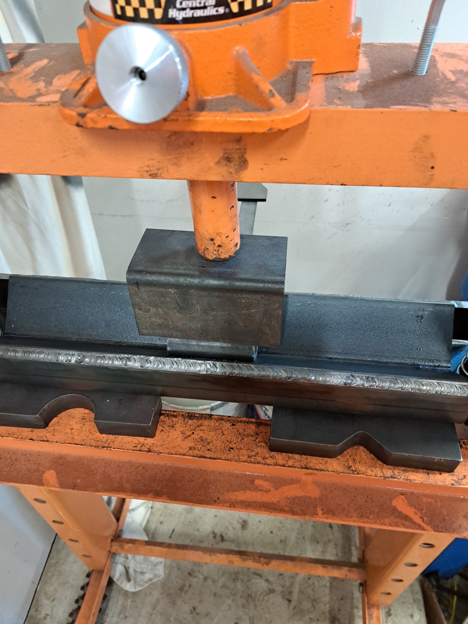

So now its too far away from the square leg to weld it so I need to bend it so that it stays far enough away from the hose/fitting yet but still enables me to weld it to the "base"
This is getting complicated.
So I go to bend it but the bend is on the right side and fitting it into the press is causing me to have to get "creative"
I had to put a slice in it so i could bend it without jacking up the other bends as well
I tried to bend it like this, but I was worried about screwing up the "uprights" on my press with such an uneven load.
So I decide to move the press and to make the "load" more or less "centered"
The only thing I have to do is put the bend in it the correct way....That's my main focus.....
Concentrate dumbass......concentrate.....you can do it... just bend it the right way.......
I am not sh!tting you, as I was bending it, I was actually saying out loud "you gotta bend it the right way man"
And yep.....You guessed it...............I bent it the wrong F'ing way
Agggggghhhhhh!!!!!!!! M F'er!!!!!!!!!!!!!!!!!!!!!!!!!!

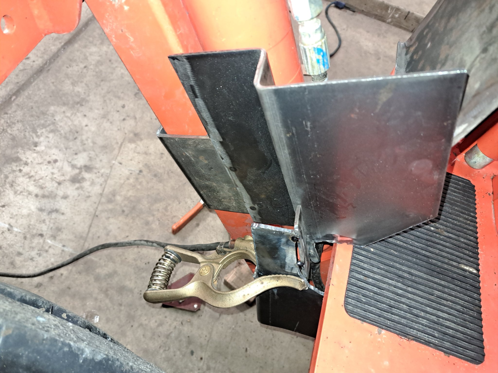

Skipping ahead a little, I am basically to the point of taking the step on and things appear to be going OK, but there that little voice in me.....nagging a little about something.
Oh well, screw that voice.
Then I gotta do a "little trimming" to make sure it does not contact anything.

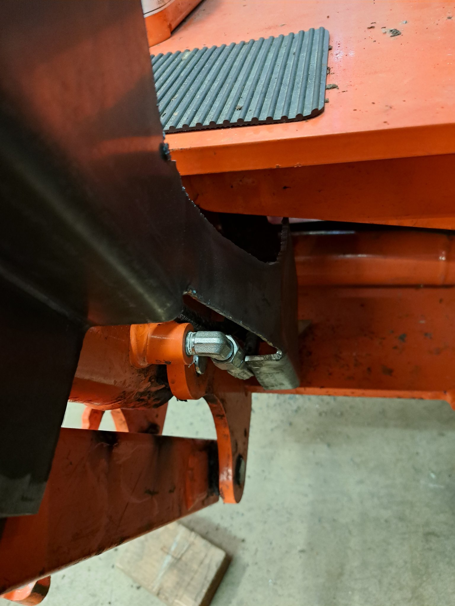

Well let me tell you mister, raising that thing up CHANGES EVERYTHING!!!!!!
Now all my design faults rear their ugly head almost all at once......
I hear General Quarters sounding in the distance..........there's a U-boat in the water................
So many things changed when in the up position as compared to the down position, it blew my mind.
For some strange reason I could not see the 'Forrest through the trees' and its bad.
Calling Dr. Hackenslash.......calling Dr. Hackenslash.....

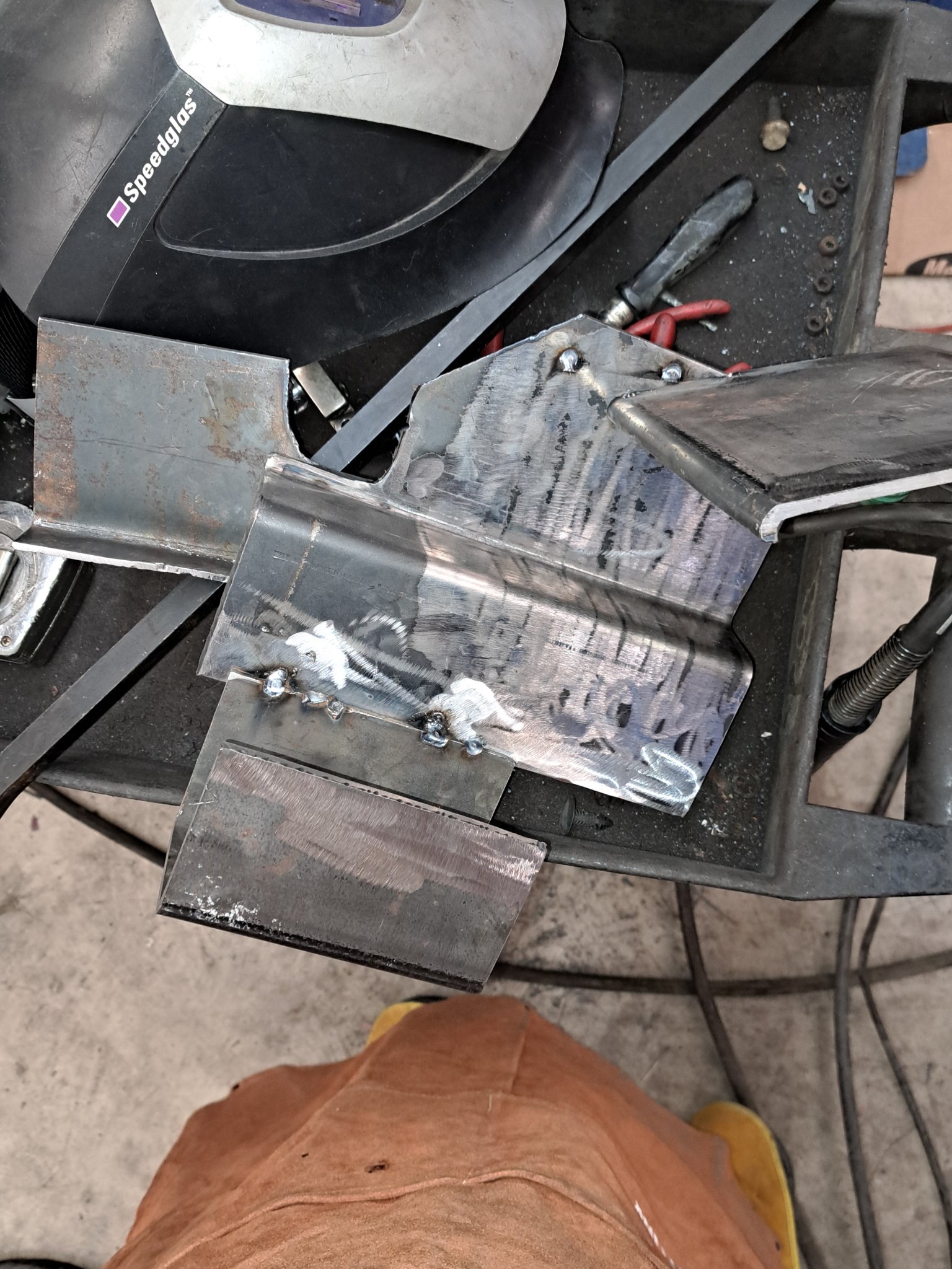

So in a gallant attempt to save nearly 2 days worth of figuring, bending, cutting and welding, I basically revert to a Mickey Mouse "cut and patch" attack.
I start slicing and dicing this monstrosity up and welding patch's, hereto and henceforth.
But the die is cast......It's a POS design that was doomed from the beginning.
As the "torpedo of fate" hits the USS Good Idea, it is abundantly clear that the powder magazine has been breached, and she's going down.
1,886
2,003

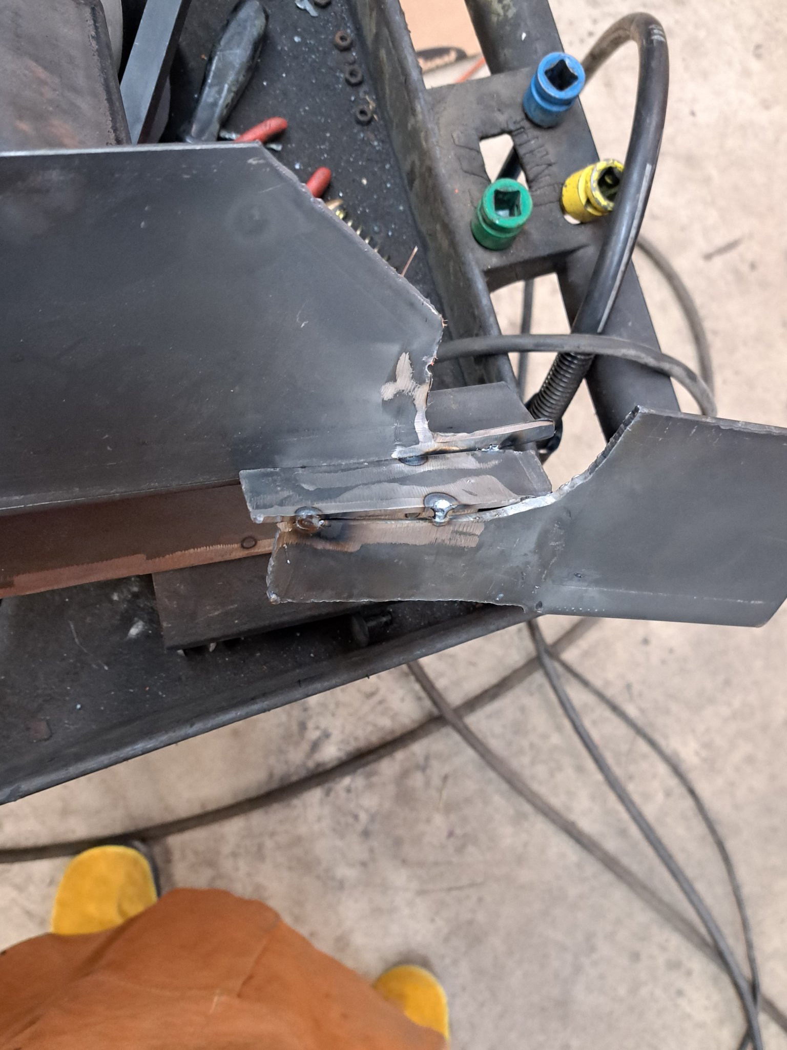

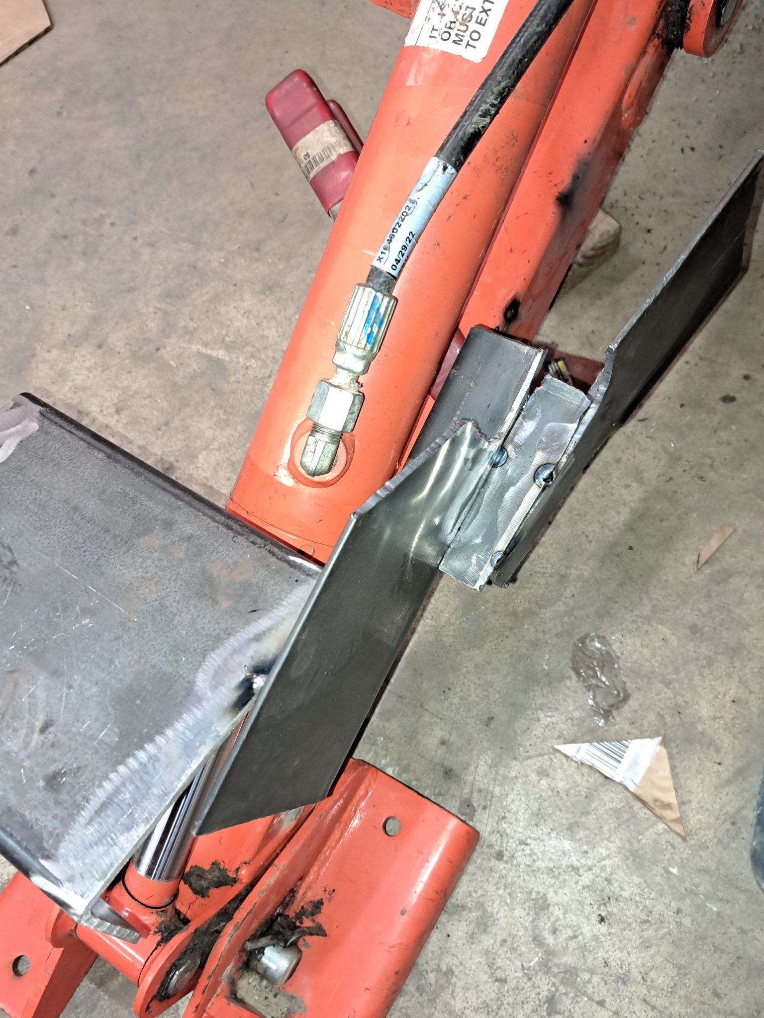

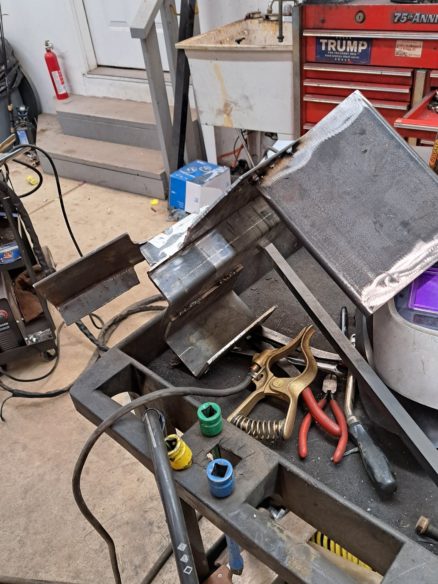

here is a sample of the Mickey Mouse patch work.
Here is the end result of an Epic Fail

The end of this story seems a bit abrupt.....but honestly I am still going over just how much stuff moved and "changed' .
In the end almost nothing I did worked.
Every bend seemed to hit something, every cut out was too big or too small.
The step would have cleanly busted off the very fitting I was trying to protect, unless I moved it so far that it would have been worthless........
The worst part of this, is that I am back at square one.
Although I still have no idea of what to do next time....I can assure you that there will be a "next time"..
