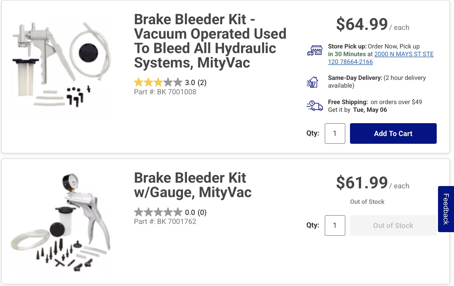

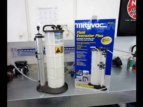

Now IF you have a large syringe laying around and some small tubing - you can suck out a bit via the dipstick passage. Most of us are forced to do this on water craft since the plug would make a hellva mess in the boat.
