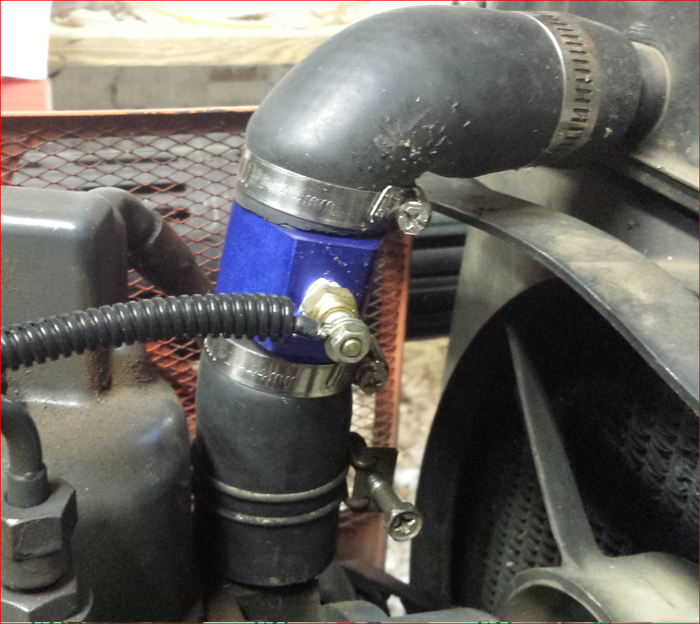

I have one of the fittings like North Idaho Wolfman suggested installed in the upper hose on my B7100. I don't think my tractor is any different than yours.

I too installed one many years ago - bought a new radiator hose just to be safe - measured 5 times and cut once!;)
works like a charm!

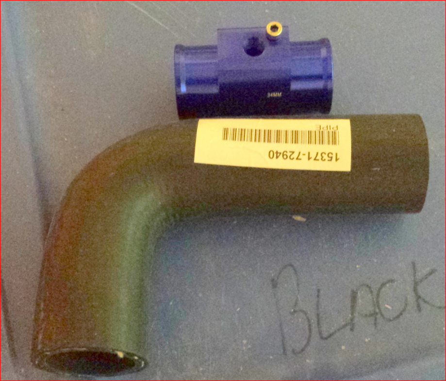

OK Hokie. It is the same. I was gonna ask if someone could take a picture of the fit-up so thank you. I think I'll go with the red one (wink). Is that a Kubota hose and P/N? Where did you put the gauge so its not hanging down under the console to snag your boot?

Pull the hose off yours and measure the diameter and get the fitting that fits.
That is not a Kubota hose that's aftermarket, just walk into a auto parts store with your original hose and have them match it up.

I stand corrected, the hoses that I got for my B7100 were still the cloth covered hoses.

Got it rigged up and tested. It's holding with no leaks. I did have to shorten the cast housing a bit so it didn't kink the hose even with the formed 90d bend. Somehow my radiator is a little lower that in the picture. Now I have to find the darned idiot light that is up in the shop somewhere and wire it up which is a cakewalk.
Thx again for the pix.
