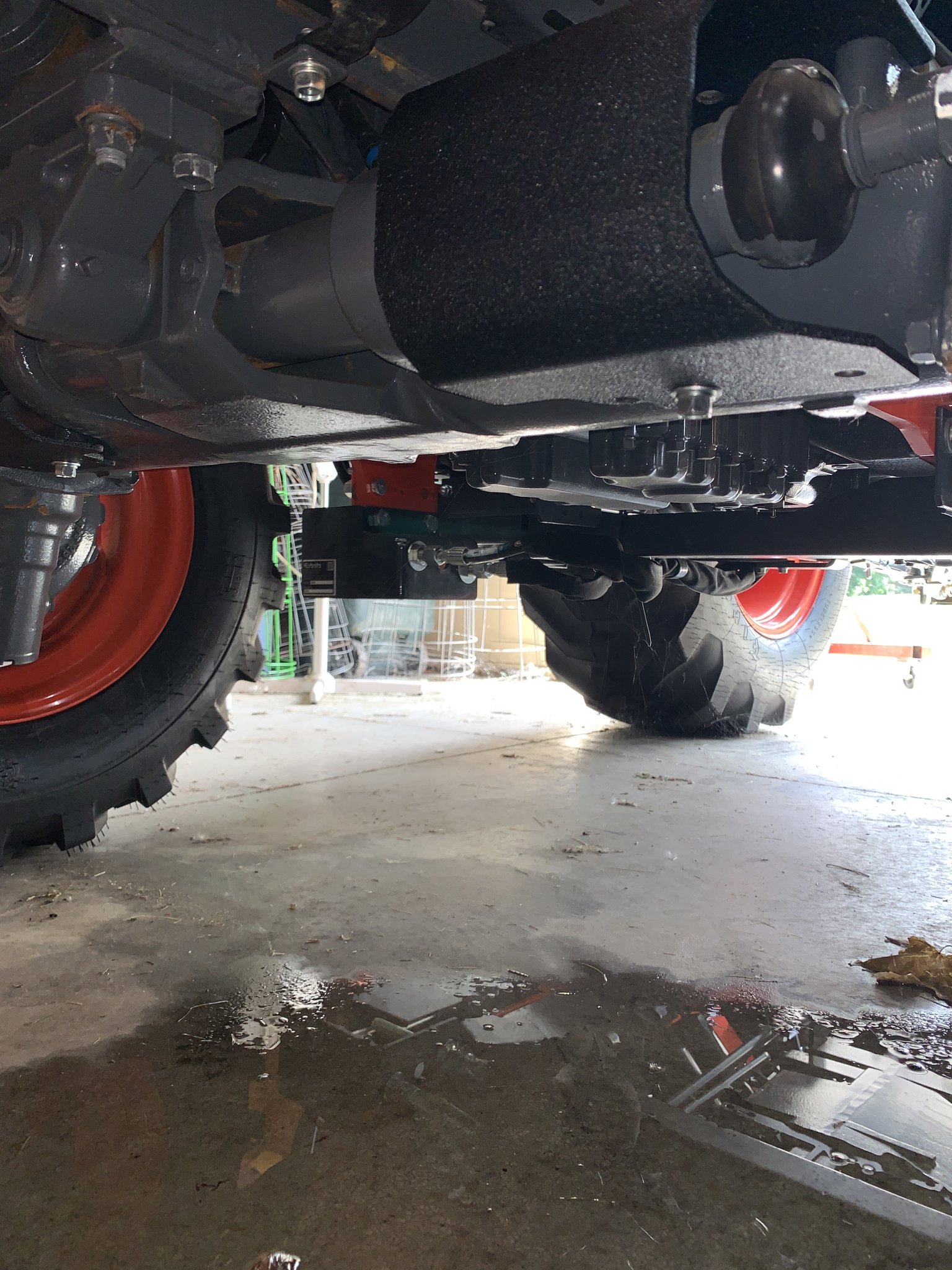

Did you check the fluid level in the front axle anyhow, since they have been known to be under filled from the dealer in recent years.
What did they think about the routing of those 3rd function lines? Standard “They’re all like that.” ?
Yes, the tech checked the front axle fill level with a flashlight. All good there.
aghhhh, i forgot to ask about the routing of the 3rd function lines….duh!

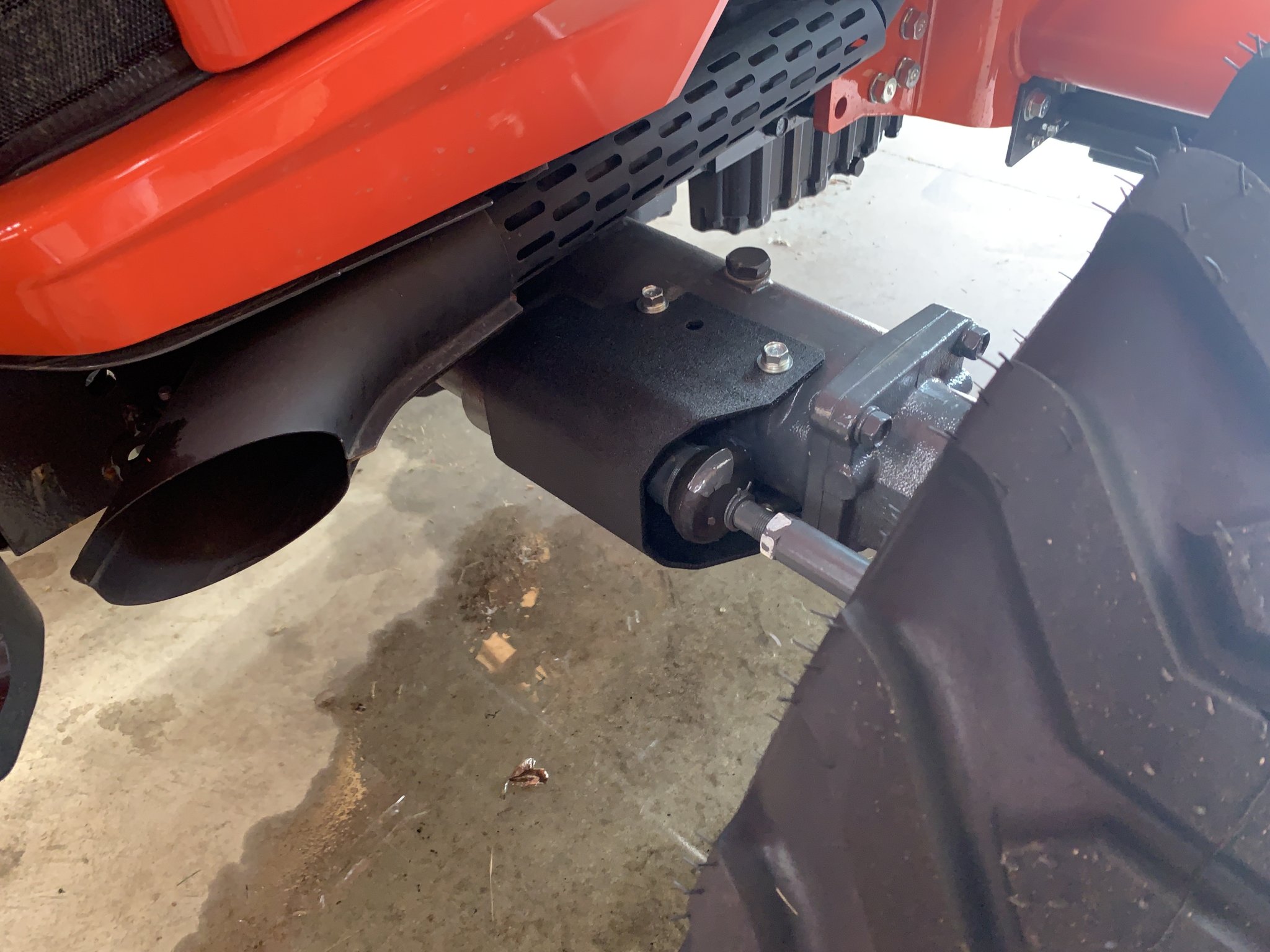

Why does it look like the front axle has already been worked on/removed? Look at the bolts holding the front axle support, they have been messed with….
The grand L 60 series tractors are shipped in a crate (usually), with the front axle bolted to the crate turned sideways alongside the tractor. During assembly process, the axle assembly has to be installed.
So with that, I'd lean toward a loose or pinched or otherwise leakin power steering hose.

So as you can see there isn’t time to troubleshoot. I need to rifle shoot this sucker. Assuming I get some time, given the location of the puddle what should I look at for finding and hopefully repairing the leak. The tractor has less than an hour on it and that is just for moving stuff With the forks. The oil is pretty clear, not amber. Help! What kind of oil is it? Where can I get some. If it is hydraulic oil, i just moved to Maine the new Kubota oil I had.
Tractor equipped with very vulnerable OEM third function plumbing behind right front wheel. Check connections carefully as easy to damage/destroy. Regarding rifle shooting, there are no silver bullets, especially in chat forum.
