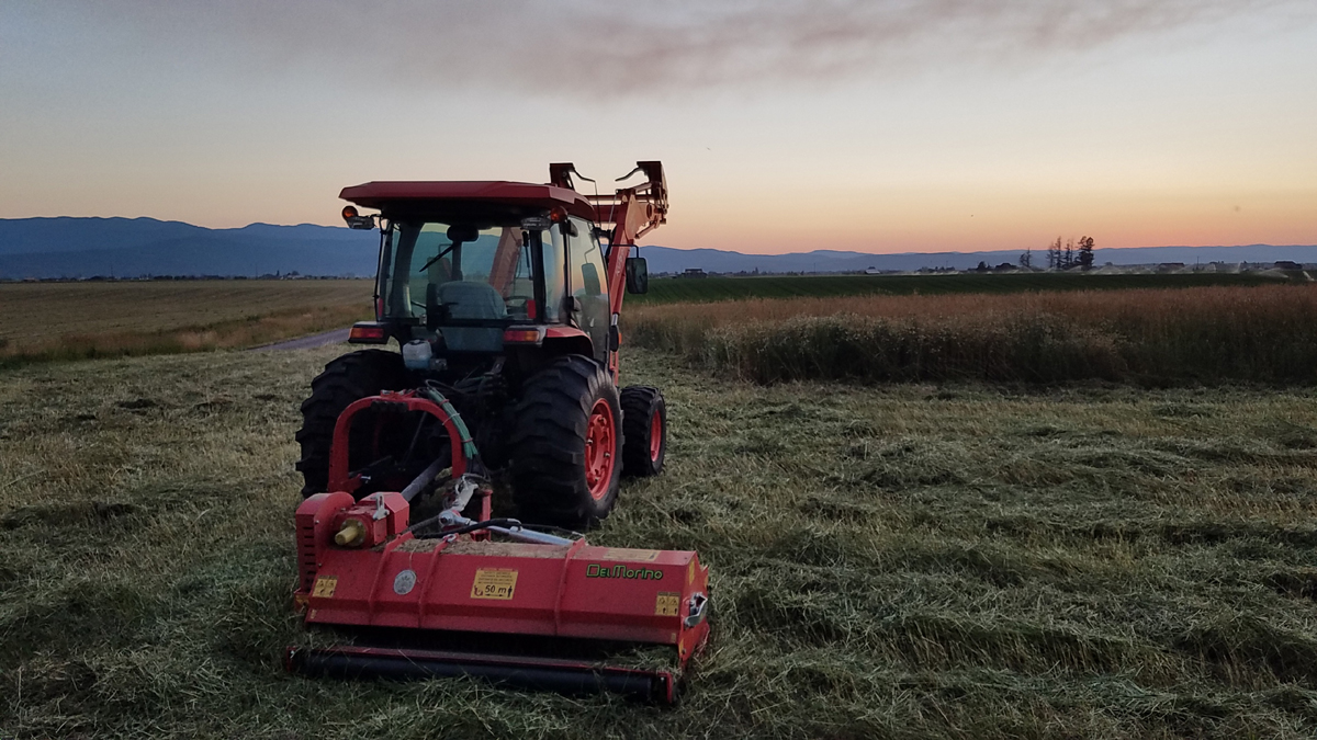

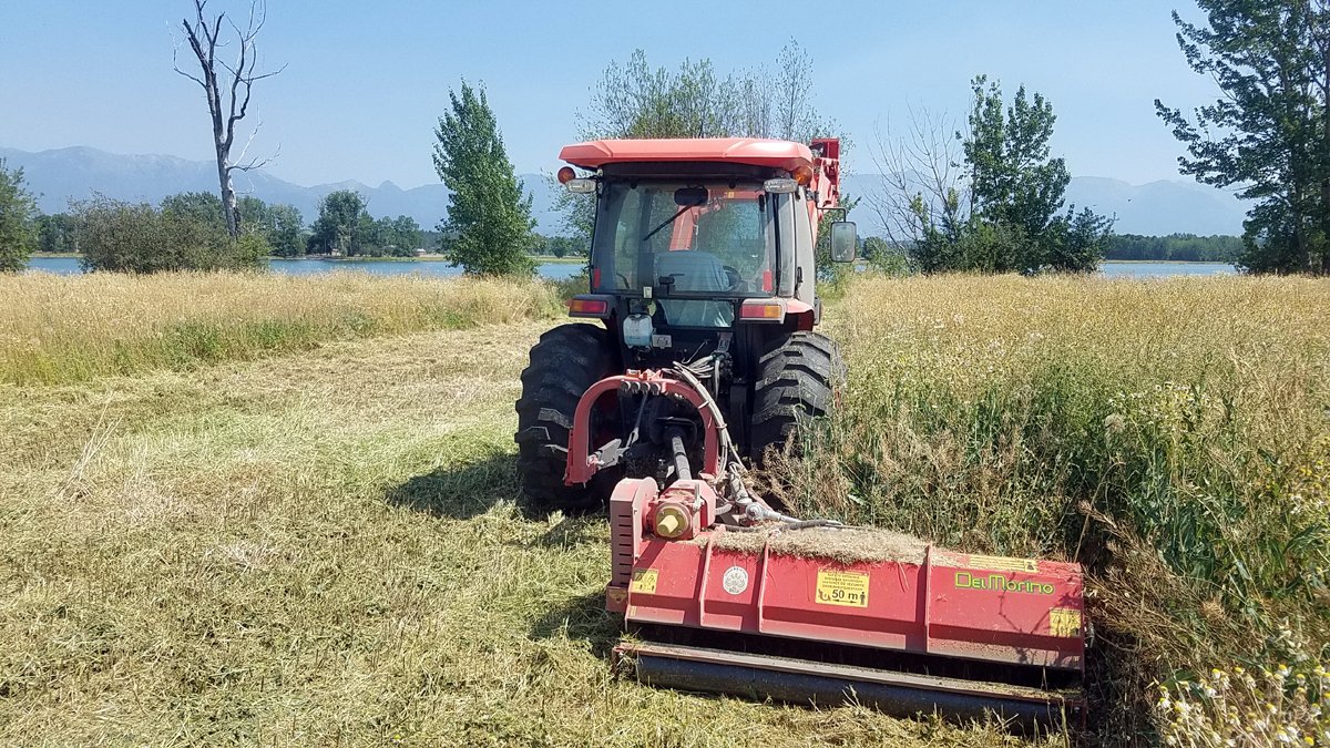

I have a Del Morino Centurion Super 158 that I'm happy with. I ordered it in March of 2022 and received it in April of 2022. It has hydraulic offset and a rotating cutting head. One of the things that's striking about flail mowers is how easy it is to turn the cutting drum by hand just by rotating the pulleys. It doesn't take much effort to run those things at all compared to rotary cutters that have a lot more mass to get up to speed. They're also a lot quieter than rotary cutters and do a better job of mulching.
Take a look at Good Works Tractor Co. if you're serious about buying a flail. Courtney is a really good guy and will take care of you. Del Morino makes quality stuff with different tiers of products depending on the application. I don't think that the model I have is commercial grade or anything, but really good for small farms or homeowners with some property to take care of.

The Del Morino Centurion Super 158 I have weighs 820lb and I have no problem at all with it all the way extended but my MX is fairly heavy with wheel weights and liquid ballast.
Courtney showed the Del Morino Super 132 on his YouTube channel recently. It weighs 573lb and is intended for smaller tractors.
