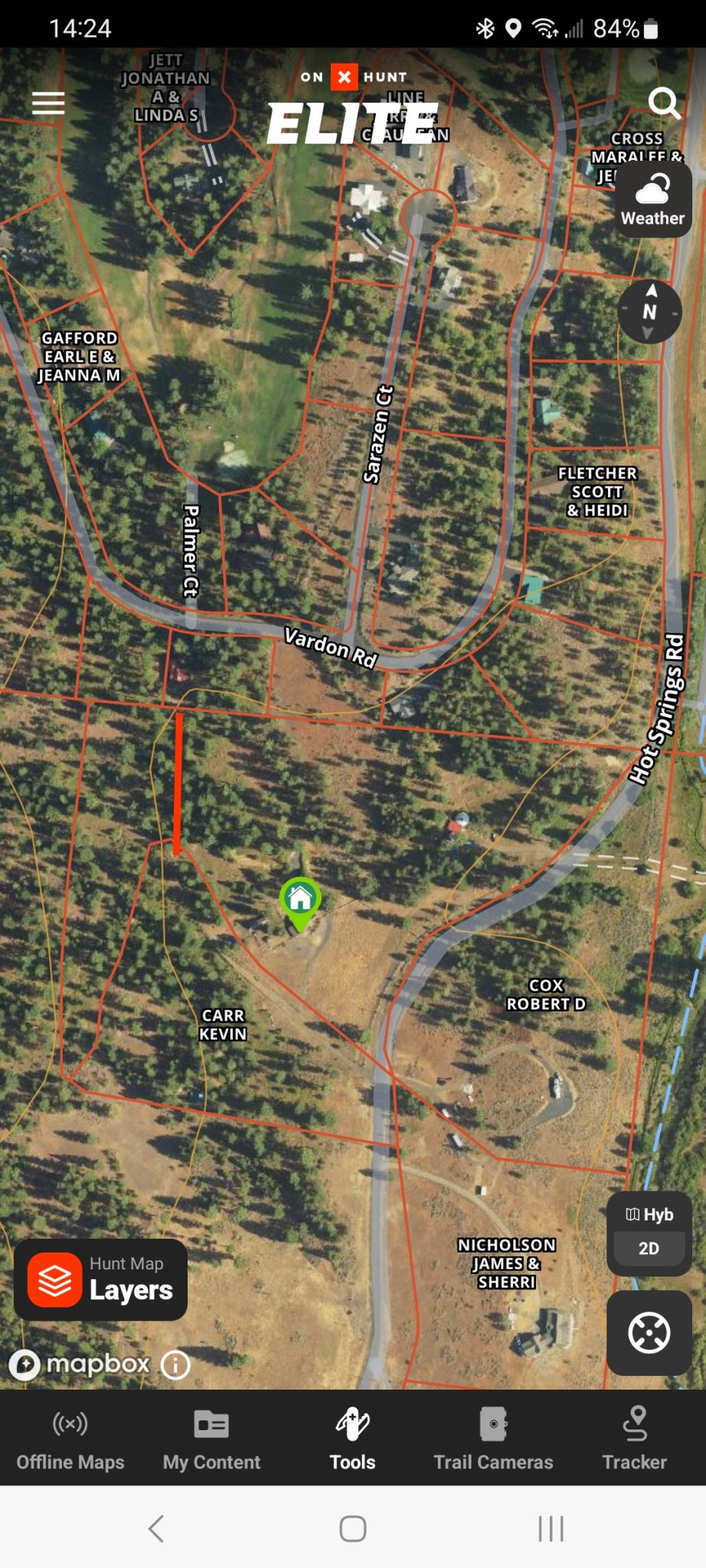

Hey all, I just purchased an 8 acre parcel in new meadows, Idaho. My excuse to buy a tractor. I have about 500 yards of road to keep snow off plus around the home, shop, barn and a few out builds. The road is dirt and gravel. I have approximately 1 acre of pasture. The rest of the property is forest. So I’m thinking about a Grand L6060 with these implements, L1055 loader with L2296 bucket and bolt on cutting edge tl1748. L4479 snowblower with these parts, L8387 mid pot, L4431 comp kit, L4455A frt quick hitch, L4483 driveline ( with 8 hrs install) LAN BB1272 boxblade. I’m I going way over kill on this tractor? Every out here say the more horses the better. Out the door 85.5K. Is it worth throwing the no sales tax in Or. at a dealer in Boise area? Also looking to add a pallet fork, I like the TITAN PRO DUTY forks. Planning on Kubota insurance and is an extended warranty.

Thanks guys. Lots of good info to mull over. I'm at 4000' elevation so turbo is a must. I'm trying to get the shop built before the snow flys here this coming winter. New Meadows gets about 100 plus inches per year. The home will be built next year. My 1 acre of pasture is a disaster, all the top soil is gone, it might take a few years to bring it back to life. I do like saving saving money, more parts and other stuff. My initial work for the tractor is removing trees and vegetation, for the excavator work, same for the home next year. Besides keeping the road clear of snow.

Some are saplings others will meet up a chain saw and be drug out. The more I can do before the excavator shows up the better. I might rent a small excavator to help with that problem. Also I'll need it for electrical and water trenches, 48" to get below frost line. I don't care for the backhoe setup on these tractors. Also I need another 24 hours per day to get it all done. Lol the red line represents approximately where the shop will be.

I am not really familiar with your weather or terrain flat or hilly?…I am assuming not flat?). It’s just my opinion, but to me number of acres matters very little with sizing a machine…it depends really on what you want and how you plan to use it. Do you know if you plan to get a HST or geared machine? If going HST and you land is hilly, IMO there is some lug or feeling of bogging down going up a steep grade with HsT, so a little extra oomph might not be a bad idea…same with elevation maybe. I am not familiar with that much but maybe some members have some idea.
