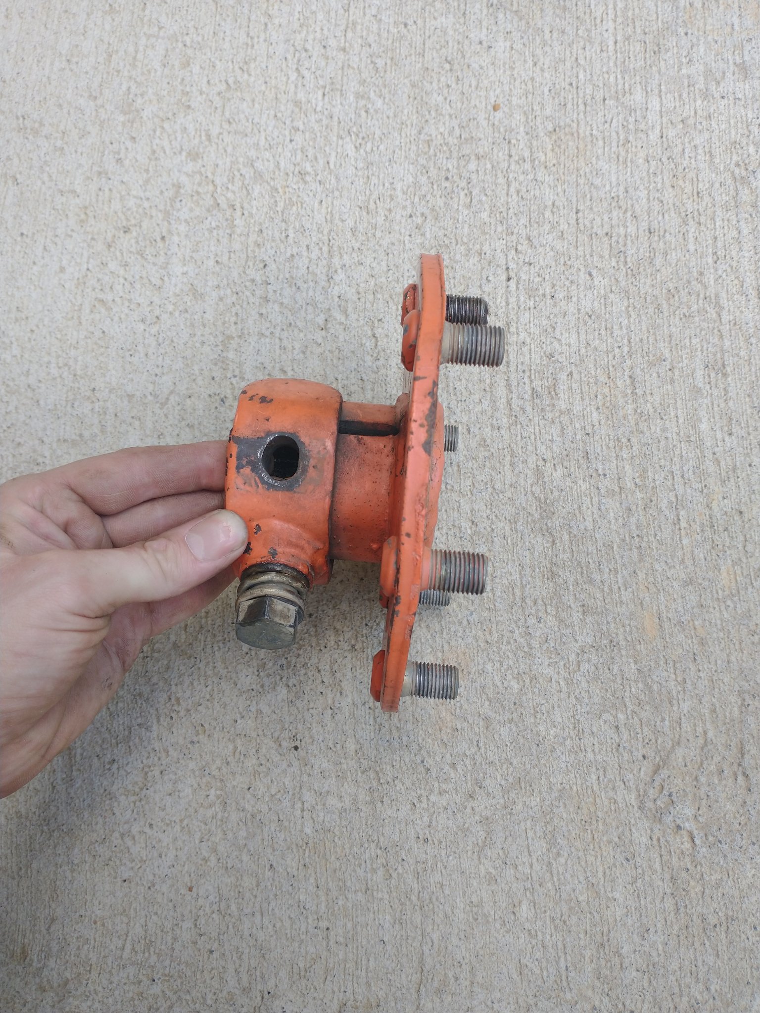

The wheel centers are actually removable - I would have to hammer out the lug bolts it looks like to switch them around though (otherwise the lug nuts would be on the inside!). If it is all the same and just reversing the rims is fine I may just do it that way.
Swapping the rims direction is right, swapping the hub direction is not, leave them in the orientation that they are.
Safety pin in the hole and tighten the bolt well.
If you end up keeping it for a length of time, there is a newer designed hub that is better.
COOL! I saw a couple different new hub assemblies in other posts as well. I'm gonna save that link in case I decide to upgrade.
The stock hubs ARE a little wonky.
I did end up reversing the wheels - but not the hub - so I'm glad that was the correct way to do it.

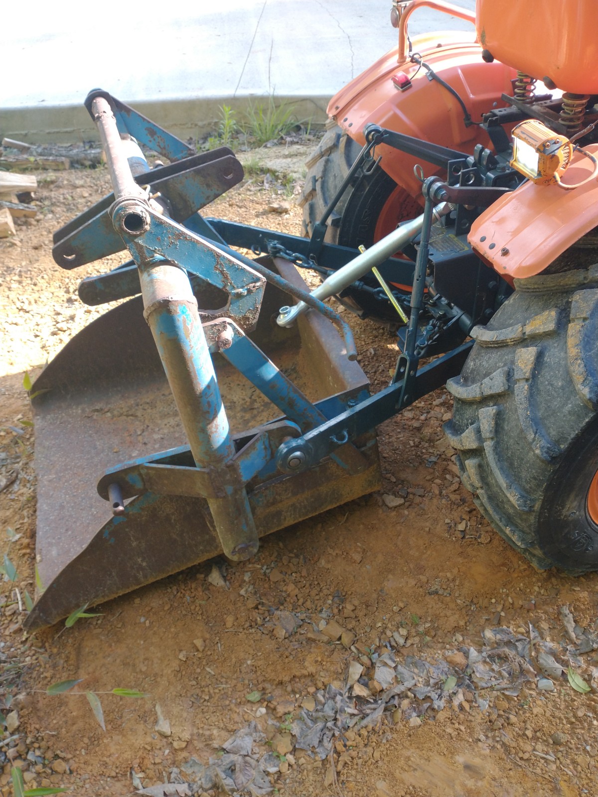

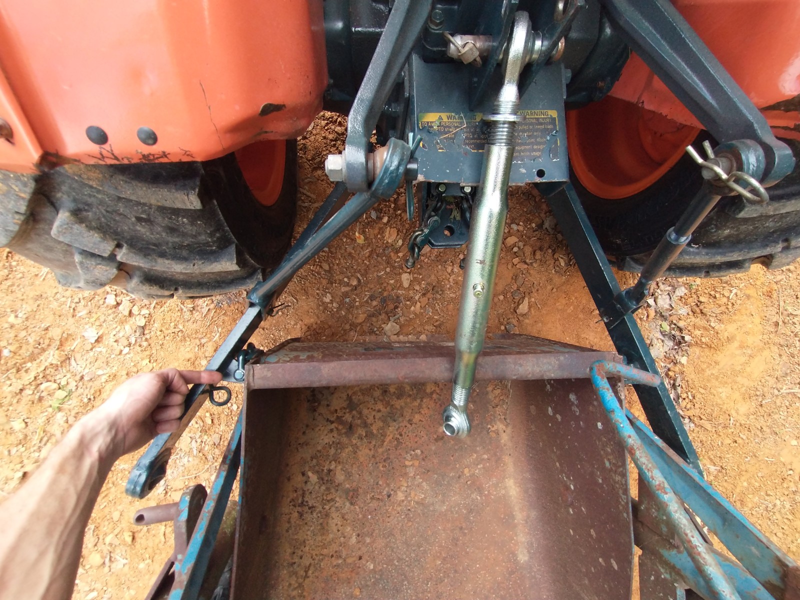

Back to my pond scoop struggles... I THOUGHT all the extra width would make it work. The scoop pins are about 36" wide at their widest. I got my lower arms to expand that far BUT.... take a look at the pictures of the new issue....
The connection for the check chains hits the bucket of the scoop!
Maybe this thing really is just too big for my lil 7100 haha.
I'm probably going to look for a smaller one - or MAYBE the offset lower lift arms would help in this scenario?

looking at your pic of the scoop, on the lift arms, can you move the linkage from the lift arms to the outside to gain further angle ?, i am no tractor wizzard here, just asking if you can reverse the lift pins, move the linkage on the lift arms at the top, and have them attach to the outer side at the top part of the lift arms ?. seems like it would give you more of an angle to get the scoop pins attached..i'm not sure if this is a plan or not ?..just guessing here..lol.
That's a darn good idea! I actually just went ahead and picked up a smaller used scoop a few days ago. Haven't even had the chance to take it off the trailer and try it out yet - but it looks like it should work much better.
Hopefully some updates over the weekend! Might be moving some driveway gravel with it heheh.

hope either one works for ya !. it was just a thought that crossed my mind when i looked at the way the top of the links were attached to the lift arms, seems like you could reverse the pins on the lift arms, then move the links to the outside, then this maybe would give you move of an angle so attach them to the scoop pins ? . let us know if this works better ?!. have a great weekend !.
