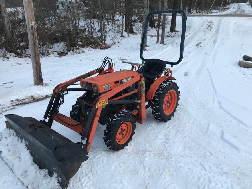

I was lucky and found someone selling the loader of his b7x00 (clamshell bucket too!). Paid $750. Built a subframe from drawings off the net (i can post them if you need) And plumbed a feed/return hydraulic line. All in for the loader was about $1000CAD.
Done and done. Made my b6100 so much more useful!
Then i had to build a all-in-one weight/tow hitch.

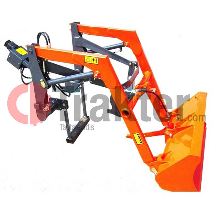

I am not sure if there are imported Chinese/Turkish loaders imported your way. If you run some searches they fetch around 2000Euros + taxes here in Malta. They have the square looks too and come with a subframe - which is not always as heavy duty as the Kubota meant it to be. The company in the link is based in Greece and I used it in the past for parts when rebuilding/refurbishing my b7001 (grey model). They do have a loader which is quite nice but the subframe looks weak when compared to what was approved by kubota back in the days.

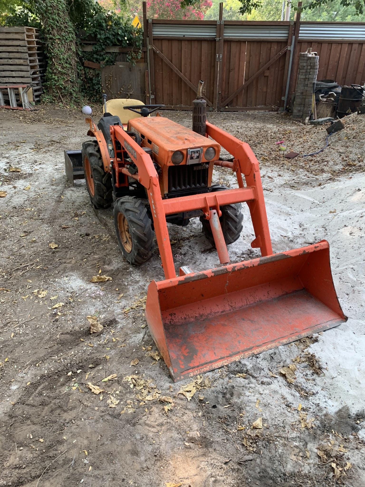

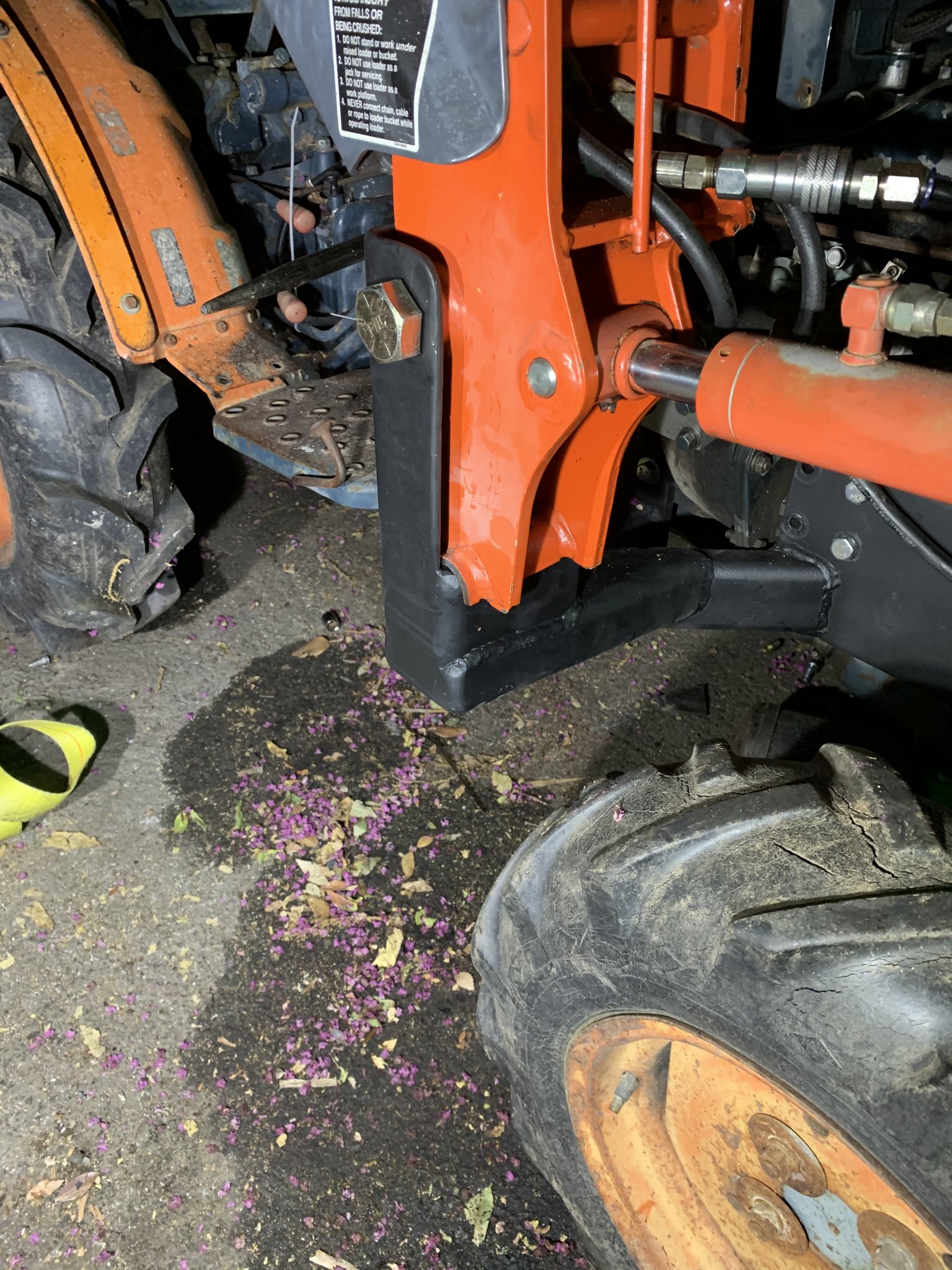

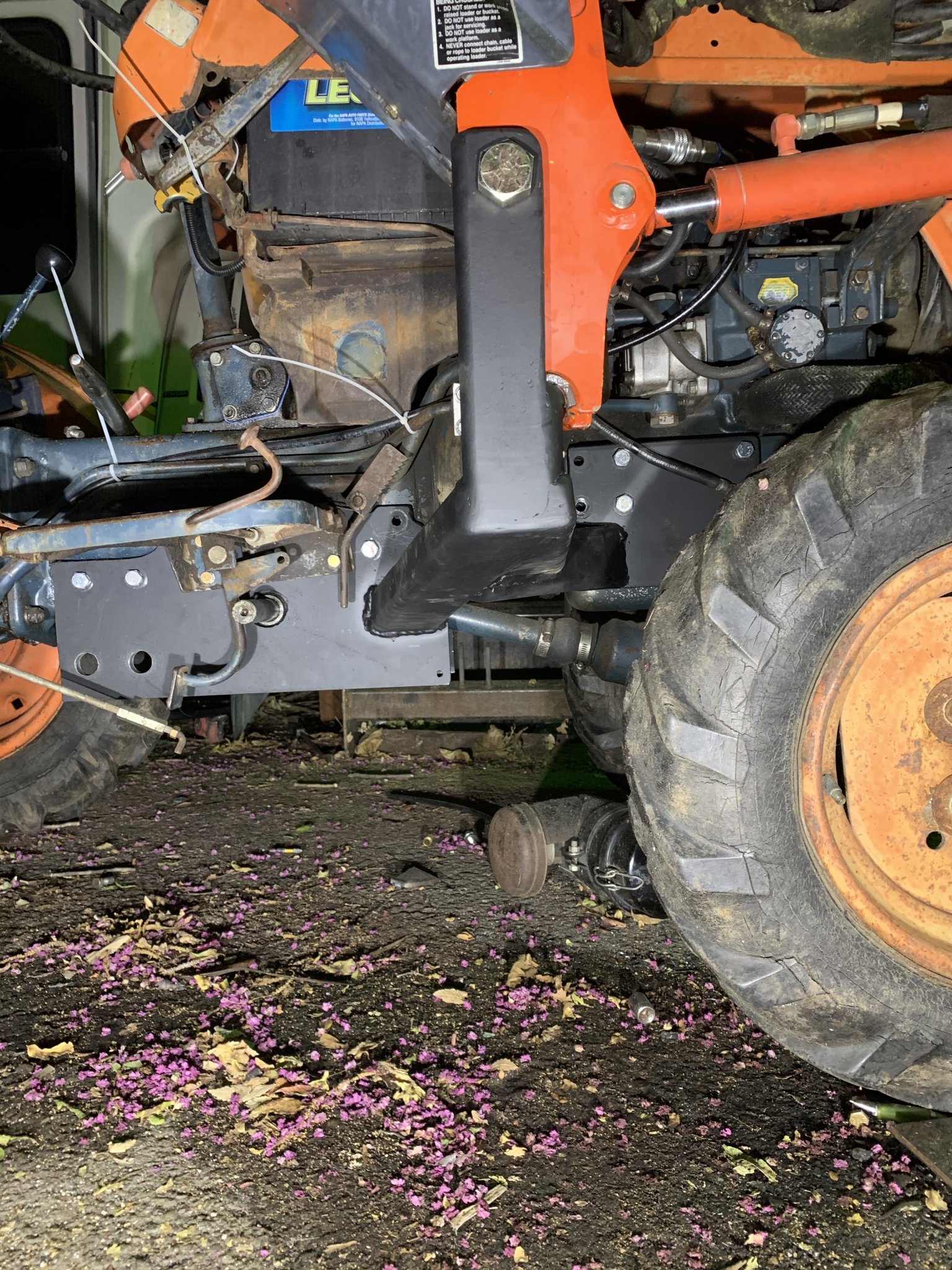

I just finished up installing a LA211 FEL on my B6100 4x4. It a great unit with modern 4 way joystick. It’s a tight fit, but fits the size of the tractor perfect. It also is quick release so it only takes 10 min to take off. I have to remove the air filter and the muffler but it’s only 6 bolts. I made stencils of all the plates and braces I made for the sub frame. Let me know if you are interested. First step find a loader. Stay persistent it took me 8 months but I got mine for $1100 with no sub frame. Enjoy the hunt!
