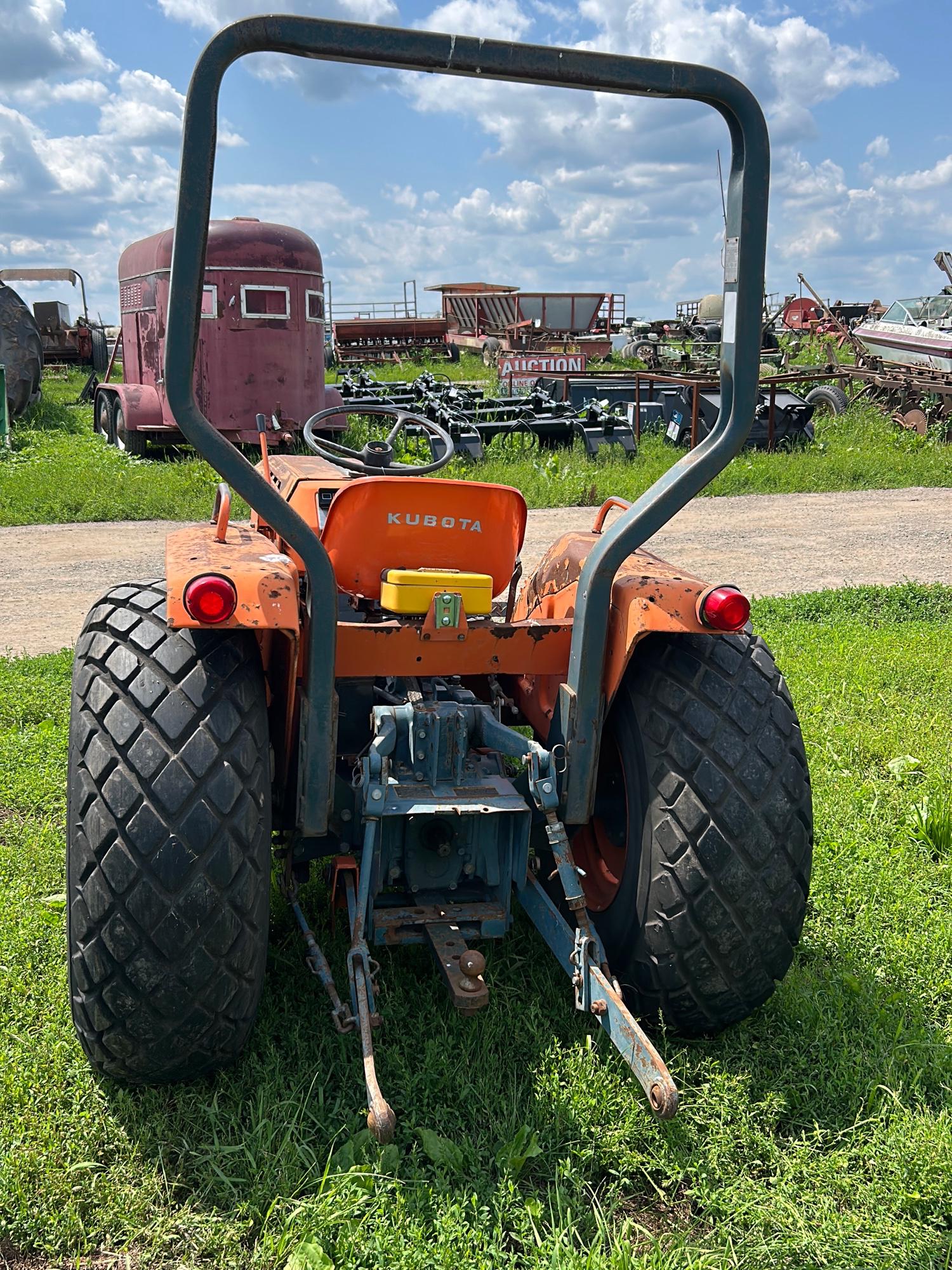

Thought I would introduce myself as a first time owner of a tractor. Just bought this B8200 for an old hillside tobacco farm in VA.
My first job is to get a rotary cutter/bush hog to maintain the cleared parts of the property. But I don't know where to begin with regards to PTO shaft length and configurations. Are PTO shafts all universal?
As a newbie here, please let me know if there is a particular forum for my model or for new guys. I've got a lot to learn,
Thx

Being that you are steep terrain, and if you are very concerned of roll over; Get a ROPS, or have a roll cage welded on with bolt removal points. If you don't need the loader and are only brush hogging with the tractor; Maybe take the loader off completely and sell it. Many will want it and it raises your center of gravity.

My son and sort of bought it together. He bought the big trailer and I bought the tractor. He wanted the bucket, I didn't but after using it just for a few minutes here in Florida, I cleared up a bunch of storm damage in a hurry.
I looked to see where a ROPS would bolt on and only found holes in the fenders. Seems like it would need to mount to a frame or transmission or something more solid than sheet metal. Thx.
