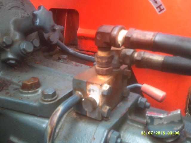

So I examined the hydraulic system to understand how the diy grader blade units 3 spool valve had been combined into the system. The pressure hard line from the pump crossed over the tunnel just behind the tranny and there is a block mounted right on top of the tunnel (do not know if "tunnel" is correct nomenclature so correct me if I am wrong). There is a hard line exiting the block and connects to the rock shaft cylinder housing to supply that unit. On the side of the block there are fittings with soft lines attached.... those lines were pressure to and return from the 3 spool grader blade set-up. Those lines did not quick couple to the 3 spool valve but the quick attach loader I have is quick couple so I decided to to put quick couplings on the supply and return lines for easy hook up to loader valve which is a wobble stick.
This system is open center so..... oil must circulate through system constantly. So when I observed the block I wondered if the grader blade system and the 3ph system were in series .... OR was that block a divider valve. I assumed the block was a divider block and if so I would still have oil free flowing through through the 3ph system even though the grader/loader circuit would be closed when valve was removed !
Oops ... that assumption was a big mistake by this wannabe mechanic!!! Block was not a divider but just used to break into system .... so now I know the grader/loader system is in series with the 3ph system

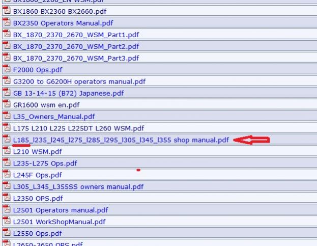

Rather than answer your question I am going to suggest some homework.
Go to this site and download a free Workshop manual for the L185.
Start reading at page 52 out of 63 pages total. This will help you understand the basics of the L185 hydraulic system including its position control.
http://kubotabooks.com/AutoIndex/index.php?dir=Tractor Owners Manuals/

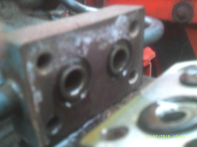

From your photos I think you have the optional hydraulic block which was called a power beyond block by some. The L185 WSM dos not mention the optional hydraulic block
I have provided info from the B7100 WSM on the block because it likely is similar to the one you have.

#1 STOP using air pressure to test anything on this system as it will do damage to valves, seals and such.
#2 Pull the block off and give detailed pictures of it.
I think I know what's going on but need to see the inside of the block to confirm this.

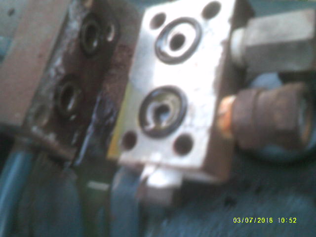

Took block apart and examined. I do not know what a divider or a power beyond looks like internally but I can tell you this is neither. I am a bit of a machinist and I can tell ya how it was made.... I am more of a machinist than hydraulics mechanic:)
The two halves were faced and circular grooves milled in them to support O rings. Holes were bored into each end of the rear half and two holes bored into the top of the front half and an additional hole drilled into the side for inspection or to drain. Holes were tapped for fittings. Smaller holes drilled into faced halves at center of grooved rings.
This block functions to ad another valve in series to the 3ph function.

From the side plug does the hole go through to the other side, that's why the side plug is normally in there.
Sometimes someone alters the original block and plus an internal plug in there to block the cross flow.
What you want is a path from port to port no matter how you have to make that happen. ;)
I examined it carefully but will re-check. If there is a path from port to port then oil will take path of least resistance and will not circulate through the auxiliary valve which in this case is the loader valve.
Dave directed me to a B7100 schematic of a power beyond. If you go there there is an original condition where the half block directs flow from port to port. Then in the second condition the half block is removed and replaced by a second block which he states is a power beyond. My block looks like that second condition..... but IMO that second block functions to put the auxillary valve in series with the 3ph valve.
I will recheck everything tomorrow but that side plug looks like there to drain the block and nothing else.
