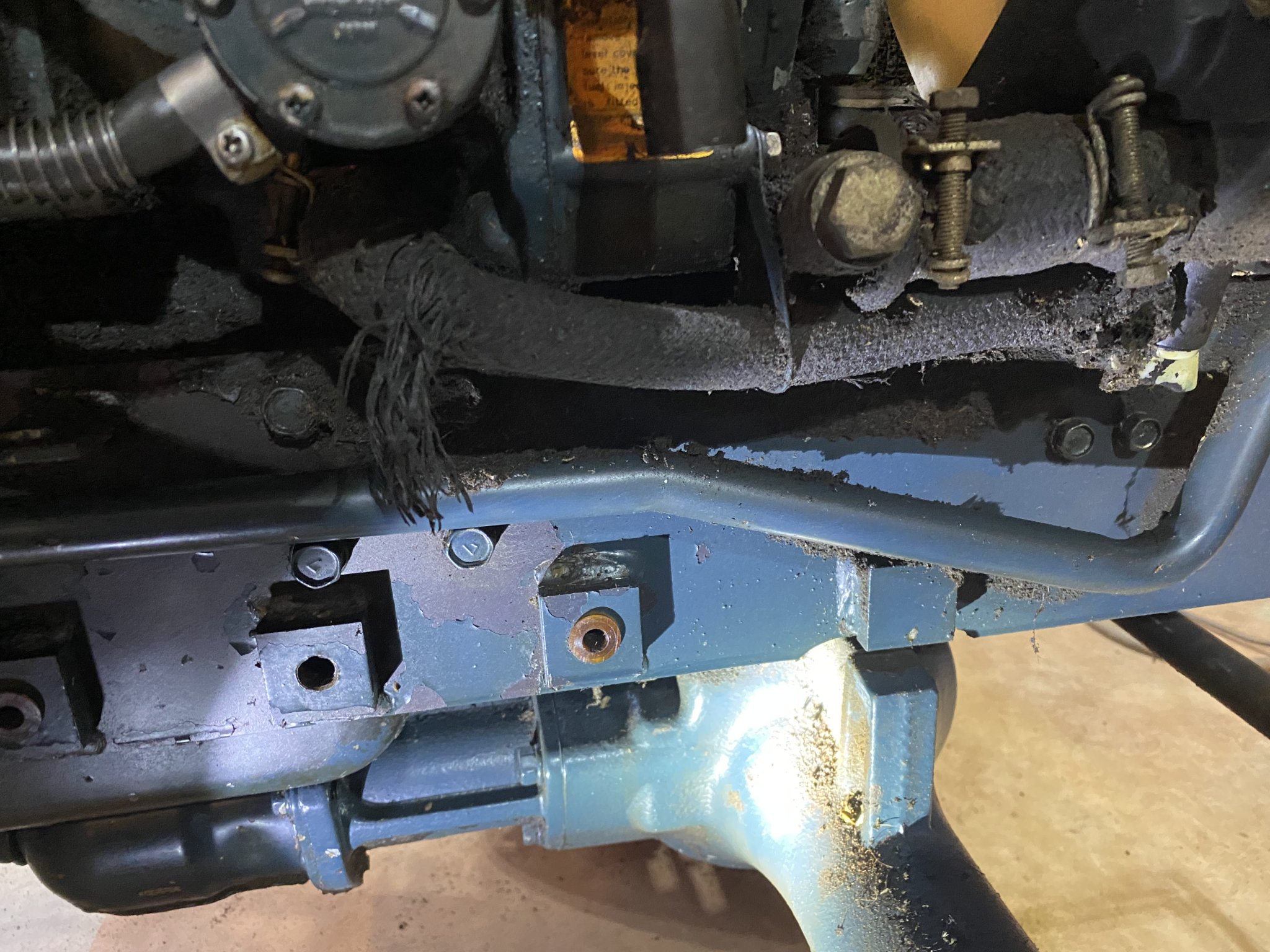

I want to replace a ratty looking radiator hose on my Kubota B8200 that does not show up on the parts list. Can anyone identify the hose in the attached photo? It is the one with the deteriorating stringy looking threads that goes from the bottom of the engine horizontal to a connecting tee just above the radiator drain valve. Thanks

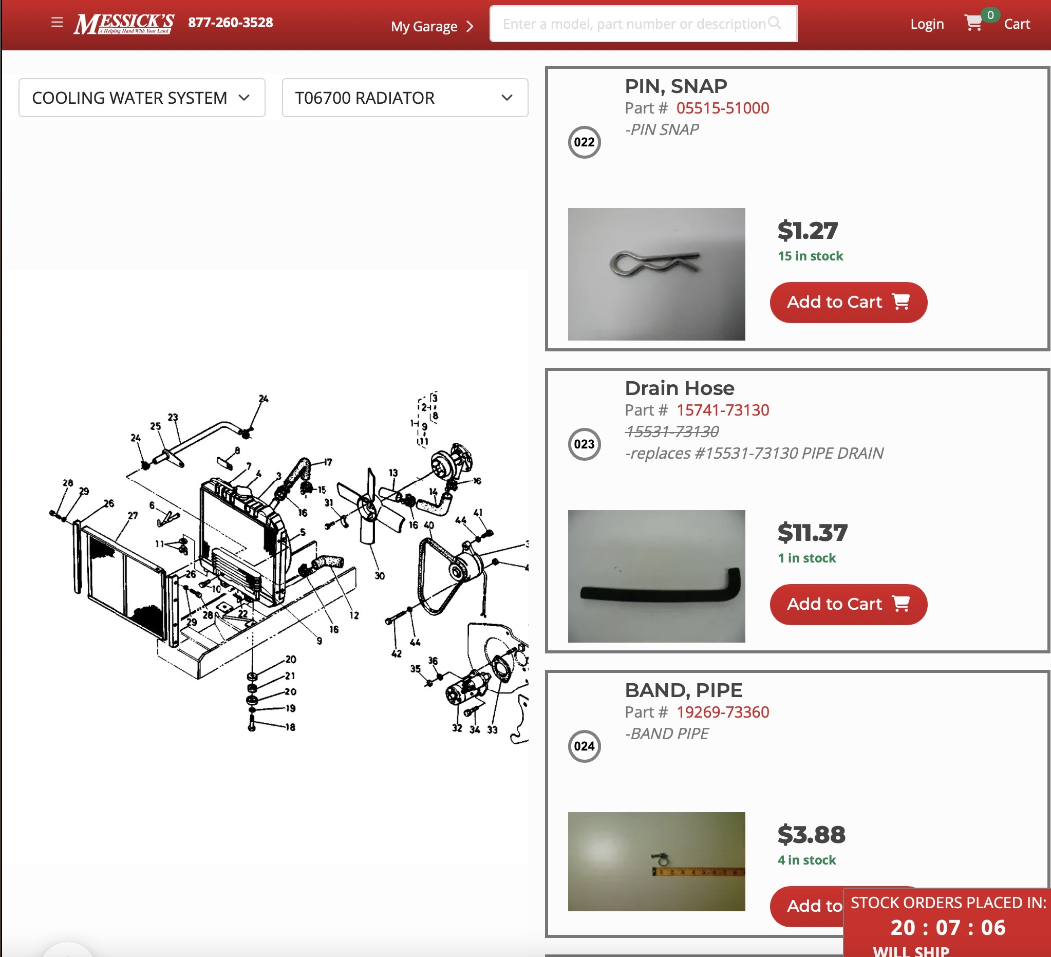

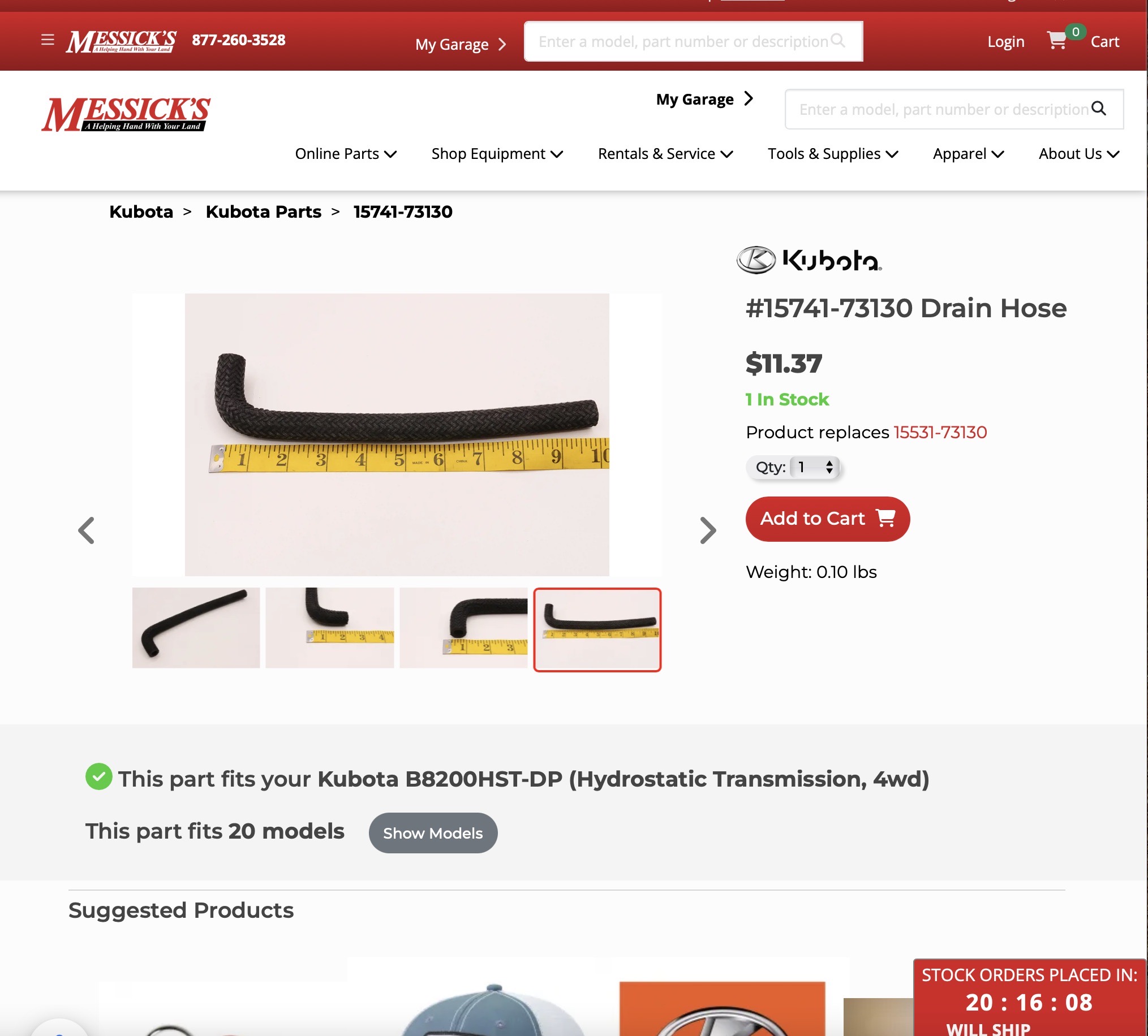

I THINK this is the hose your looking for.
Part number 23 in the exploded view.
Runs from the block , thru that hanger bracket and then to the Tee with the drain cock on it?
As always double check before ordering.

That looks like a standard molded heater hose unless it is for oil, then it might be made of an oil-resistant material, and Kubota only part. 90-degree molded hoses are carried by most independent auto parts stores, but the chain stores might not have them in stock but can order them.
