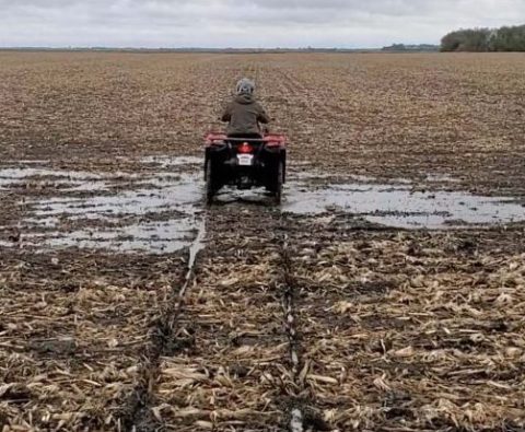

You can also crisscross the land with drainage pipes about 18" below the surface and direct it to where you want it to go.

There is a method using subsoiler plows to provide some drainage to prevent pooling. In some places a steel “mole” is pulled along behind the plow to open up a drain.
It may be difficult to do in rocky soil.
