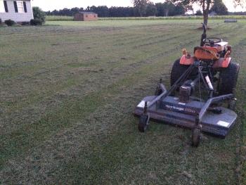

My woods rd 60 mower is clumping up the clippings between the rear wheels of the mower. It is a rear discharge deck that should discharge all across the 5 ft opening at the back. All the grass seems to come out in a section about the width of the center blade. The grass is dry and I am only removing about 1 inch of grass. The blades are new OE blades. Correct part number is stamped on them. Tractor rpm or travel speed has little to no effect on clumps. I also have changed the height bushings on the rear to see if that would help I saw very little change. I also tried mowing a section without the rear chain shield. It looked better with the chains since they helped knock down the piles. Woods refers to these blades as "high suction " I'm wondering if that means they try to keep the clippings sucked up under the deck? The yard looks great after I run my sweeper over it. The grass has a uniform cut except for the piles of clippings.
I also cut a section with my old John Deere with side discharge belly mower. It had no problem cutting the grass and throwing the clippings so I don't feel like I'm trying to remove too much grass at a time. Even in short grass areas the clippings stay in the middle but it is a smaller pile.
Any thoughts?

Sandy Bottom North Carolina
I did some more research on the mower today. I stopped by one of the dealerships near where I was working. They sell land pride and woods. The service manager was a huge help. We tested out a a rd 60 like mine and a prd 6000 ( the heavier version of my mower) and a comparable version from land pride. I forget it's model number. Their rd60 has the same baffle set up as mine and made the same cut with windrow. The prd 6000 and the land pride scattered a more even pattern. He gave me a copy of a template they had made to fix a few of these mowers with my problem. Basically I am going to have to weld in some plates to extend the baffles so the blades are running separate from each other. That might be a job for this weekend depending on my schedule. Cat, I did check the angle of the blades. The front is about 1/4 inch lower than the back. The service guy gave me a set of blades to try. They are gator mulching blades designed for the land pride. He said they would help but not fix all the problem. He was right the windrow grew from about 8 inches wide to almost 2 feet wide. He said after I fix the baffles I should get a more uniform scattered pattern behind the mower.
Steve NC
B7100D, L2900DT, ZD21, G6200,
Dec 29, 2014
89
The photo was taken after installing the gator blades. I can't find any currently made for a woods. The land pride blades are the same length and center hole size. Only difference is the have a little more offset to them. Also discovered another source for parts for this deck. John Deere uses this same mower. They paint it green and call it a frontier gm 3060.
