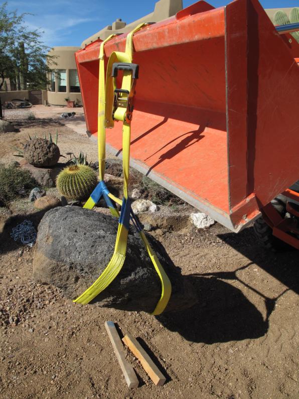

I just loaded my smaller ones into the bucket and the bigger ones I slung.
For the smaller ones, I found "hiking" them (like you'd hike a football) to be the easiest. For me at least, it doesn't strain any one muscle and after 300 moved, I don't have any lingering damage for a 60 year-old fart.
The 300-700 lb beasties I slung using straps from HF. Without a picture I am not sure what you are up against.
Here is the sling that I used...
Moved the biggest one to date this weekend. The loader would get it about 12" off the ground and no more. Hauled it to a far away location for later use. Wanted to "block" the underside for easier slinging to the final location later so I saw a flat rock and reached down to grab it. As I started to pry the 12" diameter slab off the ground I saw that unmistakeable diamondback pattern and recoiled. It looked like a pregnant female, about 30" long, still asleep as it was fairly cool overnight. Baby Rattlers are the most dangerous because they cannot control their venom. It unloads, where a mature snake may not waste any venom in what is known as a "dry bite." I used to haul them off but Cave Creek is not exactly unpopulated so this snake got fed to the birds. And, I am now on high alert for the next 6 months.

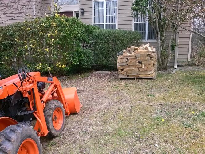

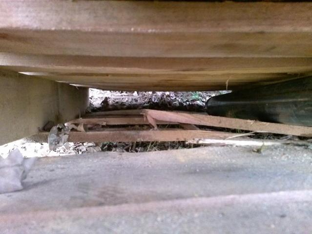

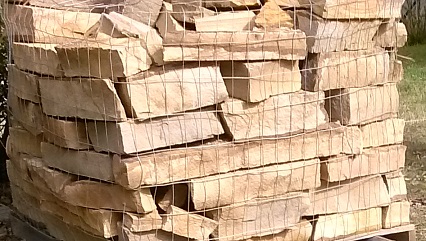

So, in terms that 85Hkioe will appreciate, here's an image of the "challenge"
Note that moving the Objective is not without Obstacles. And note that there is a Fall-back, but the color suggests how that route would be viewed.
The second pic, showing the face-off, doesn't include the Japanese plum tree (one branch coming into the picture from the right side) that presents a serious obstacle to sliding the load around the corner of the house and down into the back yard. Also, from this viewpoint, the Piranha bar isn't noticeable, so the rocks being in a jumble might be a puzzle.
The third pic shows the Main Event: Mighty B6100 vs. old broken-down rocks. Sadly, the rocks just sat there, so it was no contest. (Don't you hate it when they don't play fair?)

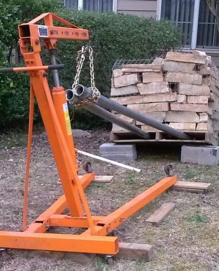

That was my next effort. Actually, I started to use 12' 2x10s but settled for 10' 2x8s since I had half a dozen of them, and only 2 2x10s. They were exactly 3" thick when stacked, and I had to use a maul to drive them into the pallet. They weren't strong enough, and broke.
I considered buying a sheet of 3/4" ply, ripping it to 3", laminating it into 2 3x8s. I believe that would have been the strongest beam I could get -- but only 8' long. As it turns out, your original suggestion for length is just about minimal.

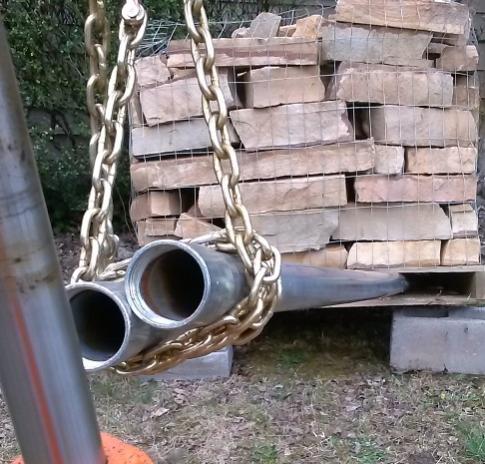

I got a couple of 2-1/2"ID 10' pipes (just over 1/8" thick) and used an engine hoist to lift it. Worked, although the pipes flexed a bit and made me wonder if it would collapse.
Tomorrow hope to get the back side up (no room for the hoist, it'll be a challenge) and get some beams under it (per your original suggestion) and try to drag it around to the back. I'm more confident about that, which is pretty silly -- the B6100 spins its wheels just climbing the curb from the street to the lawn. The puppy has no weight, so the brute force of those 14 horses just don't get properly applied.
