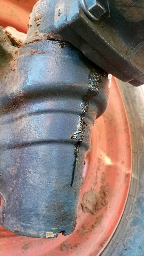

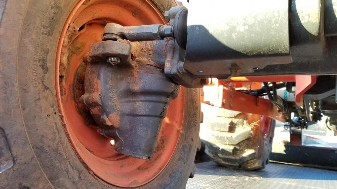

Alright, gents...where to begin? It's just a dribble but I know these things don't tend to heal themselves. I've seen lots of references to the commonality of axle leaks but no guide on what it looks like during the tear down. Do you happen to know of any? I've replaced lots of seals on brush hogs and other implements, but nothing along these lines. Any general tips or advice before I start unbolting things and making a mess?

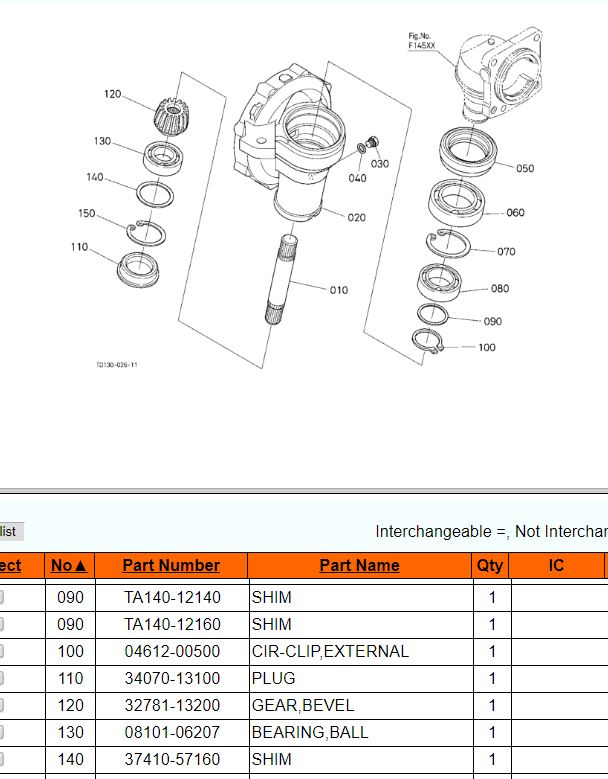

I've gotten through the biggest part of my pond project where I needed the L3940. Now I need to get the supposed bad seal.
Can anyone please be so kind as to help give me just an ounce of extra confidence that based on where my leak is that I need the 050 seal listed on this parts drawing? I know for some of you that have been there done that there are often words of wisdom around "if you pull off that cap you'll bend it and need a new one so you better just go ahead and get it now."
Thanks so much, gents.

I was kind of afraid that might be the best advice!
Looks like 110 is officially a "plug" but I guess the idea is the same...once you're in there take care of what needs to be taken care of.

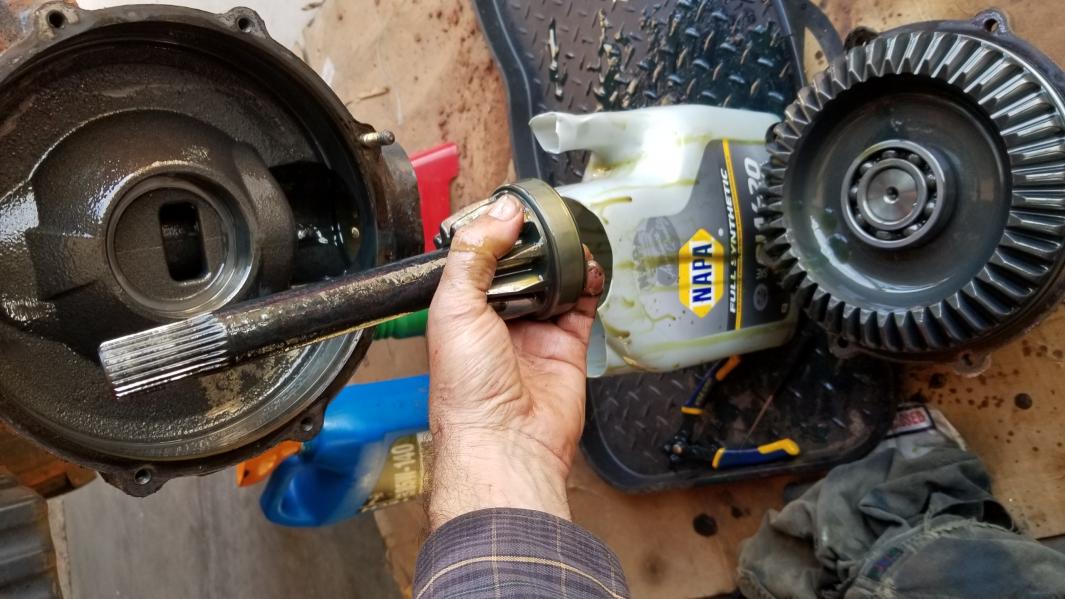

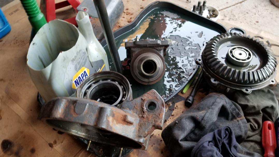

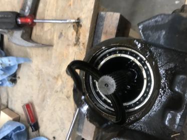

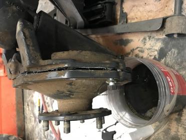

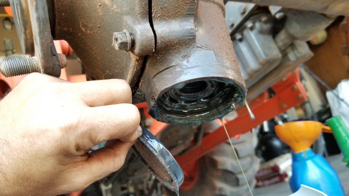

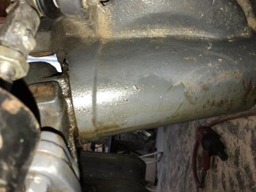

Well, the deed has been did. Most of the project went great EXCEPT FOR TWO SNAP RINGS that made me want to lose my religion (I didn't, in case you were wonderin'...HA!). My crappy little snap ring pliers have since been retired and the next day I bought a new set off Amazon.
For posterity, I'll put these pics on here in case some future guy or gal is searching and looking for information. I'm reasonably mechanically inclined but still have a hard time getting started on a tear down I've never done before. Maybe this pics will help someone else. The more frustrated I got, the fewer pictures I took!

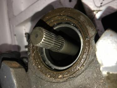

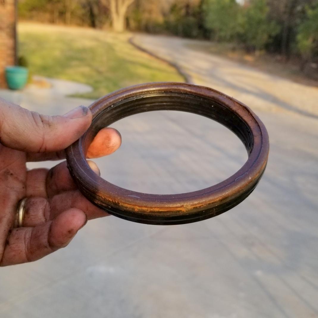

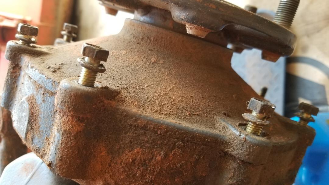

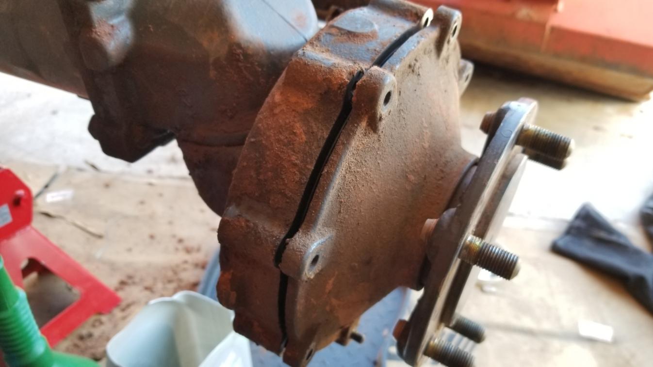

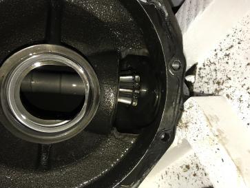

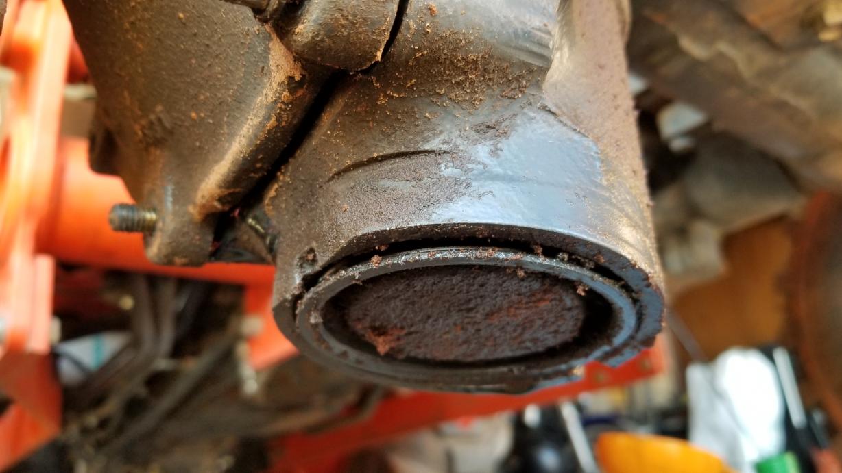

A few more just for reference. I was fortunate that nothing was in a serious bind. I had to beat on the old seal pretty well to get it out but other than those ornery snap rings, it was pretty straightforward.

sgt great pics!! I just did the same repair on my B26 TLB very similar except mine doesn't have a Cap on the bottom. I needed to separate the case to access the circ clip and then was able to tap the housing loose and expose the seal. My seal didn't come loose as nicely as yours though. I never really did any such work on my tractor before but I got a quote of $450 from my dealer to do this :eek: So I said I gotta learn this stuff somehow. I say all in all it took me a bit over a hour and $60 for parts. The bulk of my time was into cleaning the old sealant off of the mating surfaces so I could apply the new sealant.
