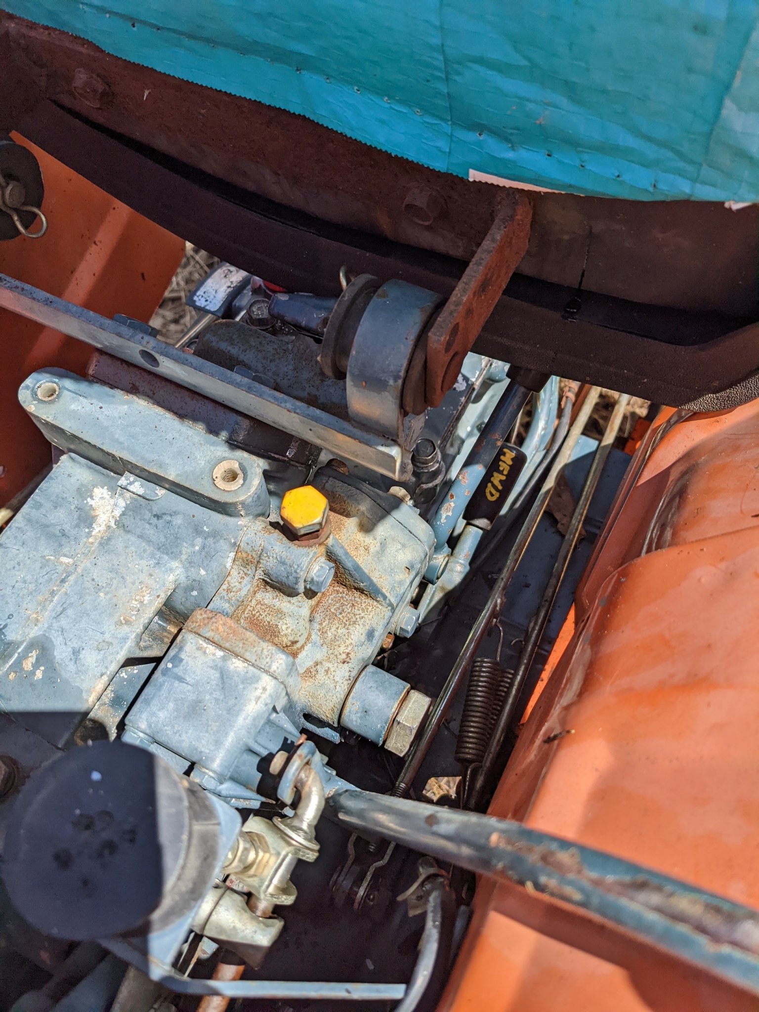

Under the seat, right side top by where the 3pt pressure line comes in and the diverter accessory valve is located is this bolt painted yellow from the factory. It has a lock nut on it so it seems to be an adjuster for something. I'm guessing its a pressure adjustment for the the 3pt lift?

That guy controls your rate of descend of 3 point - in slows in down, out makes it drop faster!
