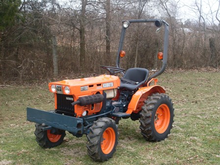

I just put the finishing touch on the winter paint job project on my B7100 and thought I'd post some pics of the results. I started by soaking the old girl down with Awesome cleaner /degreaser and pressure washing. I then removed all the sheet metal panels and did the Awesome treatment to the individual parts to make sure I got all the grease and dirt off then scuff sanded with 220 grit paper using scotchbrite pads in hard to reach areas. I picked up a quart of Valspar Kubota orange & hardener at Tractor Supply. I had originally planned to do a rattle can job but figured it was going to cost a lot more. I couldn't find the original Kubota Blue for the frame in the Valspar or any other brand so I bit the bullet and shelled out the cash for the OEM Kubota Paint. I later found out the hard way that the OEM paint won't thin with naptha which is what the Valspar is thinned with, and must be thinned with acrylic enamel reducer. I didn't have any, and decided to try to spray the blue without thinning!:eek:. On a positive note it did minimize overspray! On a negative note the finnish wasn't the greatest with some orange peel on areas such as foot rests. I wasn't too concerned because I wasn't trying to make a museum piece out of it anyway! After all it was my first attempt at spray gun painting:confused:. and I hadn't exactly invested in quality equipment. My spray gun was a cheap (less than $20) gravity gun from Harbor Freight. The orange proved to be much easier to spray since I had the proper thinner and hardener and I was very pleased with the results!:D I finished it off with a complete set of new decals and emblems, new headlights, and a new seat!:cool: First I will post a before pic and follow it with a couple of afters! Hope it works!!:confused:
Oh by the way don't try this at home unless your an Orange Addict because everything in my garage that wasn't tarped got a Kubota Orange dusting!:eek: Fortunately I was forewarned and had placed tarps and drop cloths over most everything! I even accidentally dusted my grandsons John Deere pedal tractor and considered finishing it off in Kubota Orange but decided he might not like Papaw messing with "his Tactor "!:D So I wiped it down with thinner instead!:rolleyes:

John, that is a really great job you did! Also thank you for posting the good story. It's a quality post :cool:

John C., You did a nice job :D! Way to go. I like that BEAST of a front bumper :eek:!!!

It's actually dual purpose, bumper/counterweight and it's made out of two peices of railroad rail that I found buried on private property near the railroad tracks in a drainage ditch there is no telling how much more of the stuff was buried there the local electric company had just excavated across the drainage ditch to install underground primary conduits and they had hit several peices and left them sticking up out of the ground I managed to lasso one with a choker chain and used my 4wd pickup to pull it out. It ended up being just short of ten feet long. It didn't look like the right size for what is currently used and after cleaning it up I noticed that the web was labeled Carnagie Steel and dated 1898. The two pieces stacked and welded weigh just a shade under
100 lbs and works well to keep the front end down when the bush hog is raised. It's also handy to push over saplings so they don't scratch my new paint!

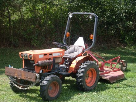

You need to hang the chains back on it like in the first, (before the paint job), pic. That looked Kool :cool:, (get it ;), cool with a "K" :p , never mind :eek:)...
