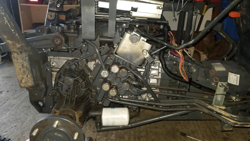

The rebuild is not without challenges for sure. At a young age I was taught that hard work is the answer. After 23 years in the Air Force during a time of war it was reinforced. I was able to watch extraordinary people do extraordinary things under extraordinary conditions. And for that I am thankful.
I still have some issues to solve, I can’t service the HST yet, some parts were lost in the rollover that I didn’t catch. There is a spring, ball and bolt used to hold the position of the 4-wheel drive lever that goes through the case wall. Also, a flange bolt behind the Mid PTO I didn’t catch. Both on order!
I will be extremely excited when she rolls under her own power.

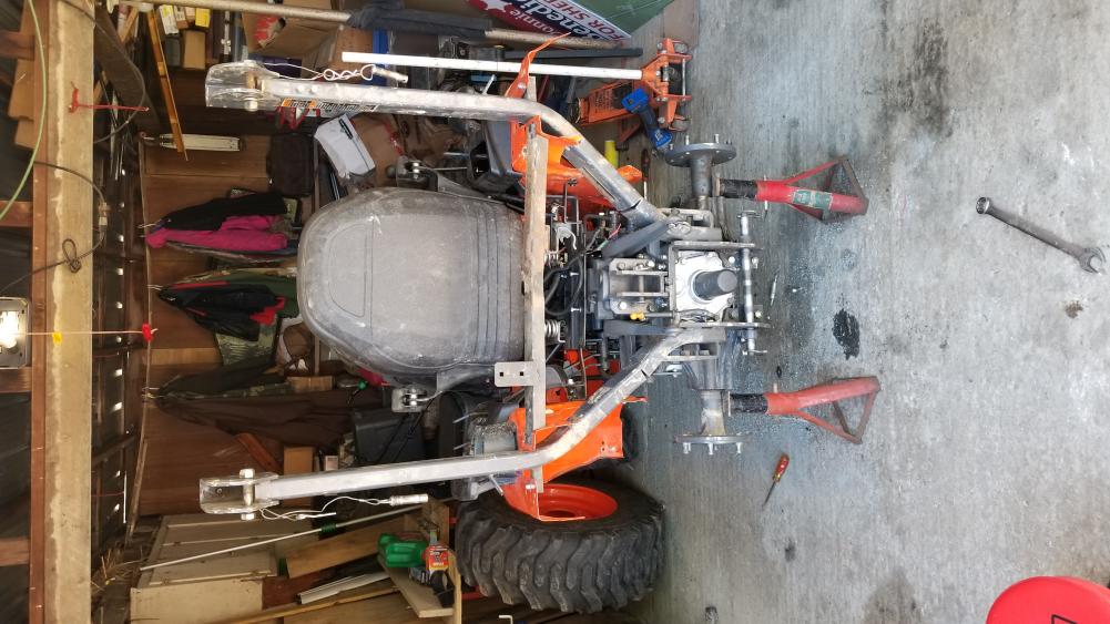

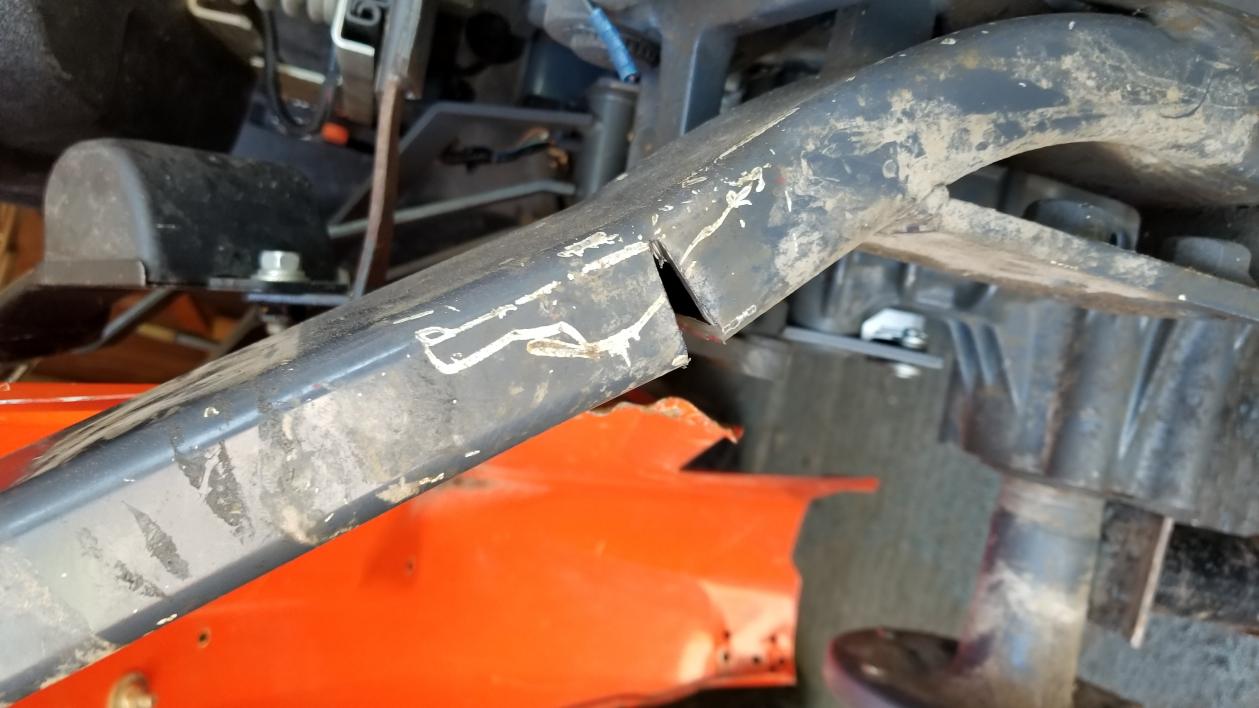

Well, the ROPS is bent just a little. :D:D:D
Not sure what I'm going to do about it. It has to be installed since the Lower links are mounted on it.
Any suggestions are greatly appreciated.
If it were mine I'd replace them. I know they are not cheap, but I sure wouldn't put any pressure on the housings trying to straighten them up. They will never be up to the task again after you modify them anyways. They are both bent at different locations looks to me.
14,264
6,457
If you're going to straighten them, I'd remove them from the tractor and bolt them to something like a backhoe bucket, then use some leverage to get them back into position.
whitetiger
Nov 20, 2011
3,113
1,543
Kansas City, KS
Once ROPS are bent, they become nothing more than a crooked light bar at best. Nothing to bet your life on. I would replace them.
14,887
3,906
Sorry my friend but they are telling you right,, I have investigated to many rollovers where the ROPS have failed. Sometime with nothing more than a couple of bruises and changing your shorts, to things I would rather forget.
You have gone this far dont get cheap with your safety,, a few buck saved aint worth it

you are really making good progress on this...
but id toss that ROP into the scrap pile & get a new one... you want this to be perfectly square, as you know your other stuff mounts to it.
Great advice from all of you. Sometimes we get stuck inside the box and fail to think outside of the box! I believe you all are right and to replace is the only smart long term option.
The ROPS were put on the tractor for one primary reason! If I were to mess with the integrity of the structure I would be putting myself at risk for sure.
I would never try to bend them while connected to the case! Aluminum verses Tube steel, The case would be at a serious disadvantage!
The other issues are, the fenders mount on the ROPS as do the lights. If the fenders are not right then the control levers will not be correct.
I think the only smart thing to is to suck it up and buy a new ROPS. I dont think I can buy just the left and right arms. That would be an option since I'm pretty sure the top piece did not change shape. It is broke down by each piece in the parts catalog but not priced that way.
Thanks again for helping me see it from the outside! :)

I think I can save the ROPS!
If welded properly it can be as strong as it was. Granted the steel has been stressed I understand, One thing to note is, I have 99.9% flat ground here. If the bucket is full and I'm turning I risk a rollover.
Let me here your thoughts, don't hold back! I can't think of everything so help me out. I know we can put a price on our safety also!

I think you already know the answer. If it were one of us what would you tell us? I realize it will be a fare chunk of money but what is your life worth or a chance of being disabled if something happens. I think you better think long and hard on this one.
33,131
8,524
I'll tell you the 2 bad things.
1: If anything were to happen (IE personal injury wise) a insurance company could deny the claim.
2: Every dealer will reject it for a trade in or require you to buy a new one ROPS at their cost not yours.
Yes, you are right! I start a new job after the weekend holiday so I will order the new ROPS!
Yes, 100% truth here. Big risk all the way around not replacing it. You pointed out two aspects I hadn't considered! I will get one on order in the near future. When I'm done I will publish a dollar figure on the fix.
