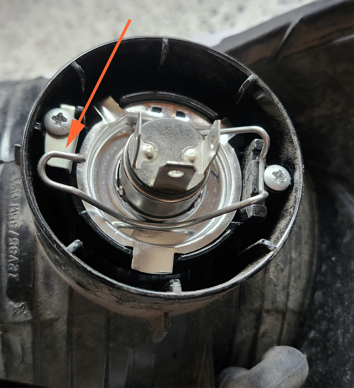

With the days getting shorter and shorter, I need to keep using my machine in the evenings. The factory lighting on the MX is quite weak. I have the front and rear factory work lights. They basically help light up the immediate area around the perimeter of the tractor but have no reach whatsoever. For example, I can see my implement behind me, but I can't really see beyond the implement. The ones on the front do even worse, since the hood of the tractor is ahead of the lights. So, I can see my front wheels but they really add nothing beyond the front of the tractor and only a little to the sides. The headlights on the MX are poor; shame on Kubota. They are an oddball Asian HS1 bulb, with dual filaments, 35 watts on low or high. Only the beam pattern changes, not brightness. By comparison, a typical car halogen headlight is 55w on low, and 60w on high. Also worth noting is that the Grand L 60 tractor series uses the better 55w/60w headlights. I realize the Grand L is a "premium" model while the MX is an "economy" model, but did Kubota honestly think just because a person bought an "economy" tractor they wouldn't need decent headlights?
Anyway, I previously owned a Grand L model, a 4060HSTC with the better lights. However, even it had the same awful cab mounted worklights. On that tractor, I upgraded the bulbs in the front work lights to HID bulbs with ballasts I concealed in the roof. They were considerably brighter, but I didn't like how they had to warm up to reach full brightness. Anyway, I just ordered a pair of TigerLights LED lights which fit the stock Kubota worklight enclosures...meaning the appearance is unchanged.
However, I'm quite sure that this will not be enough. Anyone aware of an HS1 bulb upgrade to an LED with more equivalent wattage? Will an H4 LED bulb work? I hate putting a light bar on as I think they look gawdy, but I might have to. Thoughts on lighting upgrades for this tractor?

Quick bit of googling says the hs1 is the same base as an h4/9003 bulb. You can verify at any big box store or auto parts store to be sure that is the case with an old one for comparison.
That being the case they are the standard 55w/60w that you are looking for. So an LED equivalent to THAT bulb may be what you are after. However, in my experience with all off highway equipment, it probably won't help much. Whether it be deere, cat, or kubota; wheel loader, tractor, utv, atv, fork truck or otherwise, it comes down to light housing design rather than the light source itself. For some reason which is beyond my pay-grade to know, they all just refuse to design proper housings which project the light properly.

I also noticed the H4 bulbs have the same connectors. With halogen H4's, there's probably a chance of melting the reflector housing / lens and / or the wiring because of the higher wattage. With LED's, probably not. I ordered a pair of Sylvania H4 LEDs, with the heatsink and fan and remote wire connector. Should fit just fine. I suspect you are right, though. The reflector was made for a halogen 35w bulb. These LED's will probably be way brighter, but the lens will scatter the light everywhere. I would never do this "upgrade" in a car like unfortunately so many people do, because of the glare to other drivers. However, I don't mind trying on a tractor. I think I will also buy maybe a small 10" light bar from a reputable brand to mount on the grille guard. Hopefully all these lights improve nighttime operation.

I have a set of the sylvania leds in my old dakota. Due to the design of the square housings having no top or bottom reflectors they work great with a sharp cut off line that keeps other drivers from going blind. They are brighter, but unlike some if the no name brands they were clockable and have lasted going on two years now with daily use. I think you'll like them.

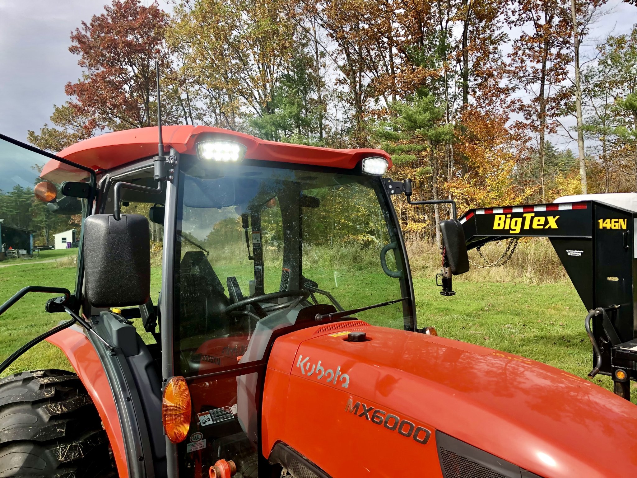

I just got the Tiger Lights which replace the factory work lights on the cab. I will install them today and use them tonight. They definitely look just like the original units, but seem to be made very well - they are heavy - and come in very nice packaging. Quite costly, but made specifically for Kubota.

They look good and are nice and bright, easy install. Not a game changer for night time mowing in a field, but certainly an improvement. The white light is nice and sharp. No radio interference.
