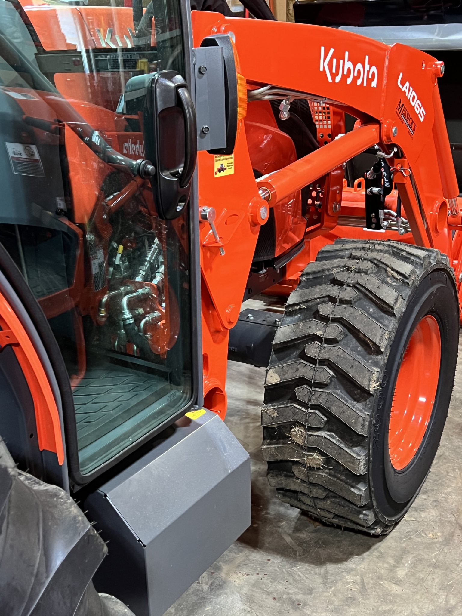

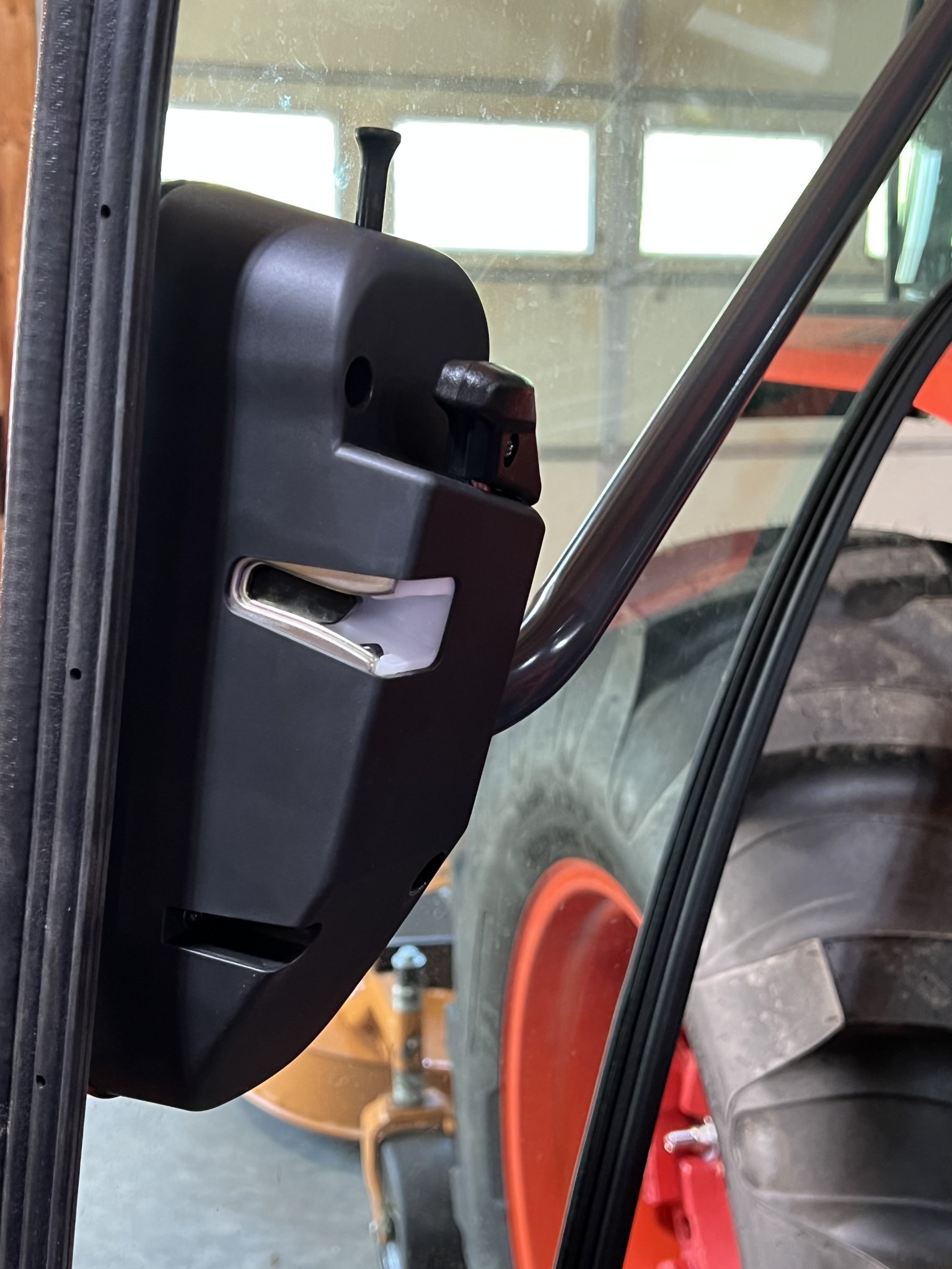

I just installed the right side door latch parts on our new MX cab model tractor I really think Kubota should have made them standard with these parts.

Couple pictures of the right hand door with a latch like they come with on the left side In my opinion these machines should come from Kubota with this door latch instead of the cheap garbage that they ship with.

I agree. The dealer is doing this to my MX6000 as we speak - I could certain do it myself, but its a brand new machine so they are doing it as part of the prep. I've also wondered about retrofitting the right-side step like the Grand L 60 machines have. However, they don't have the valve in the same place. Not as big a deal to me, since I don't try to get in and out on the right side. And keep in mind most of the competition does the same thing as Kubota...left side access only, right side emergency exit. I just think if you go to all the trouble of an entire opening glass door, why not make it easy to open from the outside?

I know Kubota doesn't want you to step on the loader valve cover and that's why they don't give you the right side latch but I just needed a better way to get in that side of the tractor to access the controls and the latch just made sense for me. It took me maybe 20 minutes to install the parts I think the parts are way over priced but it is what it is.
