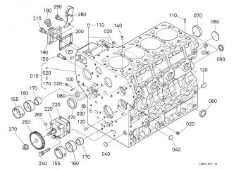

There has been mentions in here of freeze plug under the front engine cover in some models if I recall right.
maybe go to USA Kubota site or messics and look at parts break down of your engine in that area to see if you have one there too.

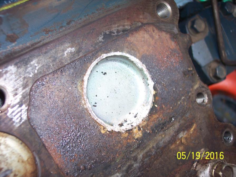

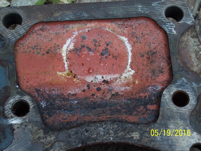

It is likely the plug in the front of the engine by number 1 cylinder
THANK YOU ED!!:D
A direct, no-nonsense reply like yours is VERY MUCH appreciated.
I can literally hear the water flow through the plug that you mentioned.
The visual aid was GREAT!!
Silly me, expecting it to be labelled "frost" or "freeze"... :eek:
Next time I visit Frog Lake, dinner is on me!
BK
13,211
4,628

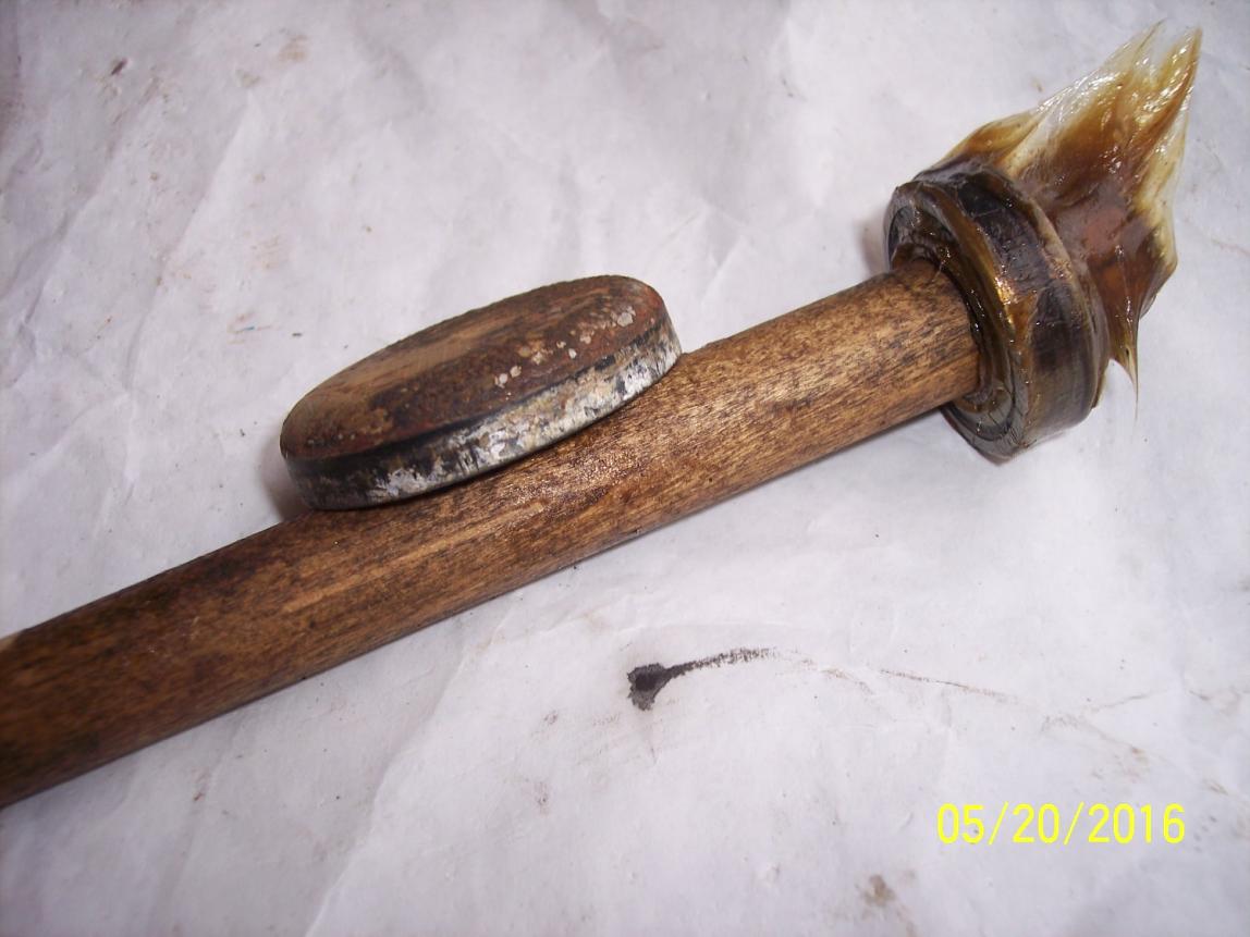

Be sure to get the plug from a Kubota dealer. Don't guess you can get one at the local parts store. There is too much detail work, and the price is insignificant to not get the specific one.
Depending on the diameter, find a socket or piece of round tubing that is near the same OD and drive it in squarely. Have the outside edge about 1/16" inch inside the block casting when done.
Always be careful of what's behind the plug and how far back it is. You don't want to do drill or pound the plug too far in, to cause a restriction.
The plug leaking shouldn't be too difficult to remove. Usually a vice-grip will grab the edge that has moved out.
