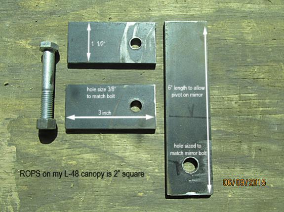

This is a simple add for those who don't want to drill or glue into the 2” square ROPS posts.
I used the material I had on hand including a ATV mirror I wasn't using on my UTV.

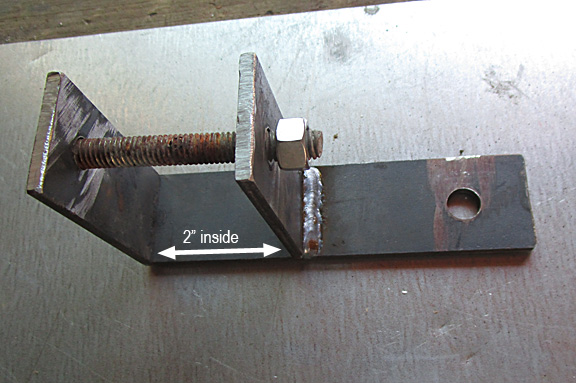

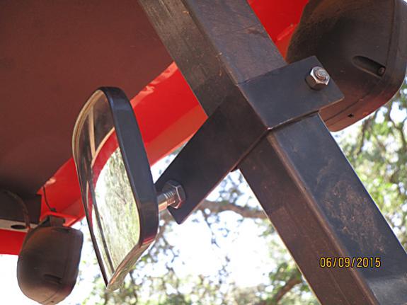

Basically it is 3 pieces of 1.5” x 1/8” flat steel welded into a “U” shape with one leg longer for the mirror attachment. The pictures say it better than I can explain.
If I had thinner gauge material I would have bent it into a “U” shape and eliminated the welding. The mirror weighs almost nothing and it would easily be supported.

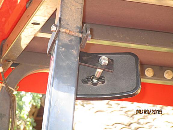

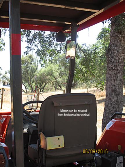

The attachment can be slipped high or low on the ROPS tube to suit. After playing with the position I prefer it high. The mirror attaches to a ball joint making it easy to rotate from a horizontal to a vertical position.
