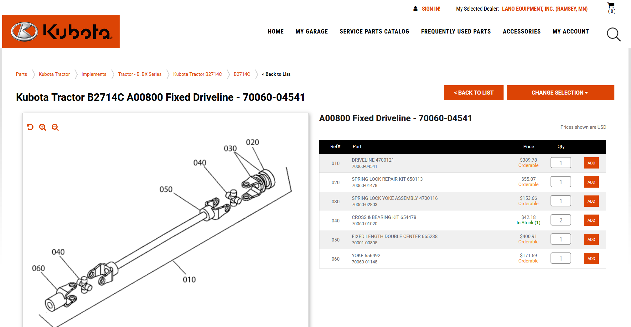

Funny, the service tech at the Kubota dealer told this guy that they (Kubota) don't sell the parts for the shaft, and only sell the shaft as a unit. When I looked on Kubota's site, I couldn't find the parts breakdown of the shaft and only the shaft as a unit.
I have the same set up as you B2714C & shaft #70060--4541

I will say this- I only saved a minimal amount purchasing all of the parts to build a complete new 70060-04541 shaft and paying a driveline shop to weld and balance the shaft compared to if I had bought 70060-04541 whole from Kubota. You can see the whole shaft is priced at $389 from Kubota where I came in at about $340 all said and done.
Kubota's pricing for individual components is nuts though.
