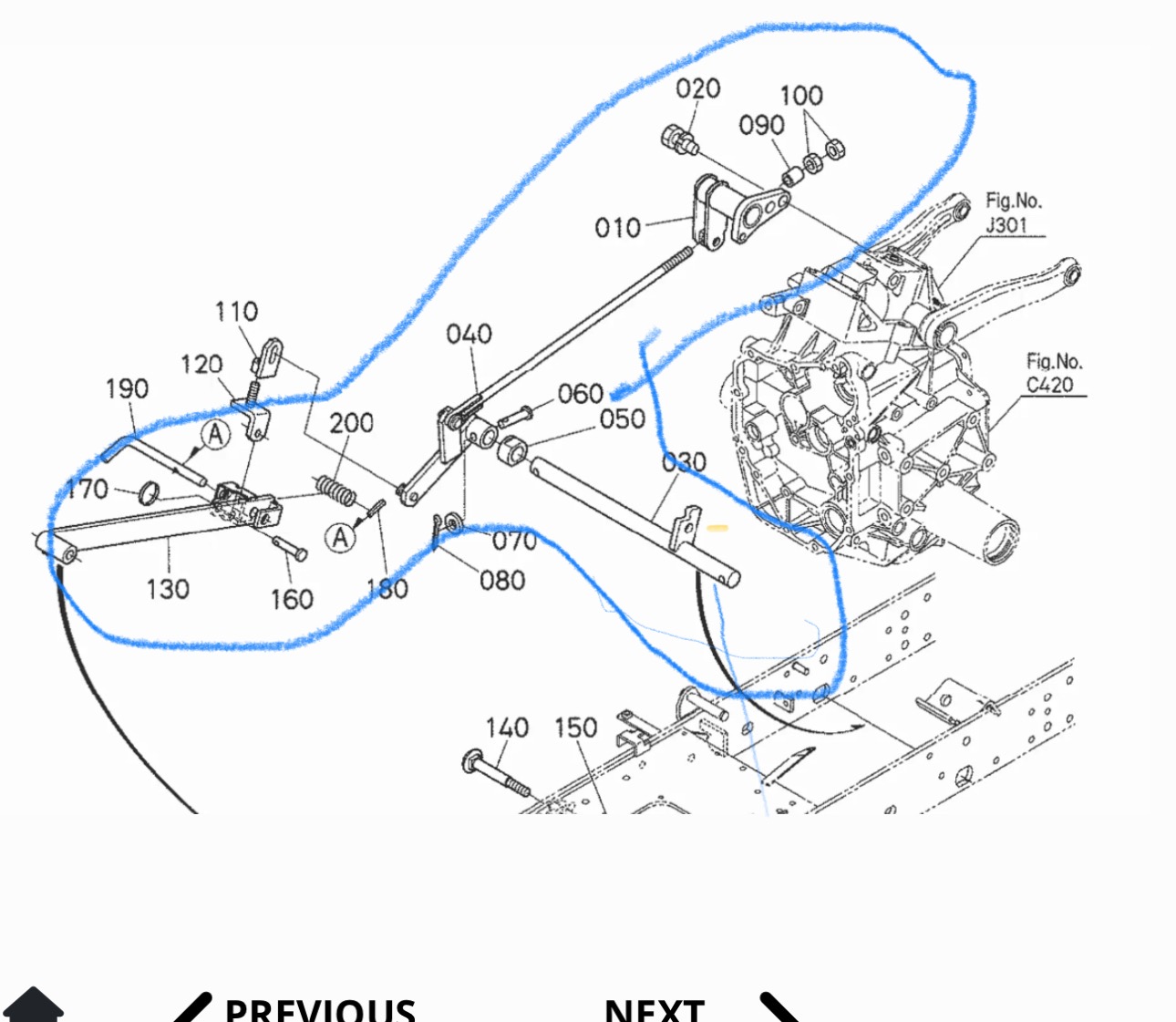

I have a BX 1500 and today went to drop the mower deck to sharpen the blades. I turned the height wheel to 0. Lowered the 3point. However the mower deck only moved a couple of inches. After fussing around I got the deck off the tractor.Not sure how I’m going to get it back on.
Looking at the 3 point mower deck actuator rod it appears to be moving freely. Under the tractor the cam that engages the height castle is free not hitting anything. The cross shaft rotates up and down but not fill range. The ends move about 1”-2” it should move a lot more. I tried a bunch of things including putting my full weight on the deck mounts.
Any thoughts on what to do here?

No I checked, the pawl on the shaft is not touching the cam and is lined up with the deepest notch. I am contemplating dis assembly of the whole assembly. There are no grease zerks on the end of the shafts. I’m leaning towards corrrosion.

I found the problem. The lift shaft on the right side of the tractor has rusted to the frame bushing.

I soaked it overnight and no dice, rusted solid. Too bad it didn’t have zerks to grease to prevent. Looks like I’m replacing the shaft and bushings.
