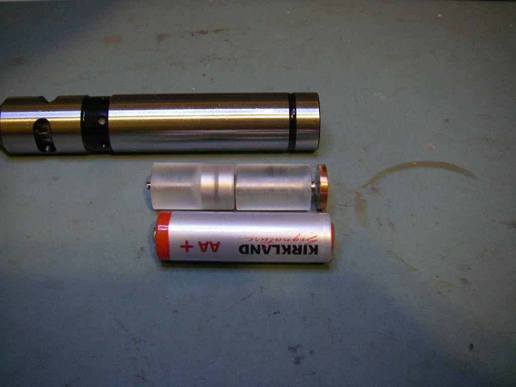

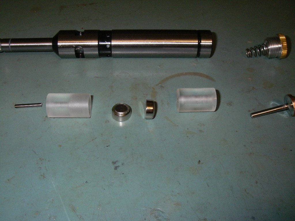

Well, I made a battery holder about the size of a AA and put two 357 batteries in it. The electronic finder draws 60mA which is a lot for these but they are super cheap at the dollar store and Princess Auto.
The edge finder works a treat, much easier than the mechanical ones. I'm glad I got it.
The 20mm collet I got isn't bored the length of the slits so the finder sticks out pretty far. Maybe I'll bore it out someday but it's Ok for now.
Thanks to everyone for the advice.
