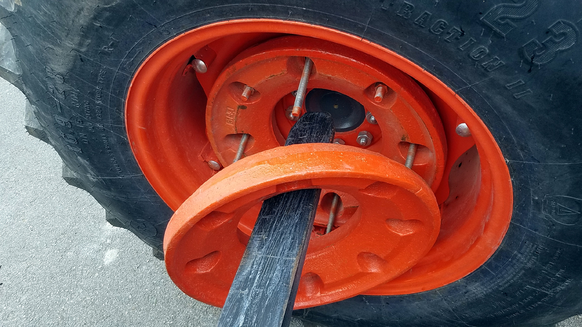

Just picked some rear weights. Only putting one 160 lb. Weight per side. My dealer only gave 2 carriage bolts for each wheel. Doesn't seem right. Anybody else installed these? Patrick.

I have three sets of weights per side on my M6060 and each weight uses four bolts. The photo shows the second weight going on. You can see the four bolts securing the first weight to the rim, and the longer bolts to secure the second weight to the first weight. The last weight goes on in similar manner.

Thanks for your help. This helped. My tractor is a m9960. Weights are little different hole pattern but same principle.
