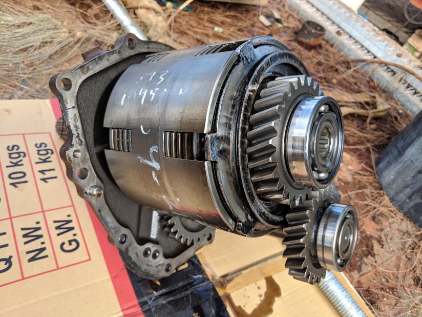

Good Morning Friends! So i have a M9540 which was split for some work on the clutch pack. So now problem is that i cant get the clutch pack to sit in the remaining quarter inch. It sit on the two screw pertruding out of the transmission case. But regardless of what i have tired i haven't been able to get the pack in the last quarter inch.
Any advise?

Not sure it matters but the two meshing gears In the picture look to be about 1/4" out of plane. Check the reassembly order of everything against WSM cut-aways or parts book drawings. Something isn't where it was when it came out ? Good luck, Dick B
28,760
5,154
More on with what eserv, and rbargeron said:
Is this picture a picture of what it looked like when you pulled it out before repairing it?
How about a picture of the after the repair?
Is the lower shuttle gear on the inside the 26 tooth gear and the outside side the 24 tooth gear, as the shaft and bearings are different on each end. ;)

The picture of the clutch pack is after we finish the repair.
Unfortunately I did not take a picture of the part before we disassembled it.
I will look at the gear count the first thing when I get to the shop.
28,760
5,154
Something ain't right, If that's a picture of the after, you have an serious issue.
The rear clutch pack disks are not in place and the snap ring is not in the slot it's wedged behind the gear. :eek:

the photo that was uploaded was of the broken PTO clutch pack my mistake =-O
I was able to put the clutch pack in by sticking my hand below the plate and slowly turning the gear while pushing the plate in simultaneously.

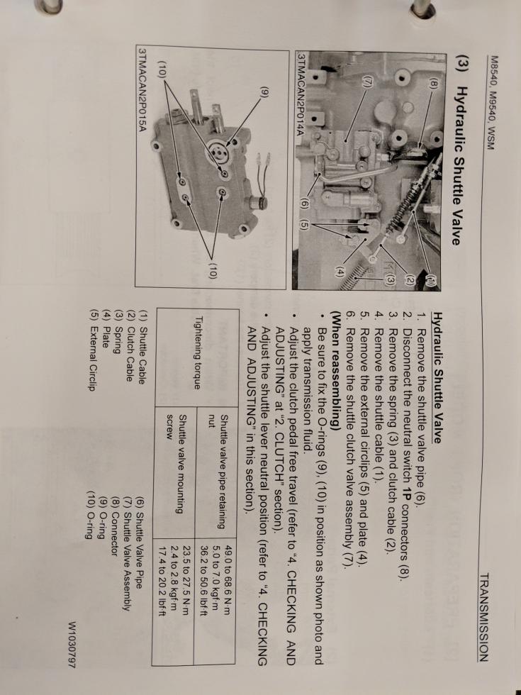

You really need to get the WSM (aka Service manual), as it will tell you how to test the shuttle valve to see if it's working properly. ;)

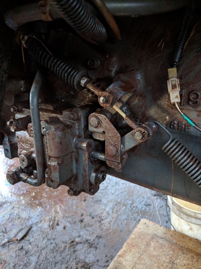

So in the service manual I found a hydraulic shuttle valve modulation unit. I noticed that there are two wires coming out of this unit. is there a way to use a multimeter to check if this is valve is functioning correctly electronically?
28,760
5,154
I'm pretty sure that not a modulation valve, it says it's a neutral safety switch.
seineil56k
m9540, m8540, mx5100
Nov 24, 2018
Ewa Beach, Hi, Oahu
Wolfman, I removed the Switch and tested the unit with a multimeter for continuity, pressing and slowly releasing the switch. Tested this multiple time to ensure that it was done correctly and wasnt able to get any type of positive continuity test.
What does this switch do related to forward and reserve on the shuttle shifter?
28,760
5,154
If it's the neutral safety switch, which I'm sure it is, it has nothing to do with forward or reverse, operations, just that starting of it. ;)
