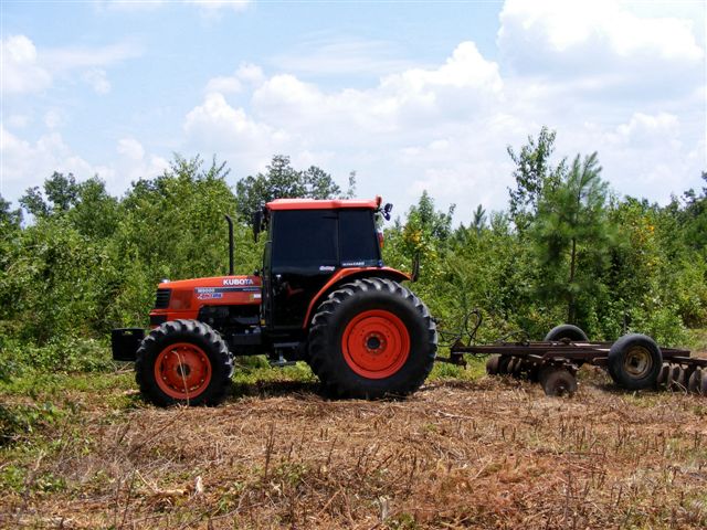

I cut some food plot up this past year for a friend and used a 8 or 9ft IH disc behind my 9000. I couldn't even tell it was behind the tractor. I ended up after I added rear remotes to my L 3000 (32 hp) pulling the same disc in garden spots. I had to run in 4wd but it handled it fine. I have a 16' IH disc that I used to pull with a 100 hp IH 2wd but have never pulled it with my 9000. I feel sure it has plenty of hp for it but not sure about the traction. The old IH tractor even though 2wd weighed 11,000 lbs and the bota only weighs 6700. I can tell you that a 70 hp IH wouldn't pull this disc without holding up on it with the wheels. It didn't have enough hp for it.

unless you are trying to pull a 12'rhome offset disc with 36" blades or a 10yard dirt scraper you should have no problem pulling anything within reason.ive got a 15'batwing that i can kill the engine with on my 9540 let it down real low to the ground in dead bahaia grass.on the same note i have pulled a 20'modern brand batwing using good judgement with no problem.a good rule of thumb on an offset disc is 10hp per foot(width)of disc.this rule was used when tractors were rated at the pto.yours is 84 and if that is yours in the photo i noticed it was 4wd so you should be able to pull a 10' offset disc with no problem because the 4wd gives you about 20% pull than a 2wd of the same hp.the rhome disc i metioned belongs to my neighbor who pulls it with a m125x 4wd pulls it ok but you think you have a leak in your fuel tank,because it will suck some fuel.
