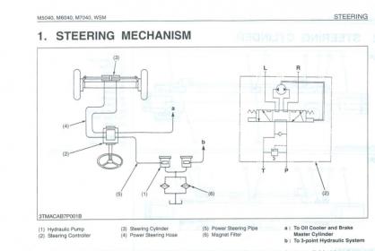

The power steering schematic in my M7040 WSM doesn't mention pto clutch or hyd shuttle but does show separate pump(key B) for 3 pt. Maybe higher HP tractors are different from my M7040
