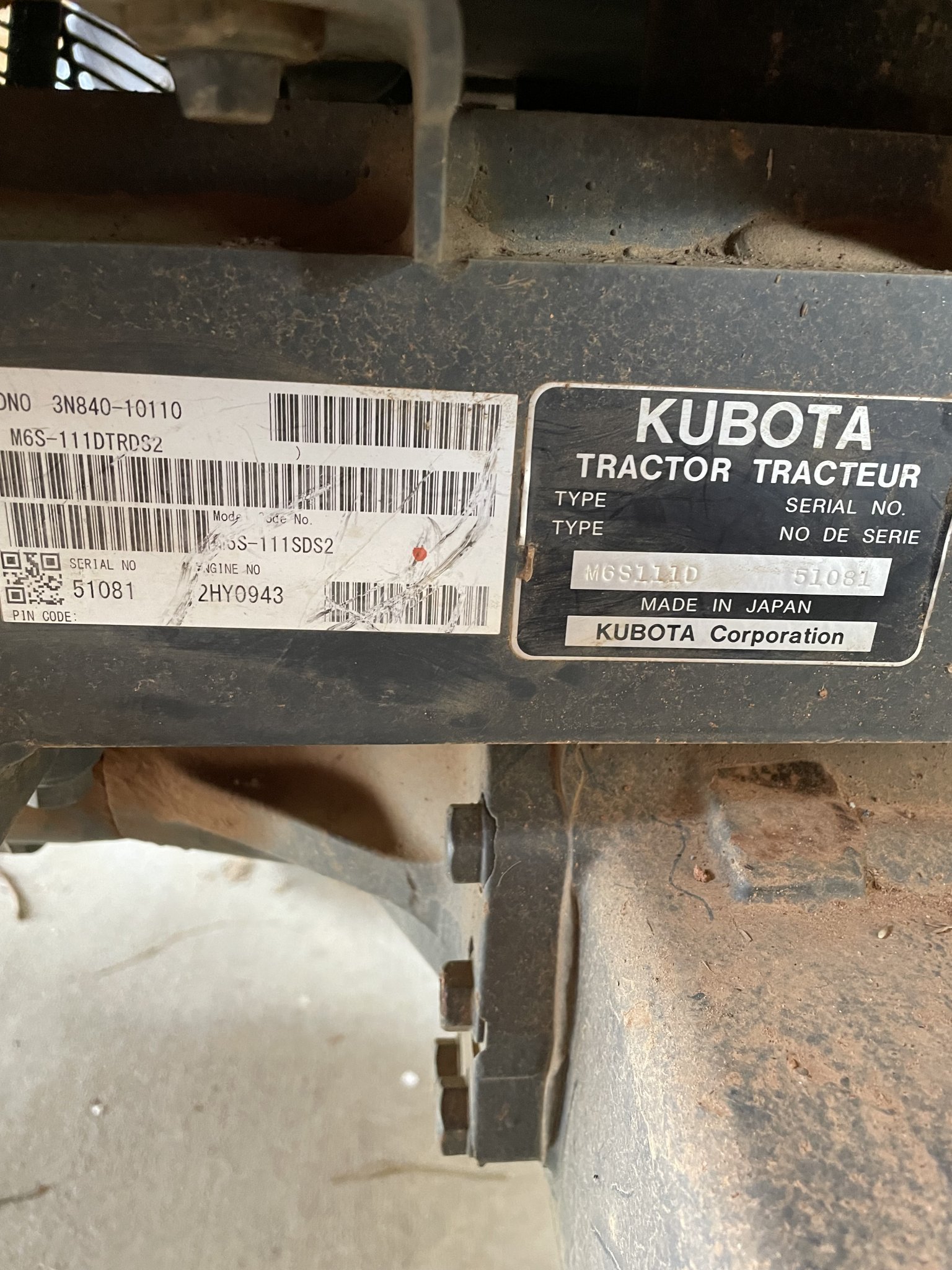

Thanks for the reply, i have done that and there is no reference to it.
Give me the serial number so I can look at the proper WSM and see if I can find anything to help you out.
