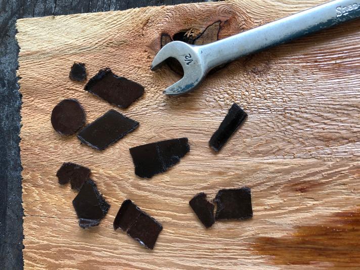

First thing I did was to pull the new filter I put on when I did the engine overhaul. On the inlet holes of the filter and in the line feeding the filter I found what looks to be old gasket material. All this paper over the filter inlet and in the line feeding the filter housing. Cleaned out what I could and replaced the filter.
8 seconds from the ground to the max lift. That's with me counting. The spec calls for 6.4 seconds. Close enough for a 33 year old machine.

Hello
What you found is the lining from your brakes. I would not let this go to long. What will happen is you will soon have metal to metal on your brakes. Then you will have a mess. I have repaired many of the older Kubota's were this was not taken care of. You end up with fine metal in the whole system. It is not to bad of a job now. You need to remove the axles , and replace the brake disc.

Lance, Thank you for taking the time to tell me what I found. Dead on!
Is this normal for the casting to look like it was drilled for clearance?
The lining was gone. About 1 3/4 of the 6 surfaces were loose and gone.

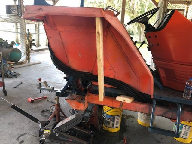

The board was to lift the fender and push the loader frame down.
