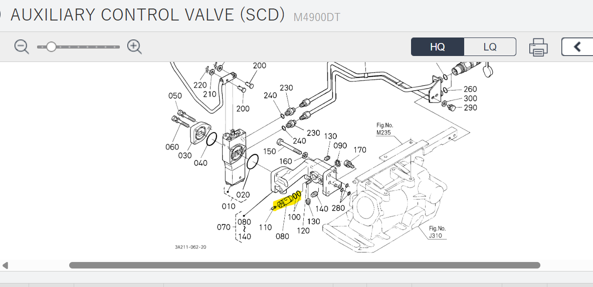

I researched a little bit and figured out there are "two hydraulic systems", but not sure how that works yet. Steering and PTO work fine, I know those are on the priority system. From diagrams it looks like the flow goes from the pump into the 3 point case, but I haven't gotten any further than that. I also check the 3 point control linkage and everything is connected. I also tried many positions of the 3 point resulting in no change.
Suggestions? Where do these systems split the primary vs secondary parts?

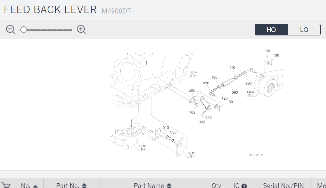

It's very possible the three point lever / feedback are mal adjusted and causing the system to go into relief.
You need to set the three point in a middle position and see if that helps.
If it does then get the WSM (aka service manual) and adjust the feedback linkage.

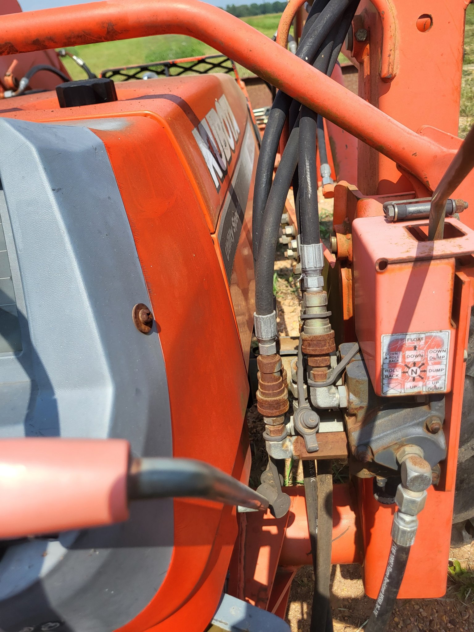

There is a selector valve and if that is in the wrong position the loader and the remotes will quit working but the three point and steering will not be affected.
It would be rather odd if it moved suddenly.

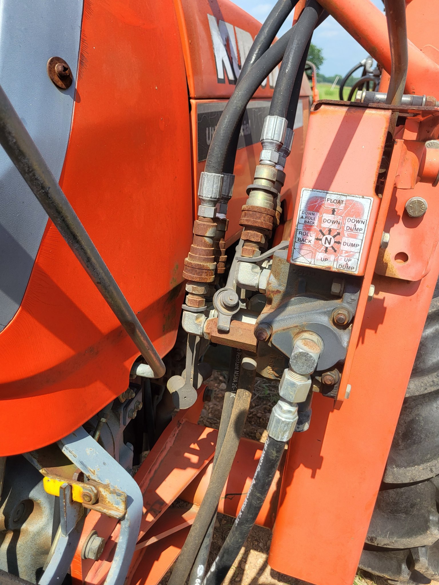

Are there any Quick Disconnects on the loader lines that feed the loader valve?
Does the loader valve move in every direction normally?
Does it have a third function valve?
Does it have more then one remote on the rear?
Are you sure the feed back linkage is intact?

No 3rd function. Loader valve "feels" normal in all positions. Unsure about the other questions. I'll post pictures of the valve.

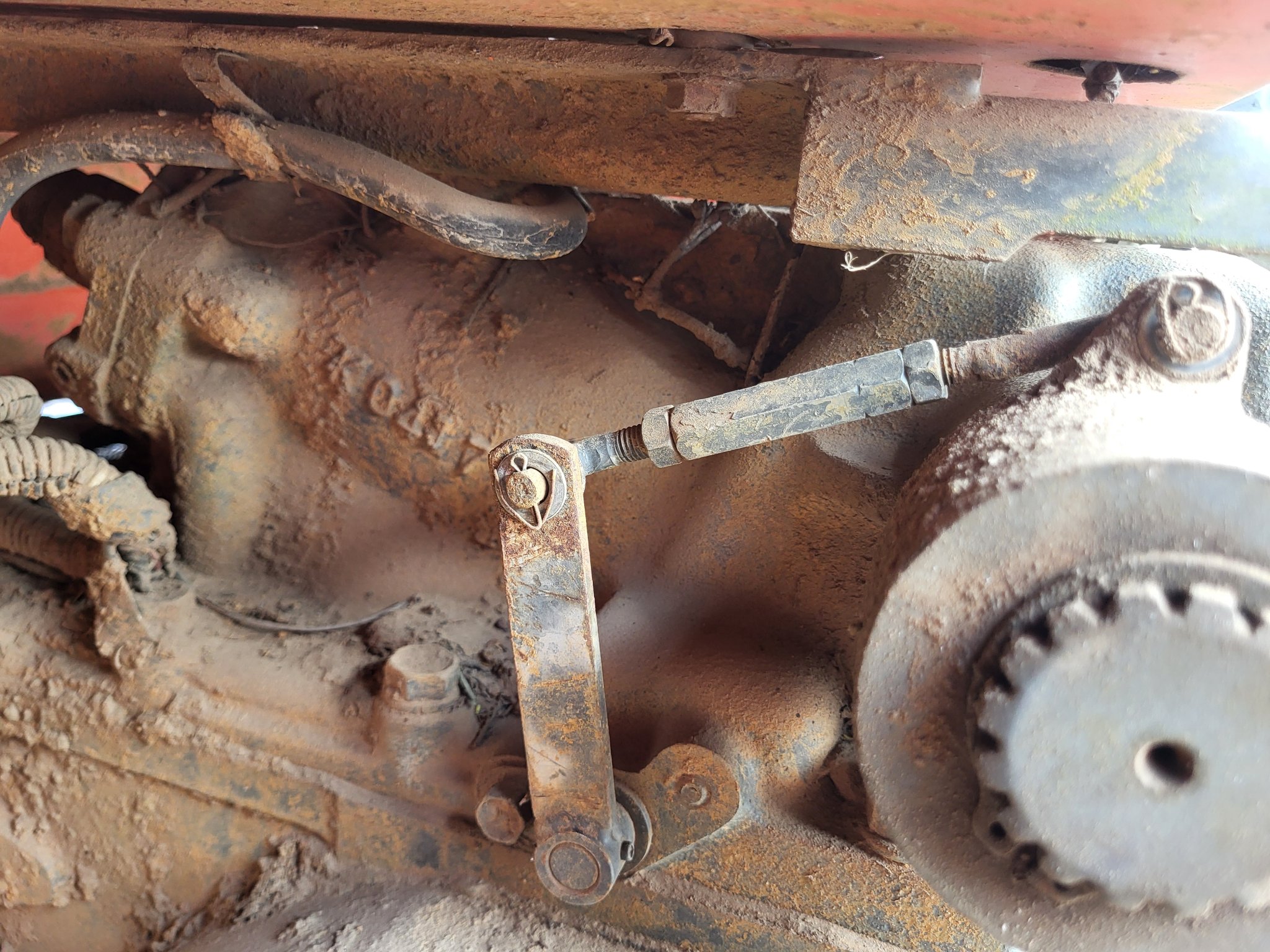

3pt control looks good to me.
