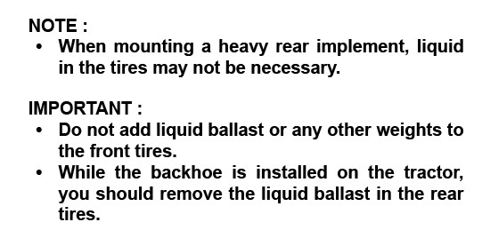

I think you are referring to the manual page that recommends removing the ballast if using a backhoe.
Attached is from page 23 of the LA535 loader operations manual.
Now the LX2610 Workshop manual says for the Cab version of the tractor to remove the ballast when the loader is Installed It does not even mention if used just that it's installed.
Personally I would load the tires and forget about it. The weight of the ballast is carried within the tire itself. It acts as "un-sprung" weight if comparing to a auto. So the main forces acting on the tractor is the extra rotational mass, Not really a concern with such a low speed item as a tractor.
As to the axle stress it conceivably could add more stress in shear when you lift enough to pick up the rear tires but again not anything I would worry about. The load capacity of the tires might be an issue with both loader and cab to the point that the air space in the tire is diminished but again I would not lose sleep over it...
