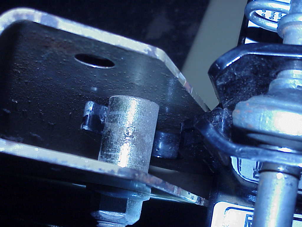

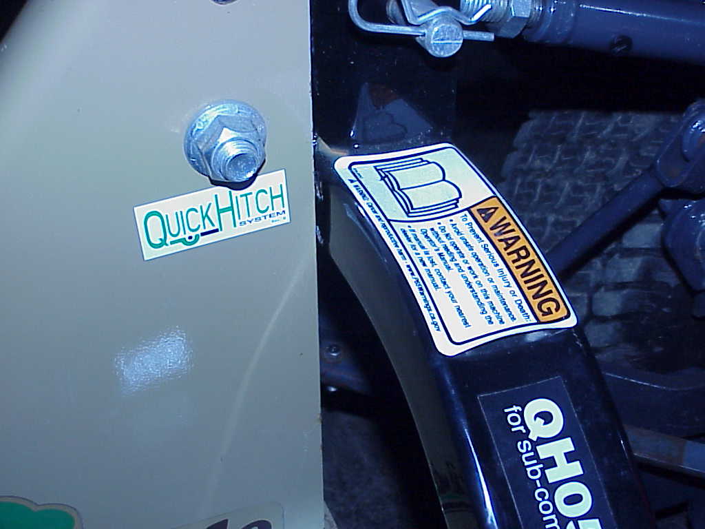

Got it home and off the trailer, and found that it would not fit onto my QH05 hitch. After analyzing the problem I found that the top pin is located too far in for the hook on the quick hitch to grab, and it also looks like the quick hitch spacer located at the top of the rake is too large of a diameter to allow the hook to grab it. One of the reasons for buying this rake is that it is labeled as Quick Hitch compatible. Has anyone else had a similar problem with Land Pride attachments, not fitting Land Pride quick hitches?

Sadly the QH05 was / is a poor design
The QH10 and other similar built ones are much more user friendly.
You might consider getting one of those.
Heck my $79 Horbor fright one works like a charm. 😁

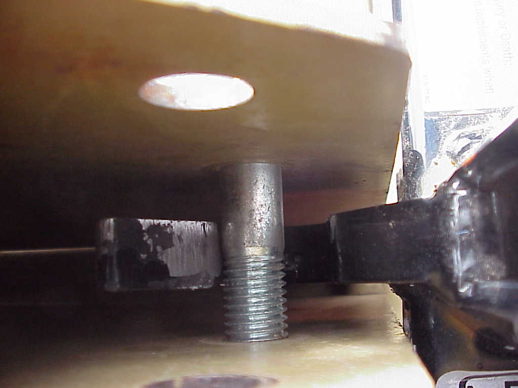

I don't recall where I read about this problem, but I am pretty sure that I have heard of this problem before and the remedy was to replace the "hook" part with a "longer/deeper/bigger" one.
But from your picture I can't tell if it bolts on, or it is welded on?

That's the issue, on a QA05 The hook is welded in place.
The QA10 has a moveable hook.
It was the generic QH that have a short hook issue.

I spoke to Landpride this morning and they asked for more pictures. Sent additional pictures and haven't heard anything from them since. I did resolve the problem by removing the large diameter spacer and it now hooks onto the bolt that the spacer was held on with. While I am still not happy about this, at least I can start using the rake. I will give them a couple of days to see what they come up with for a resolution to the problem, but I don't see any way that this can be corrected without replacing the hitch itself.
