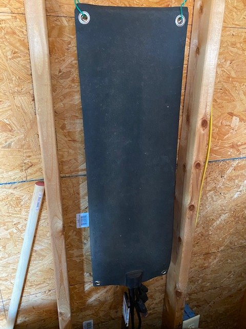

I only did the touch test. Doesn’t smatter now…I have the new unit which will be installed after the blower comes off in the spring. Meanwhile, I’m going to make use of a heater mat I used to use for my porch steps (one of a 4 piece set)
Just going to drape it over the engine and use it like a block heater in the cold weather. Some heat in the engine compartment is better than none.
