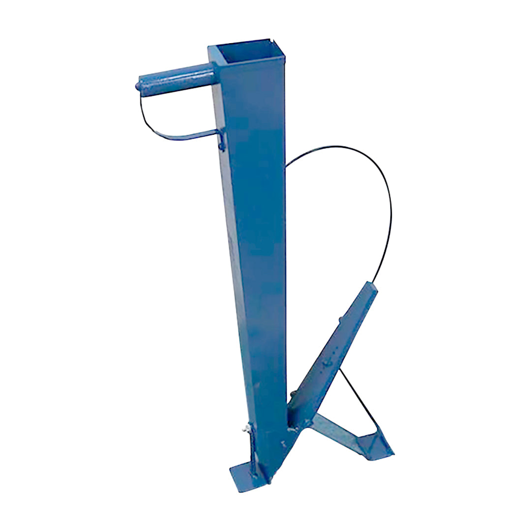

What's the difference between these two hand planters? ....other than $414 bucks.
Nothing...
