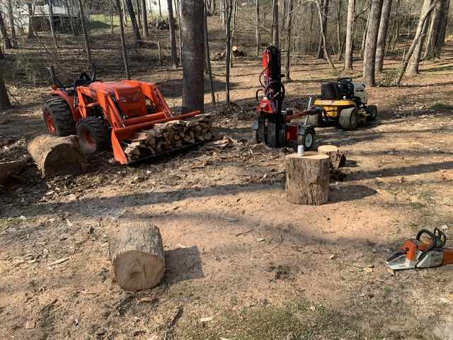

As you age, you look for ways to avoid bending over. For me it's splitting into FEL bucket and using tractor as a motorized wheel barrow.

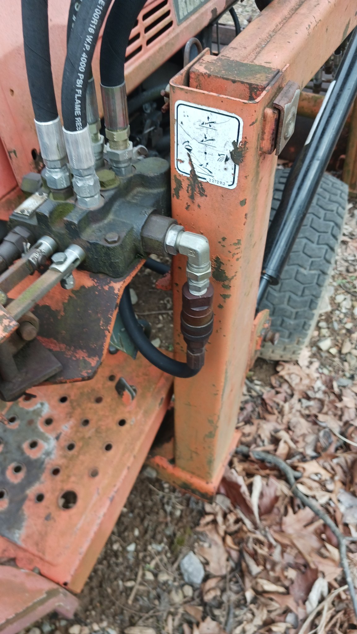

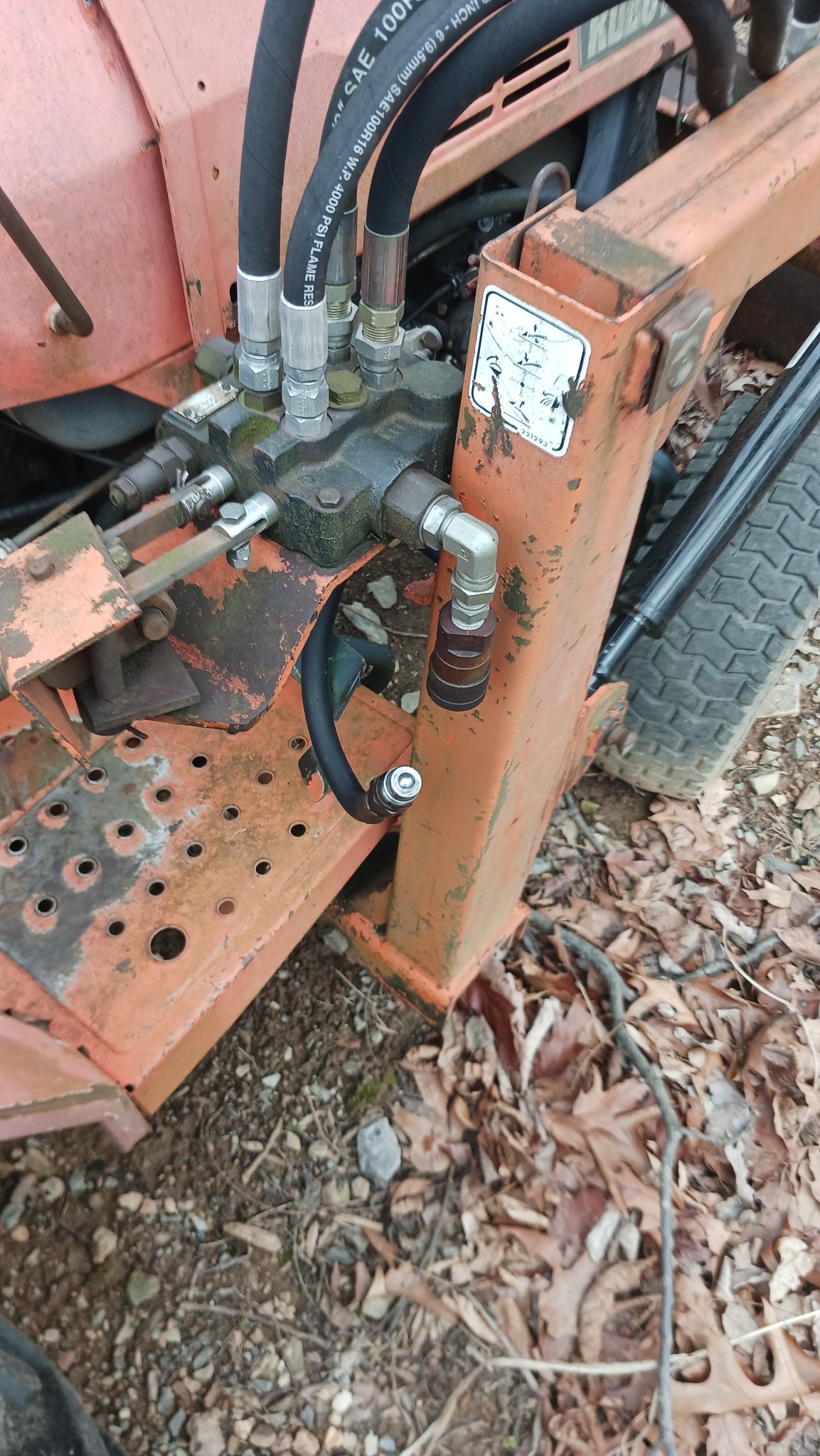

A picture is worth a bunch of cell phone mangled words. Here is my old log splitter hookup - power beyond hose on loader valve. Just be sure to turn the engine off when connecting and disconnecting it.

You'd be better in all ways by getting a self-propelled log splitter. Move logs with your tractor to the splitter. The log splitter can be moved by your tractor, truck or ATV. And park it. Fire it up as needed. Move logs with your tractor. Your tractor will not be frozen in place powering the splitter.

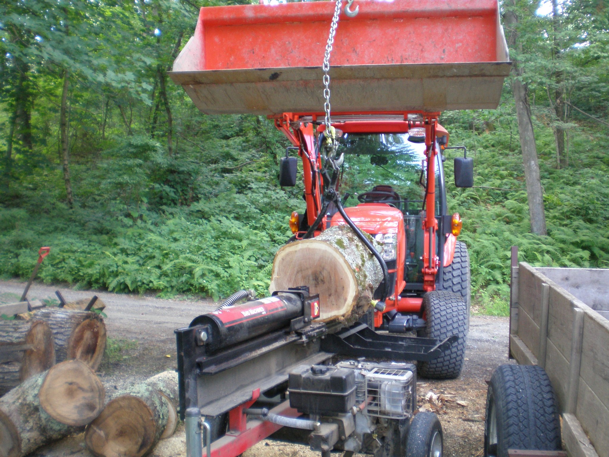

There is so much more you could use the tractor for than as a log splitter! With the sentimental value maybe you could convert it into a stand alone with a motor and hydraulics, the tractor could bring over the logs for splitting, pull a trailer to move the split logs, etc. I use it to lift heavy logs onto the beam to split. I just couldn't sacrifice the use of the tractor to use it as a splitter.

Upgrade your father's log splitter to be a 'standalone'. That way you'll have his splitter and 'smile from above' when he see you've improved his work !
