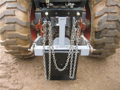

This is so simple,,looks like it would work well too
http://www.northerntool.com/shop/tools/product_200335943_200335943

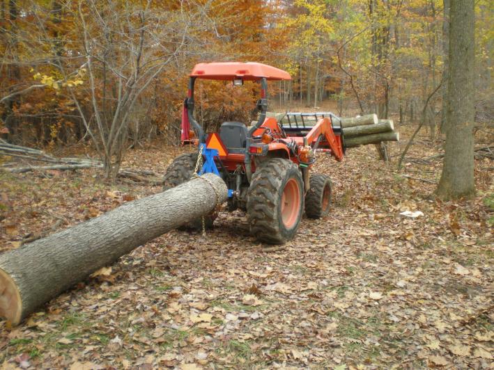

Hello Skeets:
Just like what you're looking at from Northern Tool, I've been using a simple hitch and chain setup but much less expensive. I think this one cost about $50. Works fine.
Check it out at:
www.redlandhill.com/index.html
I've got the handihitch and since I had the ball and hooks, just the steel frame was fairly cheap. Attached to the 3-pt hitch at the rear of my B7800, I've been able to lift and drag some really big logs. I also have a FEL and the weight of that helps keep the front wheels on the ground. Hope you have a ROPs too - more than handy, it's a lifesaver.

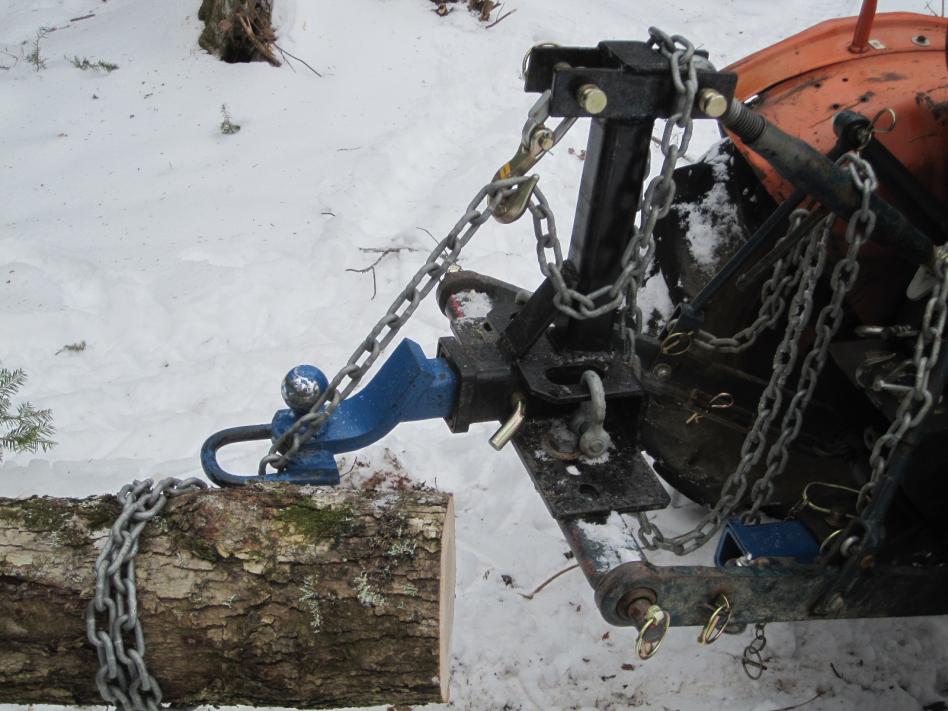

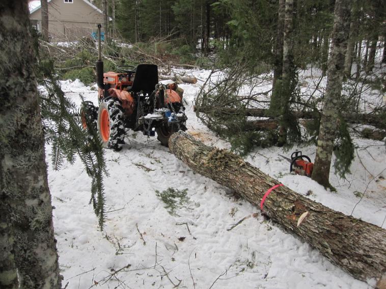

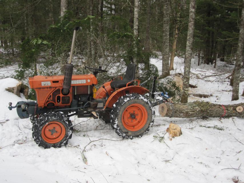

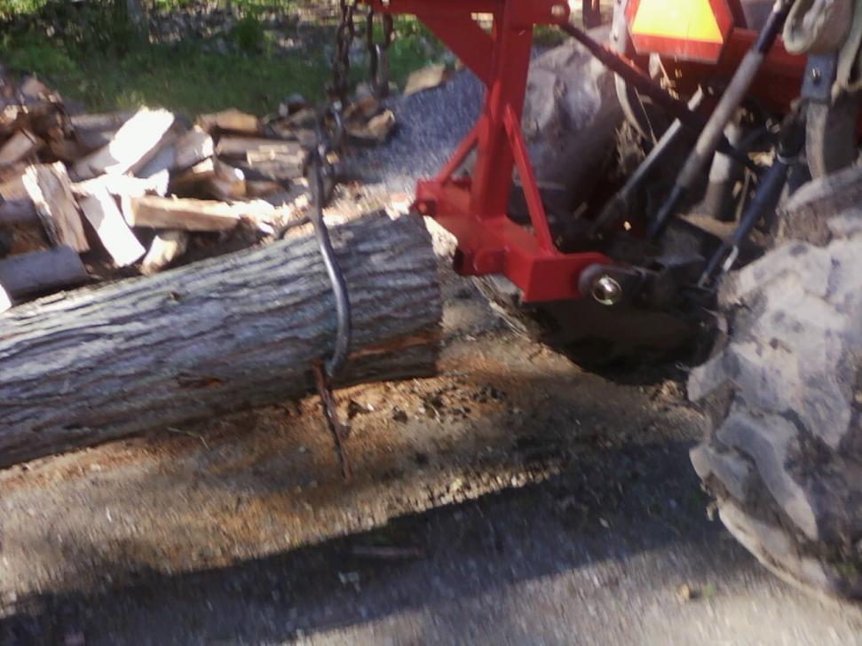

Built one for my 1980 b7100 4wd (replaced last winter with a 2012 b2320) & it worked great, sold it with the tractor but built another for new Kubota. Used it to clear a building lot for a guy, cut & skidded out 10 cord of maple for firewood. Never once did it attempt to lift the front of the tractor. Ground was frozen with 6 or 8 inches of snow & that little tractor could go anywhere & hardly had to cut paths to skid on. Posted it here before but here are a couple of pics. Safety police need not respond.

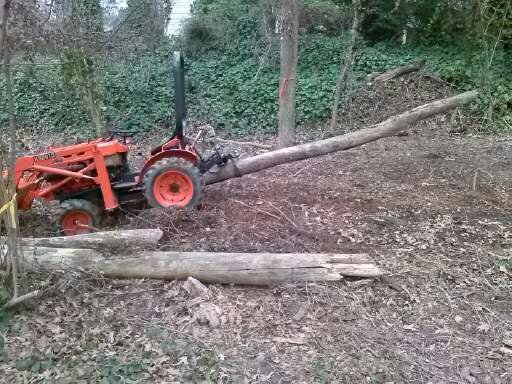

I make one for the compact tractor, trying to attach a picture but no luck.
