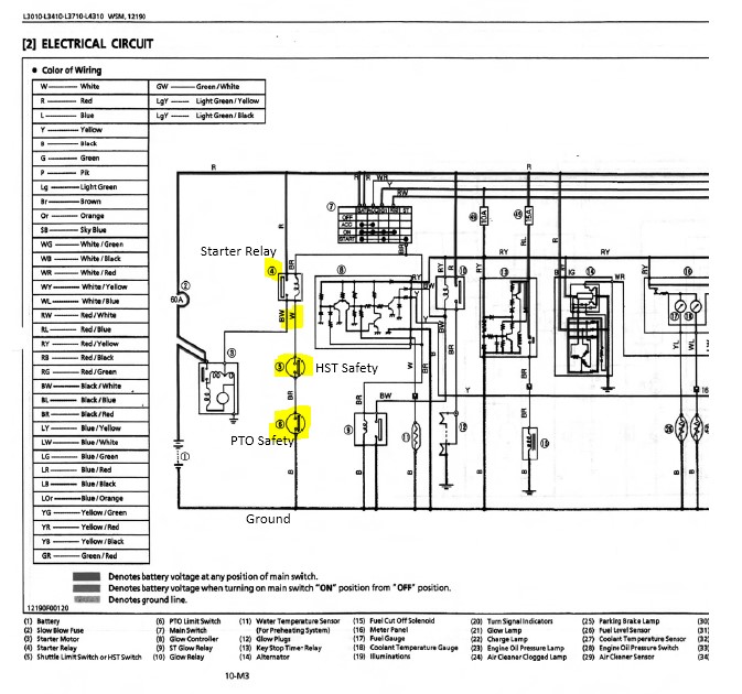

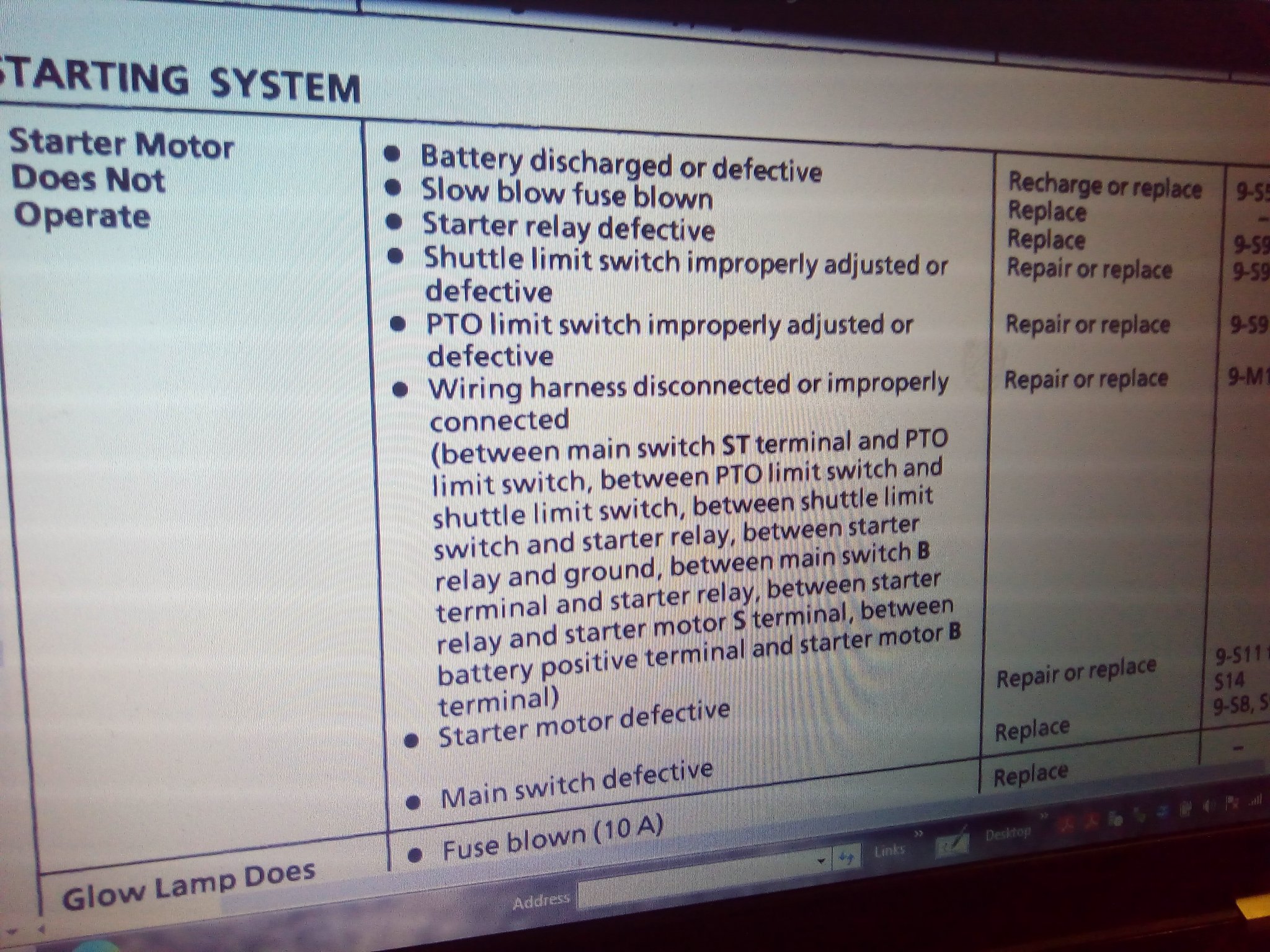

I am trying to bring back my L3010 that was damaged by fire in transport. The fire damaged the left rear of tractor. I have most things squared away but it does not start (or even turn over). I did the obvious (battery and ground cable cleaned). I had a new key switch on hand and replaced it. My next step is to start tracing wirers. I am starting with the safety switches. My plan is to bypass the switches to see if if runs before I spend money on parts. The WSM wiring diagam shows only two swithes--PTO and HST safety switches. I located the PTO safety switch. I am trying to locate the SWITCH, SAFETY H - TA240-53900. I have both the WSM and the diagrams from the parts site and both are pretty useless for pointing out where the "HST Switch" is located. Does anyone have a suggestion?

The wiring diagram for the cab (that I do not have) in the WSM is more helpful. It shows the wire colors. It looks like I can ground the white wire from the starter relay to bypass the two safety switches. I'll try that this when I have some time to test it out before replacing the switches. LOL-of course I have to first find the HST switch. Any hint as to where the HST safety switch is located is greatly appreciated.

I have the original printed one from Kubota that I purchased when I bought the tractor. The image posted above is from the online version available from kubotabooks.
There is nothing near the pedal that I can see. Looking at videos for later models, it looks like there is an externison of the linkage that presses the switch. I think it could be behind a metal "bell housing" at the base of the center column, bolted to the floor. I'll try to separate that if grounding the starter relay works. I hestitate doing that because I may need to separate the clutch and brake pedal linkages to pull that fully out. It's a lot easier to get to the starter relay to test if providing an artifical ground to it (bypassing the safety switches) allows starting.
