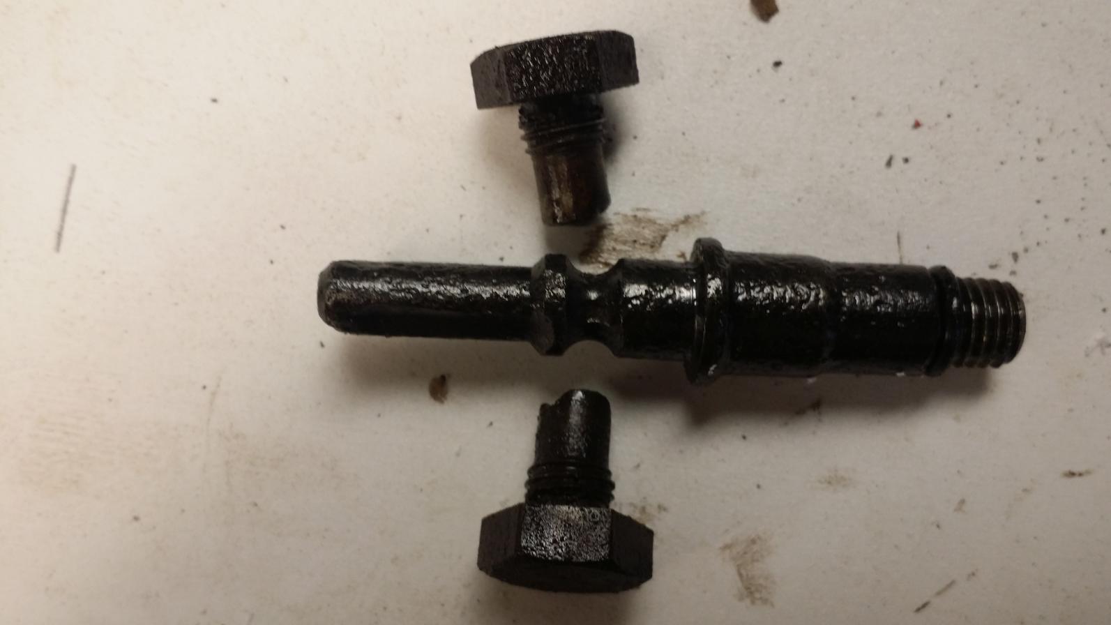

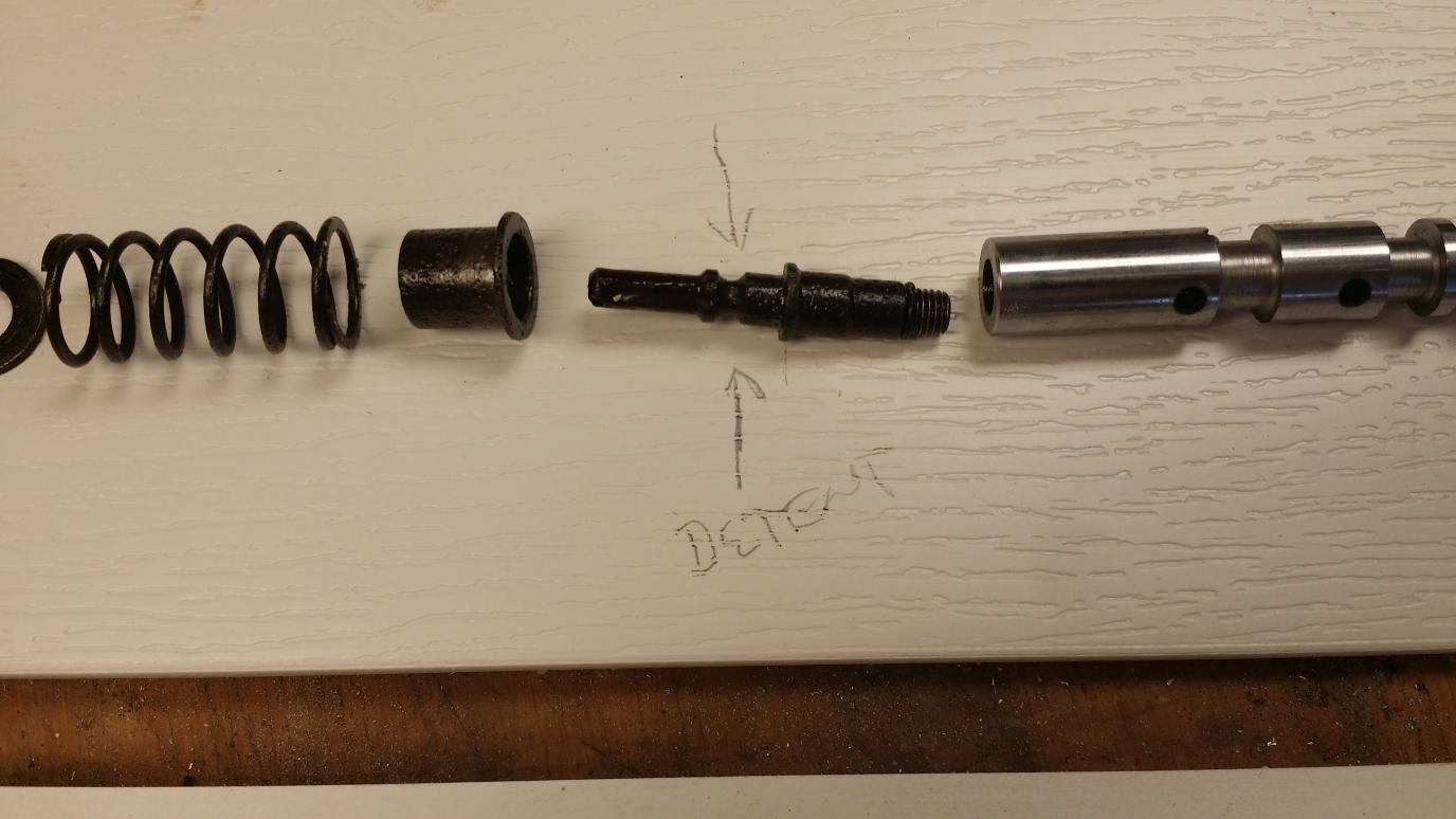

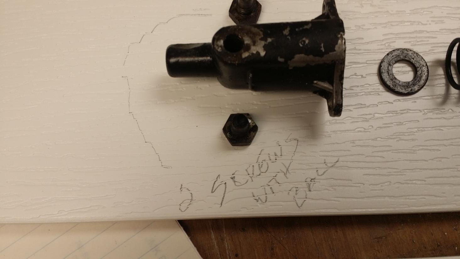

On my l185 the loader valve is leaking on the raise lower valve. So I slid the spool valve out to replace the o-rings on each end in the housing. Now my bucket never floated and now I know why. At the end of the valve there is a rod that screws into the valve with a spring, it has the cover that goes over it. On the cover there are 2 bolts that screw into it, the bolts have small ball bearing in them. One is shot the other is worn out. Now the shaft has a groove that the balls lock into to hold it in the float position. I have been looking for those parts, but have run into a dead end. Seems Victor was sold then Dukes took over the company then Sauer Dan Foss now QCC maybe not in that order but you get the point. So has anyone had luck finding parts for these? My valve is a victor or dukes dv23fats004. I have called many hydraulic shops around and if your not buying a new one they can't really be bothered.

A new valve will cost around $300 from various suppliers.
Or, you could get a couple of bolts with the same thread as your wasted ones, have a machine shop cut a divot on the end of them. Then get a couple of steel ball bearings and put it back together (after a serious cleanup).

Wire brush/ sand paper the **** out of the spindle, put in new balls, pack it with grease and keep it out of the weather.
See how it goes....

I wire wheeled the rod before I took the pic , its not in good shape. Unfortunately there is more to the balls than dropping in new ones, they are part of the bolt that goes in. Bolt had a hole drilled in the end,spring inserted then a ball then swedged in somehow. Making a new rod with a bolt will not work , if I still had my job at united technology I could make a new piece with no trouble, but I dont. And other suggestions are welcome.

Yea, I am leaning in that direction but you cant blame a guy for trying to fix the old one. So i put it back together with new o-rings, used a hook and chain to hold it in the float position for now. Looking at a single lever 2 spool valve with the float position.
