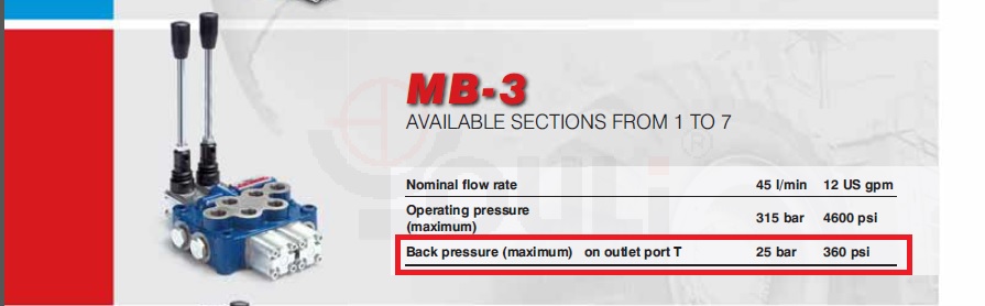

Your plan to divert the tank hose to the 3 pt hitch is unwise. Typically a valve's tank port will not be designed to tolerate the full system pressure which is what will happen when the 3 pt is raised. Tank ports are normally rated for 500 psi which is why power beyond exists. The MB-3 valve is only rated for 360 psi on the T port.

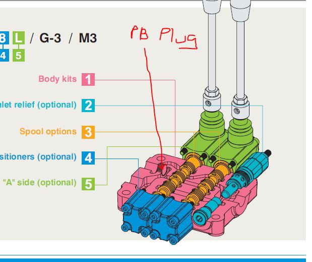

Pull off the line and fitting that goes to C (PB) look inside for a HEX plug, if it's not there then that's your problem.

Wolfman, I pulled those fittings, and can see a hex in there. given the brilliant schematic you provided, I don't see how a plug there would actually help my cause any though - so I'm just going to bow to your greater experience with these things..

The hex plug (power beyond plug) makes the valve a power beyond valve, otherwise the Carry over (power beyond port) and the Tank (return) port are connected.
